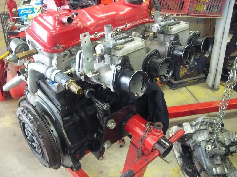

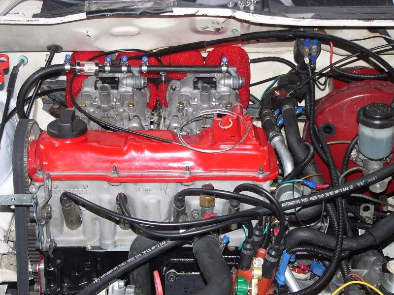

      Mine's hanging off a T adaptor off the head.
      (Don't be fooled by the MK1 body and the MK3 block, that's a MK2 head in there )

        Very tidy looking block there pete!!
