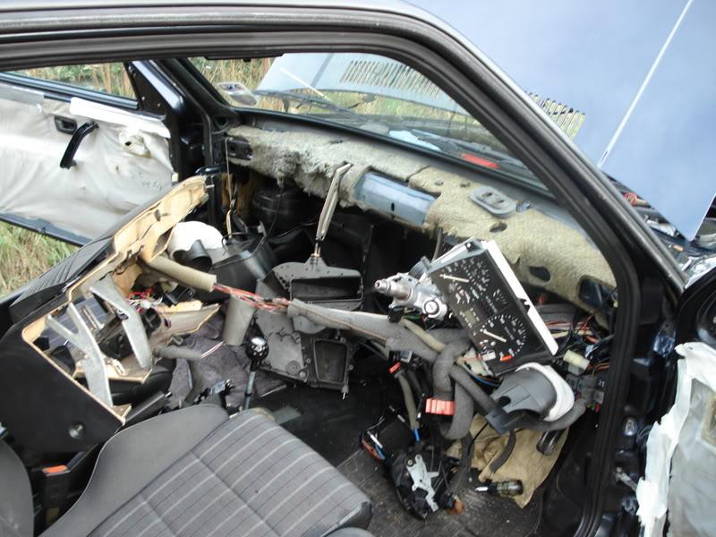

                I fitted a brand new mk3 one so now i can ditch the valves, alltough i have not got round to it yet? It was far easier to remove the dash but i also .
                removed the front seats as well as it made so much more room to work around. (well i did but the picture below shows differently- i think i got the ass then removed the drivers seat)
                Some people have said you can just remove the lower sections but after doing mine i was glad i removed the whole dash. And I dont have air con?
                dash comming out and you can see the box the matrix is housed in in the middle of the picture.

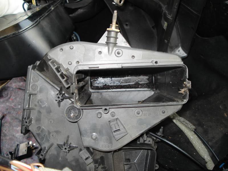

                close up of said box this has the nasty clips you have un-clip all the way round the air box unit to the air fan.
