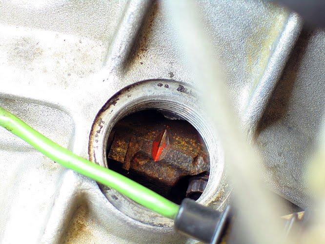

                    Once you've done all that the timing should be pretty close, the next step is to set the dizzy advance. You MUST set the timing to the factory spec, 6 deg BTDC, there is no need to set any further advance as this is done automatically by the ECU. If you don't set it to factory spec, you'll likely REDUCE performance & MPG as the ECU cannot adjust the timing properly.
                    Heres a nice pic of the marks you're looking for, shamelessly stolen from the vortex, link found by the legendary 'TSC' from ClubGTI
                    You can see the arrow on the gearbox casing, the large notch with a bit of red paint is the 6degree BTDC mark, and the small round 'dent' to the right is the TDC timing mark. Before you start I'd highlight both marks with tippex to make them more visible
