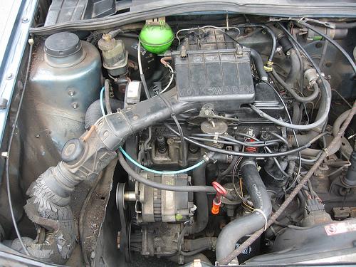

    Just wondering if it was possible to replace the nasty plastic air filter, like this one;
    with a 'hat' type air filter, like this;
    without having to buy a new carb?
    What are the benefits of a 'hat' type filter?

    1. yes, most probably. the bottom of those style of filters are interchangeable between different style of carbs, so you just have to get the base that suits the carb that you have.
    2. probably not much performance wise, although does make the engine bay cleaner, and might increase airflow a little.
      It would mainly be for looks. A 1.6 carby isn't exactly a performance engine and the standard air filter assembly is just such an ugly bugger.

            one nice thing about hte stock setup is that you can easily rig it to get cold air from the front, whereas the aftermarket carb-top filters are so poorly positioned.

                        unless there's something wrong with the standard set up, there's not much reason to change. get rid of that pre-heater stuff, that comes off the exhaust though, and get some flexi pipe to extend down below chassis rail to get some nice fresh air.

                            Nothing wrong with a small filter like that second pic
                            I have one on my stock 1.6 and i feel it makes a better throttle responce, and revs more freely.
                            It was on when i bought it, but i did try the stock box. and it felt sluggish was quiet and seemed to struggle to get 5k . where as with the small filter i can get to 6k easy, not that its up there often. but the induction noise is cool,
                            I say if you get one cheap, go for it
