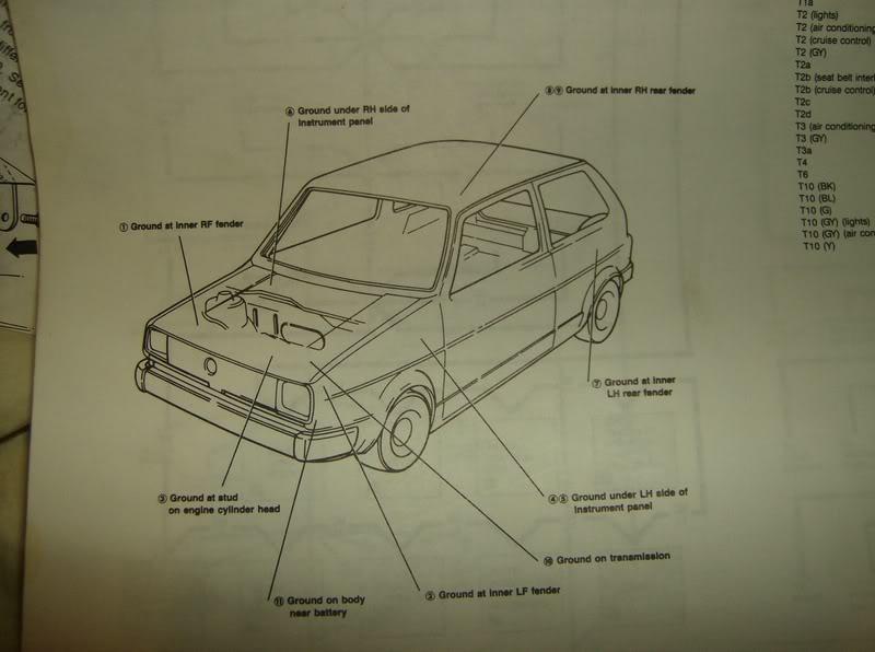

    There will be an earth that runs to the block, head and possibley gear box ( i have on mine but not sure if that was stock) there is also a main fuse box earth and other assiocated earths all crimped togther going into the earth terminal i assume.
    90 GTI Mk2 1.8t soon to be with GT28rs
      Also one up in the raintray to earth the ecu. That one is important and can be redone to good effect.
        i've been meaning to redo some of my earths. what gauge cable should i use?
        the MFA oil temp reading jumps around when the electrics are switched on and off, thinking it's the ecu or fuse box earth.
        edit: just found this

          Cheers for the diagram!
