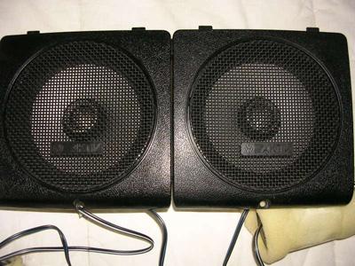

          cool project. but i dont understand why your doing all this and only making it fit a 5 1/4" speaker, make it at least 6.5". some cars came with a speaker in that position, which is 5 1/4", heres a pic (dont know if you've seen them or not).

            ah yer the activ system
            well if u stick in a 6 incher they ruin the lines of the pocket i think, so im going to get both sizes of spacer and see which is what and what suits - ideally i want
