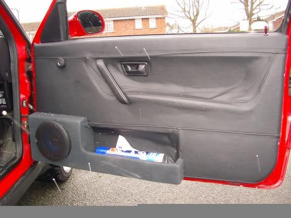

      this would be a good upgrade. however, it wont be perfect because the door pocket is made of plastic. which isnt the best thing for mounting speakers on because it will rattle and it isnt real strong. your also limited to a 5-1/4" which wont have much bass. the step up from there would be to fit some door pods, which is what i've done. my splits are 6.5". ill get a picture if you like.

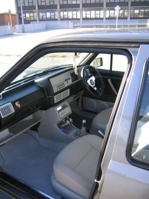

                  Speaker Grilles like that could be got from ebay.co.uk and would save cutting up your doors.

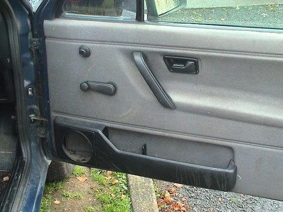

                    Hmmm... door pods you say? Do they look like this?
                    And the tweeters go in the old speaker spots in the dash without any drama?
                      Those pods wouldnt be hard to make and if you took the doortrim off, you could use the existing holes and screws to hold em on. Theyd sound better with a solid unit around em too.
