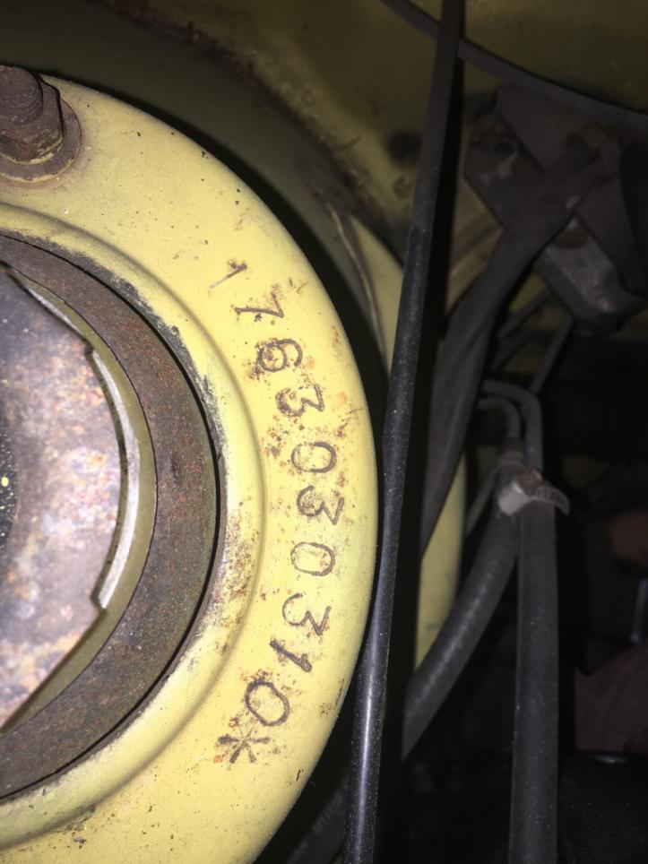

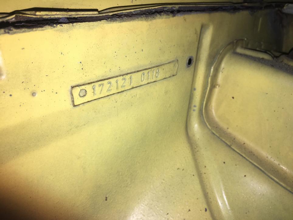

    Trying to find my vin number for mk1 golf. The usual sticker in the boot is gone, the tag under the windshield is gone, and also the vin plate is... you guessed it, gone.
    The only markings I have found are these two
    Which of course don't match so it's left me scratching my head. I know I'm going to need it for the upcoming blue slips/rego/insurance so want to sort it out before it becomes the only thing men not passing [emoji23]
    Anyone can shed any light on this would be greatly appreciated!
    Thanks in advanced!

    This is your VIN number. locations you have been looking are for later produced vehicles.
    This is the part number tag for the complete bodyshell ( 172 - RHD type 17 , Mk1 golf )

      Ooh awesome! Haha was under my *nose* the whole time!
      Thanks Rocco!
