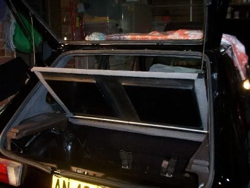

    I have got a very good condition Mk1 parcel shelf and 2 support bracket from Loon a while ago. Now I eventually come to the stage to fit them into my Mk1 project.

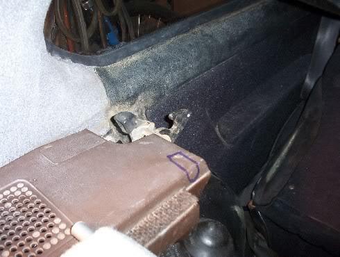

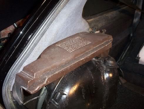

    The support bracket are from later model, they won't fit straight into my 76 Mk1, but after some minor cutting/trimming, they sit perfectly

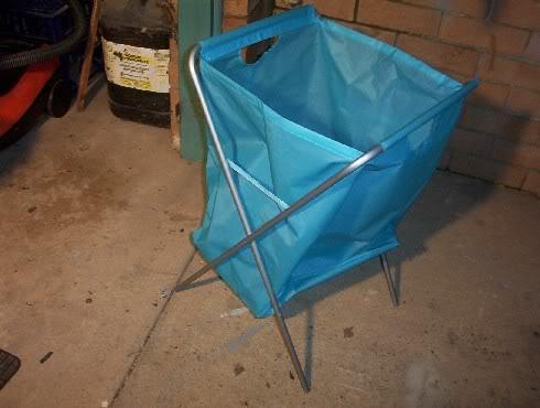

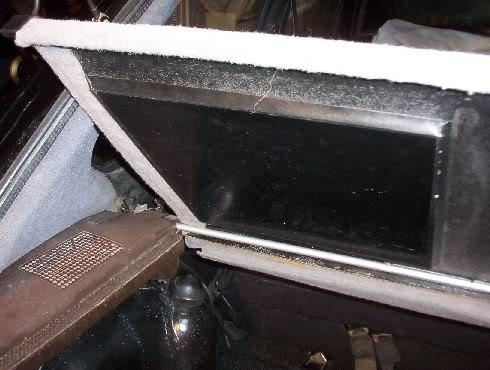

    Fitting the parcel shelf is a bit of problem, unlike later model (Mk2/3/4), the shelf doesn't have the end bar to sit on bracket as pivot. I searched many UK website they all describe the shelf is supposed to be fixed at the back seat with a metal bar and use the carpet as a hinge. Probably UK Mk1 models doesn't have fold down back seat, I don't know how it'll work in aussie Mk1. So I decide to custom make something difference. And I found this Ikea laundry basket in my garage

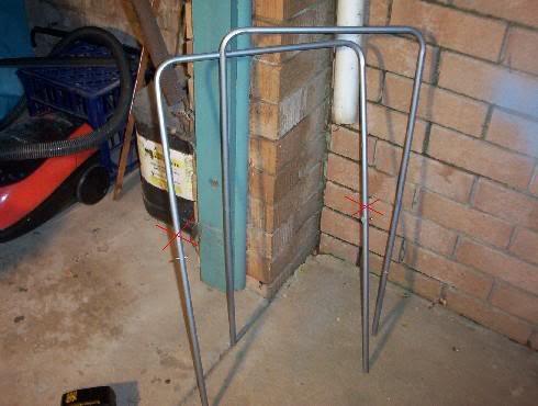

    Quickly wreck it and cut its leg

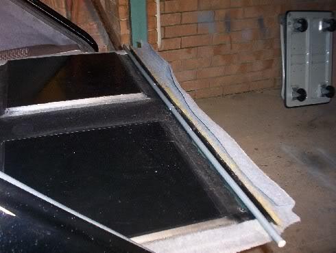

    With some silicon, the parcel shelf has a support bar

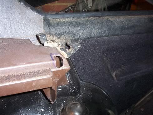

    Mark the position in the support bracket
    and cut it

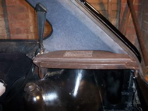

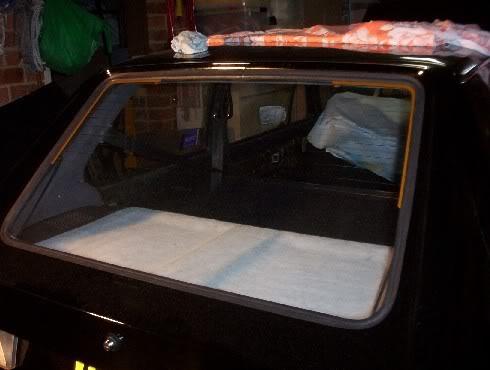

    Perfect Parcel Shelf fitting (except colour)
    Next step to do : Get some black paint to spray the support bracket and dye the carpet black
      looks like a result
