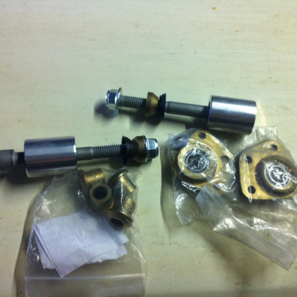

    Obviously the left has Ball joint replacement rose joints
    I would think the centre is the spacer, though the bolt is a fair bit smaller diameter than the centre hole, this is on a 15mm upright

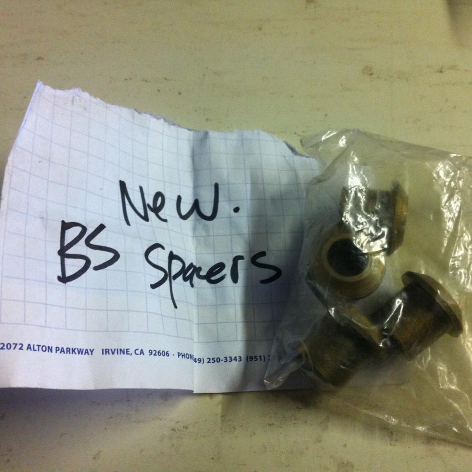

    The left ones have have me a bit confused, hole is smaller than the bolt and outer bigger than the rose joint ID. The paper inside "BS Spacer" not sure what that could be.. BJ would be easy! I tried Google the address on the paper as well, but came up doughnuts
    Anyone know what brand these would be? Or any other information I can garner on their installation

    I think the ball joint bits might be SCCH parts or something similar.
    Southern California Cylinder Heads
    It looks to me like you're missing bits for the ball joints.
    The other parts look like a tie rod flip kit but missing the rose joints.

      I think you may be right with 2 different parts, a tie rod kit, but not a SCCH one
      I can get a pin machined, wouldn't do that myself because it is kind of a critical joint...

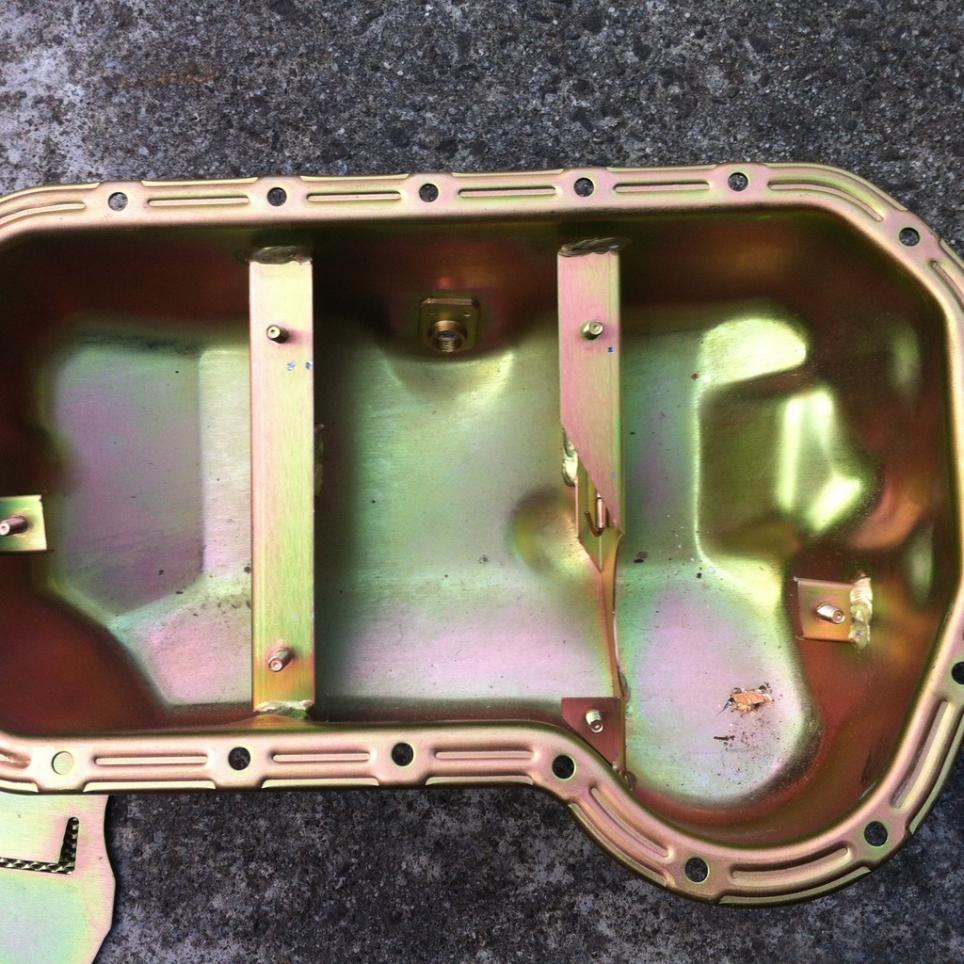

                Did the sump have a home made oil dump inlet??
                Or there might be one spare in your parts collection.
                  Well the motor without a head in the passenger space may have (not looked close enough) but as it happens there is a spare sump and I took photos of it, the one on the car is the same
                  Baffled gal plated item:

                        PM sent about baffled sump

                          I've just stumbled upon this thread.
                          As mentioned earlier on the thread, they don't look quite like SCCH items. The ball joints do, but the rest is different.
                          The large diameter silver items - are those the balljoint spacers, just sandwiched in with a bolt?
                            No , I worked it out in the end, all the bits except the rose joints are the steering arms spacers for bump steer correction.
                            The spindles are not there... Found them and they are on the car!
                              Ah!. Those are big steering arm spacers though. Intriguing. I wonder if they have been added to the kit after some bump steer measurements. Not usually seen with the SCCH kit anyway.
