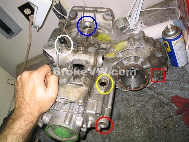

                            • This is how mine looks.
                              You can see the little sender just beside the selector housing. I reckon there's a square recess on you box in this area which might be for a switch.
                              Like this one
                              I'll have a look and see if I can confirm.
                              Pete

                              • Originally posted by Peter Jones View Post
                                Like this one
                                Pete
                                ohhh ok i see that i shall check mine out 2morrow...mine has a multiple point plug on the box and that lil dealy i think as well... i will find out what each pin is and give that a go if the micro switch doesn't work! thanks pete!
