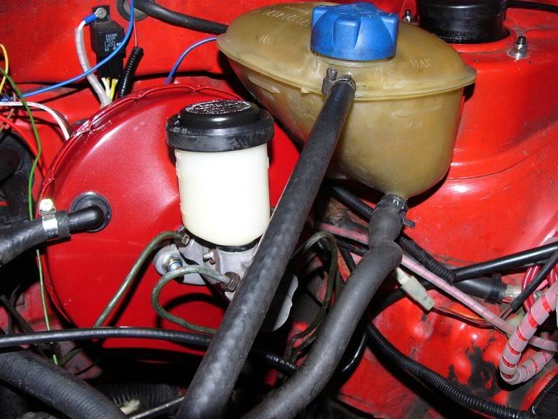

    But today i got around to looking at the brakes. For some reason the front calipers are always tight on the disks making it a noisy 12 hour trip home. And there's very little power through the pedal. My manual indicates either master cylinder or servo problems, so i managed to pick up a brand new servo to start with. It was sold as a mk1 servo but as ive noticed now the old one (Right) is off, is that this new one (left) is quite larger (all the bolts have the same spacing) but worse is that the inlet for the vacuum line is female rather than male on the old one. Does anybody know of a solution or have i just been given the wrong part?

    Looks like you've been given a mk2 booster there dude.
    You can use it but you'll have to get a fitting to put in with a male tail on it.
    Where did you get it? Take it back to them and ask for the right one if you want.
    Take a pic with that plug removed so we can see how the vac line is fitted.
      Just pop down to a wreckers and grab the pastic Barb hose fitting off a Camira or some thing. You might even find one with a one way valve in it , Commodores use this style from memory.

        this is with the cap removed. There's a rubber grommit which i'm guessing the vac hose would have some attatchment to sit in. I bought this online so will try and sort out an exchange/refund, otherwise visit the wrecker.

              Nissan Pulsar. The spacing on the barbs at the bottom is the same as the VW ones. I got mine from a wreckers, but they're available new too, they're a PBR part.
