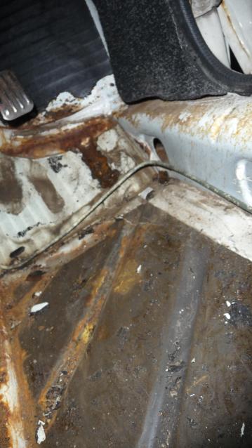

    Basically, I had to take the mk1 to work yesterday when we had the huge downpour in Melbourne (there's a longer story here, but lets stick to teh topic).
    I got home and felt the carpet and it was a little damp, which I expected. So I lifted up the carpet and underlay to let it dry out. However, I found some rust that will need treating. Pics to follow tonight.
    On the good side is that most of the bitumen sealer crap is easily chipping off, so I should have a stripped floor fairly soon.

      I por15'd my passenger side floor which has some rust issues. It is great stuff! My std underlay was in excellent condition so I just put that back in.

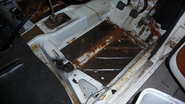

        I got the bitumen stuff off the front floors. It chipped off easily, but there are some further parts that will require a heat gun. The rubber pads on the front wheel wells, to the right of the pedals, are going to be pain in the arse
        There's no holes, which is good, but will take some work.

            That's not too bad, you've caught it in time. Bit of work ahead of you but at least no welding!
            Another place you can get leaks is the seam across the firewall, check in the engine bay that the seam sealer is all still there and in good condition.
            Leaks from that seam fill up the kick plate area in the footwell and get under the carpet.
            Check all the rubber plugs and cable grommets in the floor and firewall too.
            Fixing the leaky screen will save your fuse box too.

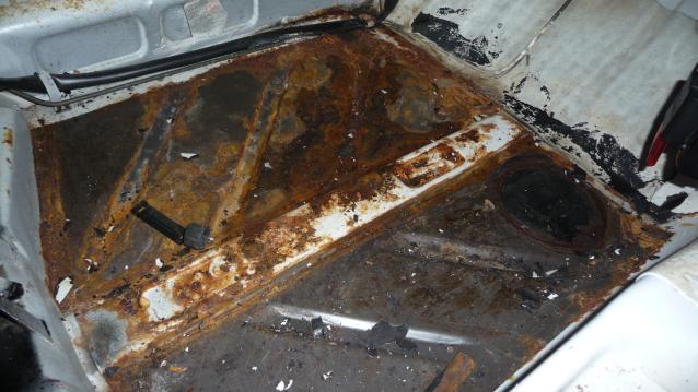

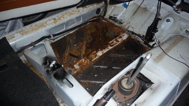

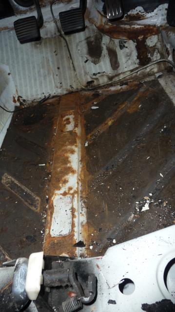

                The photos make it look far worse than it is. The old unerlay is pretty worn in the footwelss. Maybe i'll just cut out the bad parts and add some new sections

                    Just wanted to touch base on the por15 process. Strip it to bare metal, marine clean, use metal ready (phosphate?), wash off with water, then paint with rust protection paint.
                    Is that the right process? Also, I used a Heatgun for the deadener and worked great
