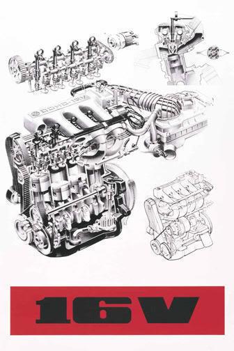

                2.0 16v for maximum fun
                1.8 16v for lots of high reving fun
                2.0 8v for lots of torque fun.
                Knowing that 16v's are pretty pricey here in Oz 2.0 8v could be way forward (or 2.1 i you dare to be different!)
                it all comes down to "how deep are your pockets???"

                    a std KR 16v is 139bhp so will be more power, less work (modifying) being on the engine therefore very reliable.
                        Agreed, the work you listed Jarred is quite alot, with lots of machining and engine rebuilding and will still pull less than a standard kr running on digi or kjet.

                              A big valve head is a couple of grand on its own
                              What you're talking about is a fully built engine - you can't just drop in new pistons and big valves and drive away!
                              There is NO point tuning an 8v unless race regs restrict you to do so. It is far cheaper to drop in a 16v or even a 2.0 8v
