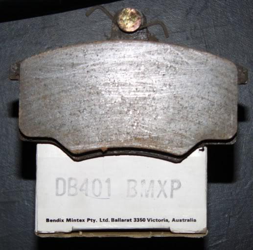

                  Now I'm getting confused. This is the type of pad that is on my car.
                  But I cannot find it in any catalogue as being fitted to a Golf.
                  It consistantly shows up as an Audi part.
                  The Pagid catalogue also suggests this is to suit a Lucas caliper. I'll have to check what's actually on the car.

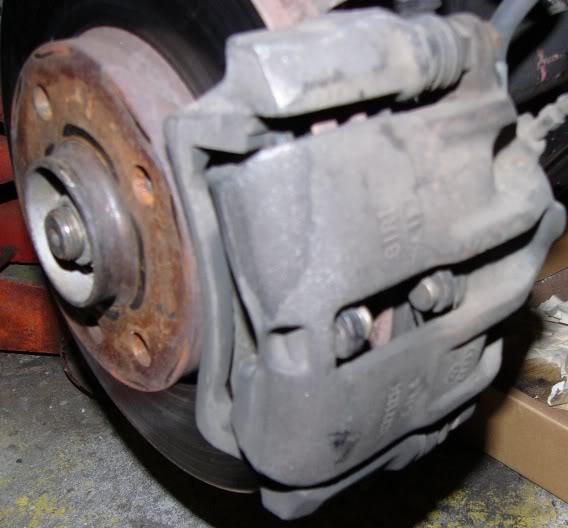

                            Here's the brake caliper.
                            It's made by Girling.
                            The Caliper is marked VW AUDI 32321234 CN6 5100
                            The Carrier is marked 1288 CN3
                            The disc itself is 239mm diameter and 20mm thick.
                            Any clues?

                              isn't the audi caliper a twin piston jobbie?
                              This one's a single.
