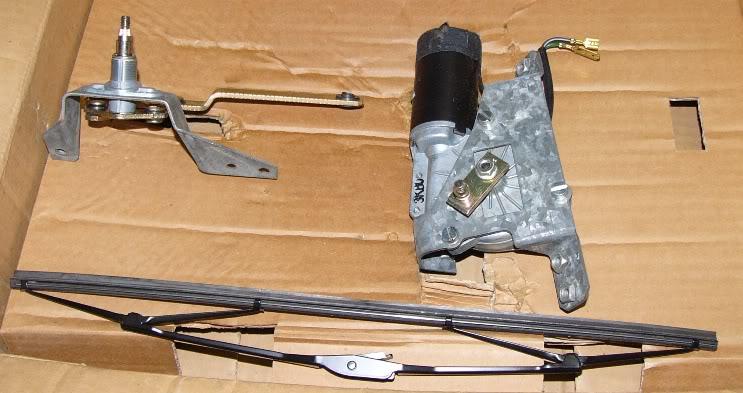

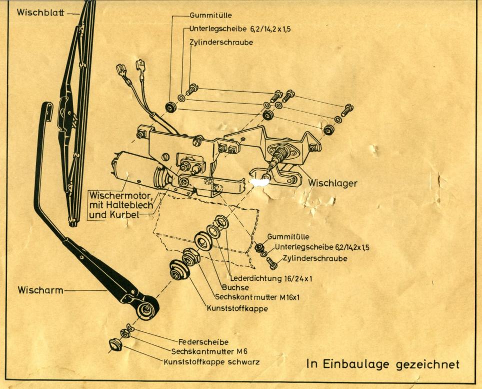

Guys, Got a mk1 hatch that doesn’t have a rear wiper, I just got a factory rear wiper set up (thanks Matt) but have no idea how they are fitted or where to position the arm on the hatch and the cutting to fit motor in the hatch door!
Would really appreciate any photos, measurements and details on fitting the rear wiper to a mk1 hatch!
