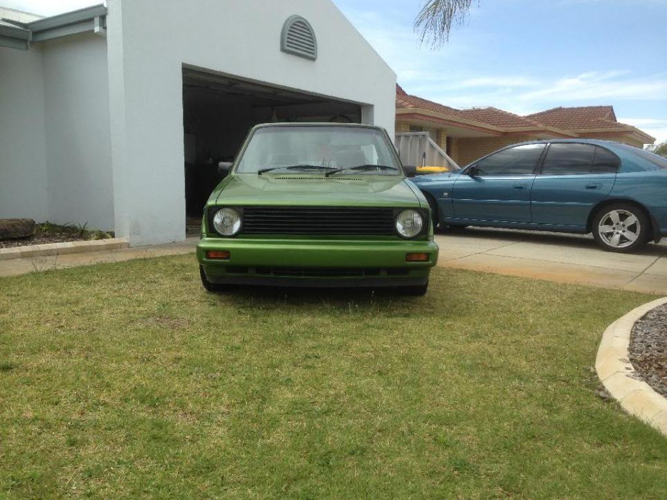

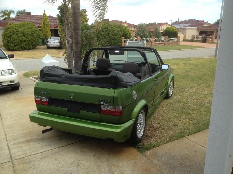

    Hi,
    I have been wheeling and dealing to get bits for my $500 purchase late last year. A Mk1 Golf 1982 Cabriolet with a 1.6 8v and 5sp 020 gearbox in it.
    The paint job was done by the previous owner. He resprayed the car in Holden Hot House Green. It was supposed to be rebuilt for his wife but the project stalled and was mothballed in his yard for 5 Years!!!
    I came to its rescue tho.
    The original interior was an awful colour of red and brown so it had to go. I waited for a solution. It came in the form of a late 1993 Auto 1.8 Cabriolet with no Rego. It had the ideal coloured interior, the black goes well with the Green paint. Plus it had all the bits minus a decent canopy to get my car to a presentable standard.
    I then made a deal with Grant. AKA Roccodingo for his BBS Wheels in exchange for the remains of my 1993 Cabriolet.
    Just recently I bought a front D/S smashed 2007 GTI Polo for its running 20V Turbo engine & Gearbox for $800! A steal I reckon! see pics
    So now recently gutted the polo and sold some bits to the polo boys here on VWWatercooled and its going on the scrapper truck tomorrow...
    To Get my Golf over the pits in standard form plus have a bit of fun in it whilst I save up the cash and source the various custom bits needed to convert it into a 20vt. I bought a second hand set of Weber DCOE 40's to go onto the 1.6 8V.

                    It's been a fair while since I have posted on here. The project has slowly been coming together. I had to seek the 20v (too many bills to pay) but I kept the twin dcoe's and now have a 2.0 8v lump with a high lift cam to bolt them onto!
                    I have also been painting all the body kit and sourced some nice m3 style lights for the rear. Check out my pics on this link!
                    Golf Cabriolet Mk1 Build Photos by colin_fisher1 | Photobucket
