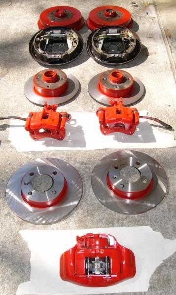

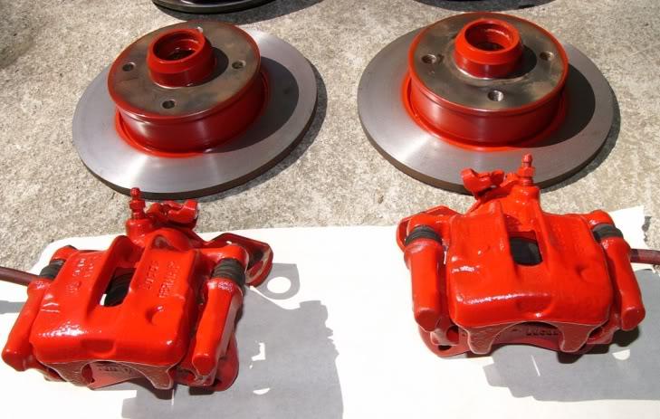

    It's been too hot to start anything major in the driveway so I've been cleaning and painting brake parts. The sun is doing a good job of the drying process!
    I thought I'd pop up a few pics, not everyone would have seen all these types of brakes. They're all going onto my MKIs.

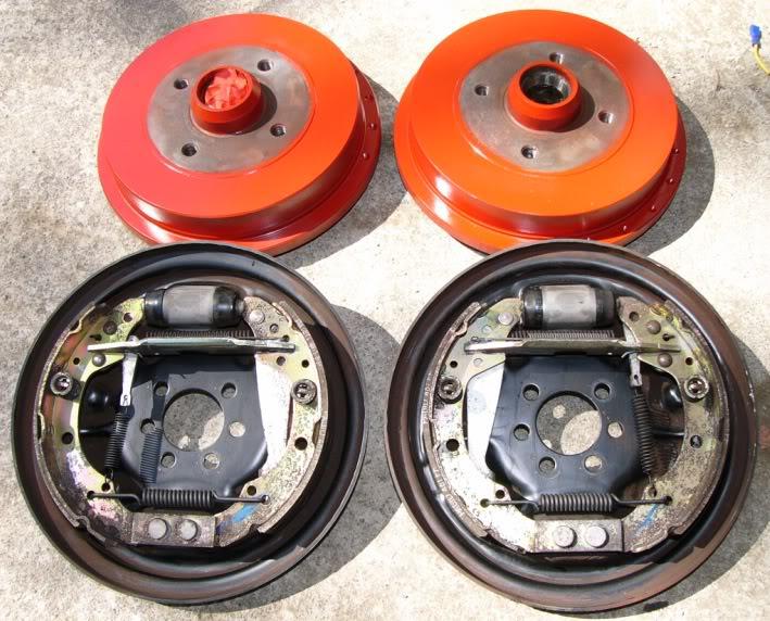

    1 Seat Codoba '97 rear drums. These are going on my Red MkI.

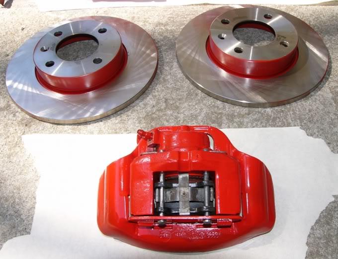

    2 10mm Solid Discs, brand new. These are going on the front of my red Golf. ATE calipers not sure what model these are off. The
    other caliper is still drying.
    3 Seat rear discs, Cordoba or Toledo I think, I got these from Matt (Golf Loon) and will finally get around to putting them on my White MKI. Freshly machined, new pads on the way, I already have the Scirocco handbrake cables to suit. This car already has GTI vented rotors and matching calipers up front. Guess I'll have to pull those off and paint them too!
    All at once!
    Paint is VHT Drum,rotor and caliper paint. It takes a while to dry but should stand up to the job.

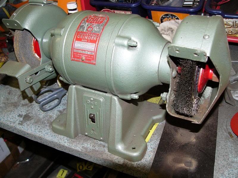

      This is another restoration project that I finally got around to. I've had this ratty old grinder under a bench for about 10 years.
      I re-wired it and repainted it and bought a wire wheel to go on it. It's been the greatest thing for cleaning up all these brake parts.

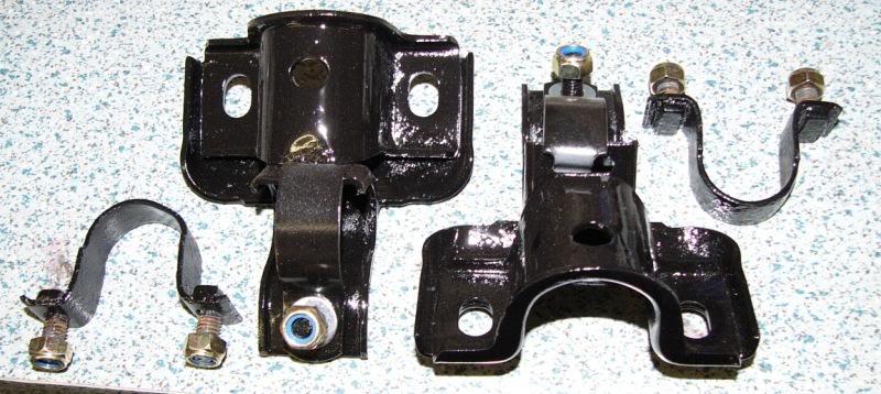

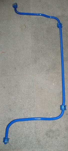

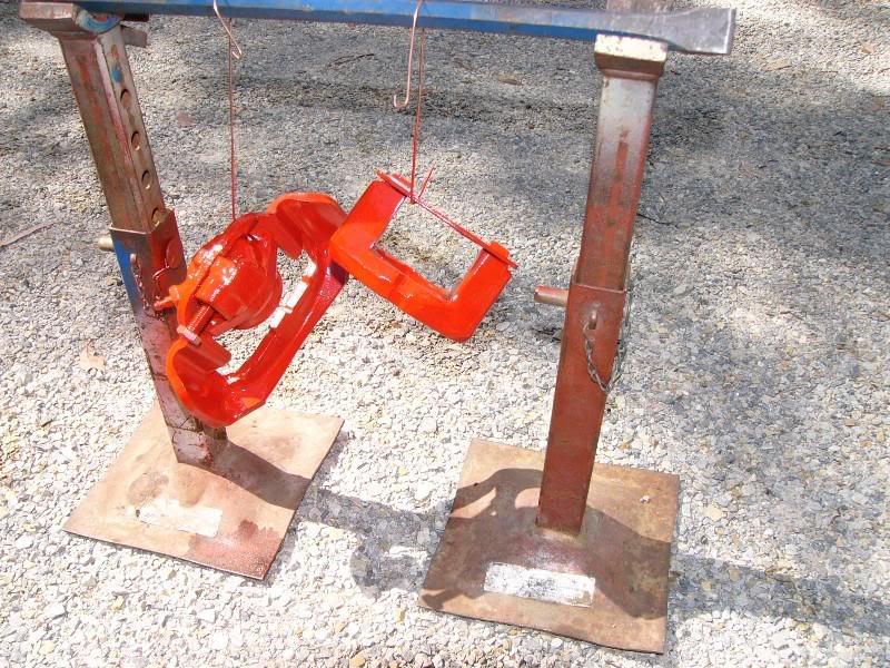

          Another little clean up job I did at the same time. This is a GTI front anti-sway bar that's going on Red Golf. Valver is Sending me a white line bar to go on White Golf. Confusing isn't it!
          The brackets were pretty rusty before I hit them with the grinder!

            Just another shot of the process - parts drying in the sun. Even after a few hours of sunbaking the paint is still a little soft and tacky. You need to wait until the following day to re-assemble the bits. The bolt is just there to keep paint out of the internals.
