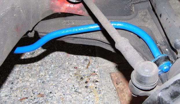

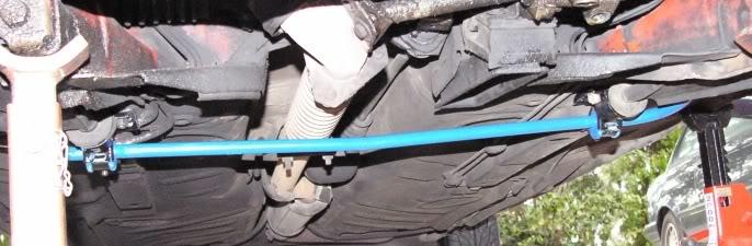

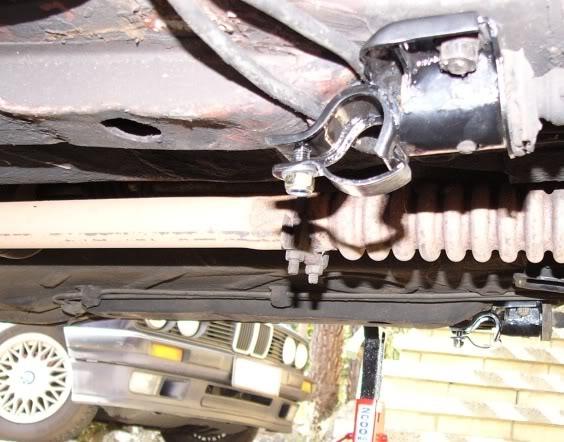

    Now the sway bar.
    Not too many dramas here. The fuel line had to be shifted around a bit to clear the brackets. Drilling the holes in the arms wasnt too bad. Still seems like a funny way to mount a sway bar. It's a bit close to the exhaust and when I started it up later on it's knocking against it. That can be tomorrows job. Yes I know there's a lot more cleaning to do under there! Those bushes didn't look too healthy either, will add some to the shopping list!

        That's one of the draw back's with front sway bar's.
        You need a GTI down pipe as they are shaped to go over the bar, or get your original pipe reshaped. Even reshaped it can still hit with hard acceleration & race/snap change's.
        The ABD one's have a bend in the centre to help with this, but they can hang down very low to the ground.
        I also found with the front bar fitted that it can be alittle noisey in the bushes.
