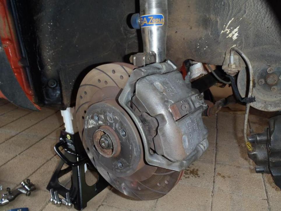

The Mk1 GTi brake setup, slightly bigger caliper with 239mm vented discs. The kit is up for sale and has pagid fast road racing pads installed, 2100km old only and heaps of life left. These pads do not fade no matter what you do to them. No adaptors needed as it bolts straight up to the mk1 hub and will clear 13" rims

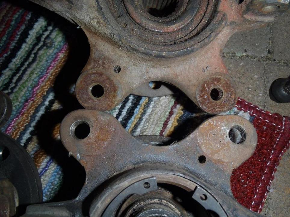

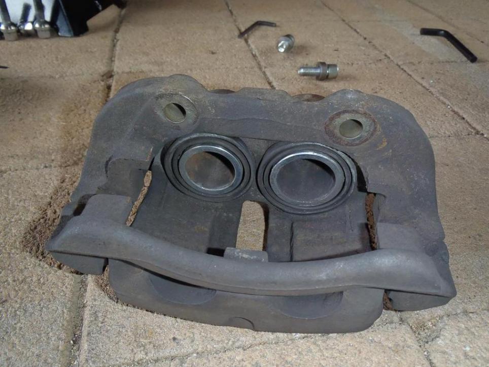

The next option moving forward is a 256mm vented disc and 54 series caliper. Big Improvement to braking over the 239 mk1 GTi setup. No pics sorry as still boxed but comes with new discs, rebuilt calipers, resleeved carriers and adaptors to bolt straight to mk1 hub. 30 minute job to do both sides. Will require minimum 14" rims

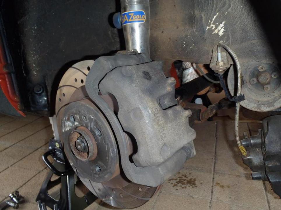

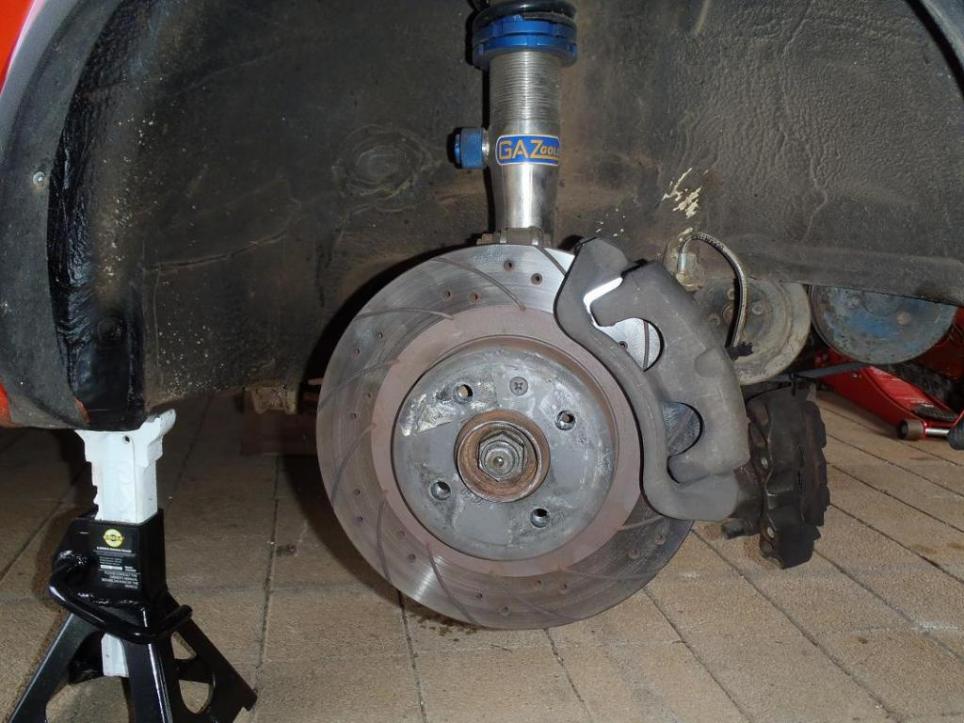

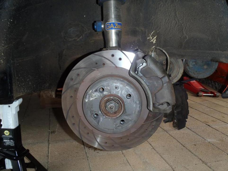

Option 3 is a step forward again and is the 280mm big disc upgrade. This uses a mk1 gti caliper matched to a 280mm custom offset disc and is a step again over the 256mm option. This kit comes with newish Black Diamond combination discs (1200km old) and has no warping or grooves what so ever, they present as new, also caliper adaptors and hardware. Just needs mk1 GTI calipers or I can supply at extra cost. Kit requires a minimum of 15" rims (also for sale very very soon)
