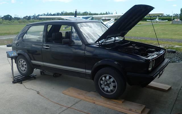

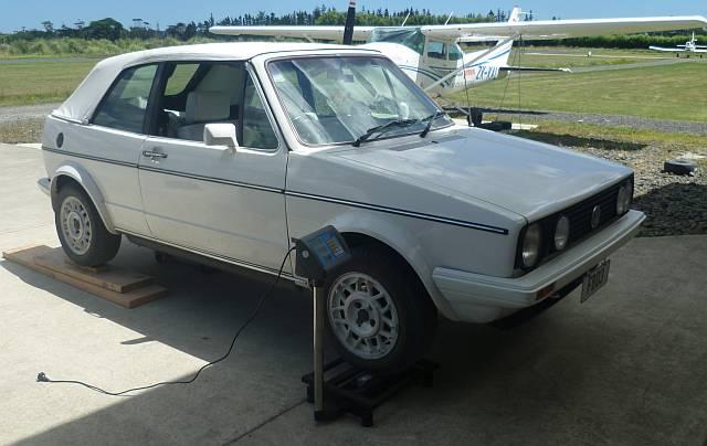

Ok. So we got carried away and weighed them both at each corner and we added weight (me) to the front and rear seats and recalculated the weights to work out the percentage split that the weight adds to the front and rear, then I made a spread sheet so I could plug in different weights to see how the balance would be affected.... Yes, I get carried away sometimes...
All weights are in KG, both cars had nearly full tanks of gas onboard - 35L each (weighing 25kg)
My Hardtop is an 1800 and the Cabby is a 1600, also the Cabby has a towbar we'd estimate at another 20kg.
Front Rear Total
Hardtop: 562 327 889
Cabby: 591 393 984

If you want to get really carried away, I also have the individual corner weights:
Hardtop Cabby
LF 286 293
RF 276 296
LR 159 188
RR 168 193
As you can see, the Cabby carries most of it's extra weight out the back.
