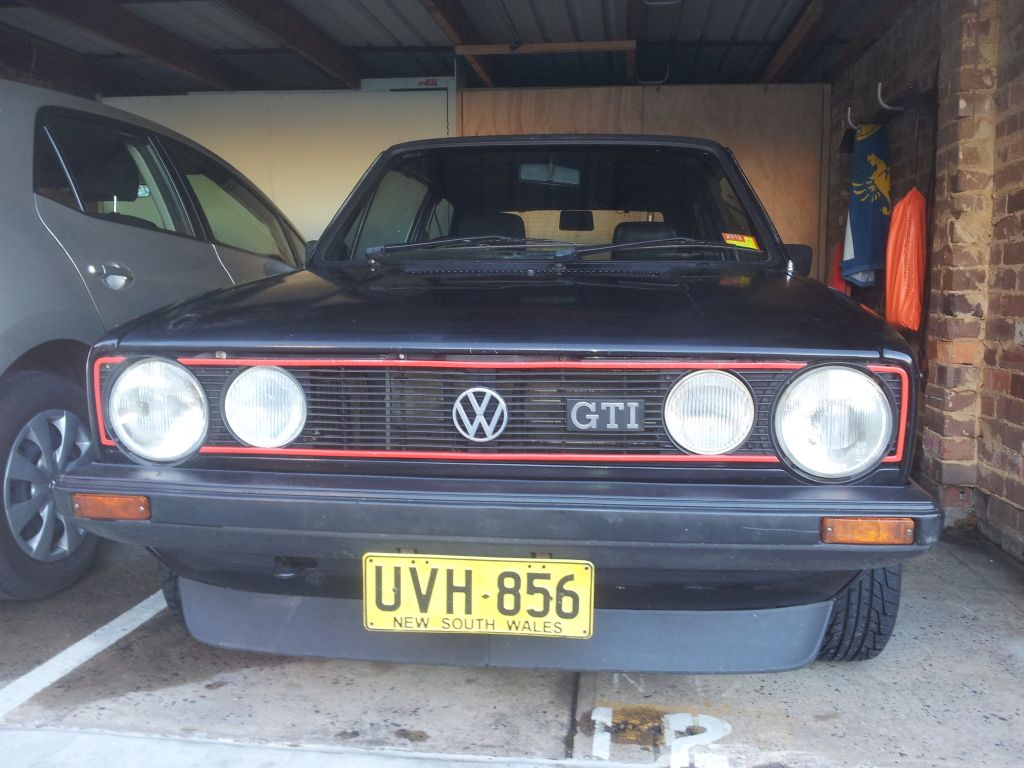

    Hi guys thought i better put a new thread up as now Raus the mnars red has gone to another owner i have managed to purchase a mk1 Golf GTI of Ian in Roselands (great chap)
    Pictures attached.

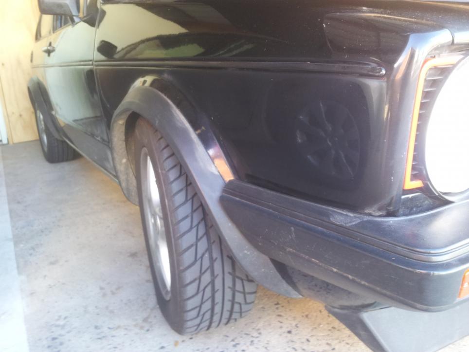

    Firstly the front top mounts are to be replaced. Will update pictures as i go but here is some for now.

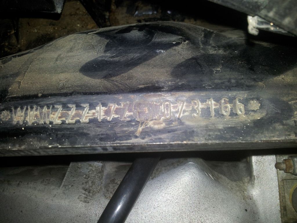

    Looks like a campaign from the VIN.

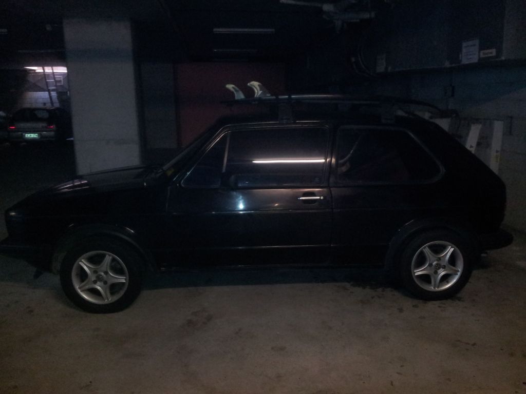

            New front strut mount suspension kit bushings and bearings installed and lowered suspension 2 inches

            Got a chrome dash surround and vents from UK coming $50
            Rear shelf cables and door handle rubbers $10 US
            Cleaned and tried the paintwork, way to faded needs a paint job so rust repairs will start. Nothing major

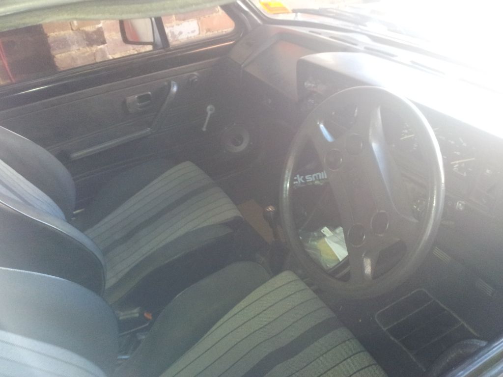

            Removed seat covers and fitted GTI steering wheel
            [IMG][/IMG]
            Chrome lower trim installed, side trim to be ordered.

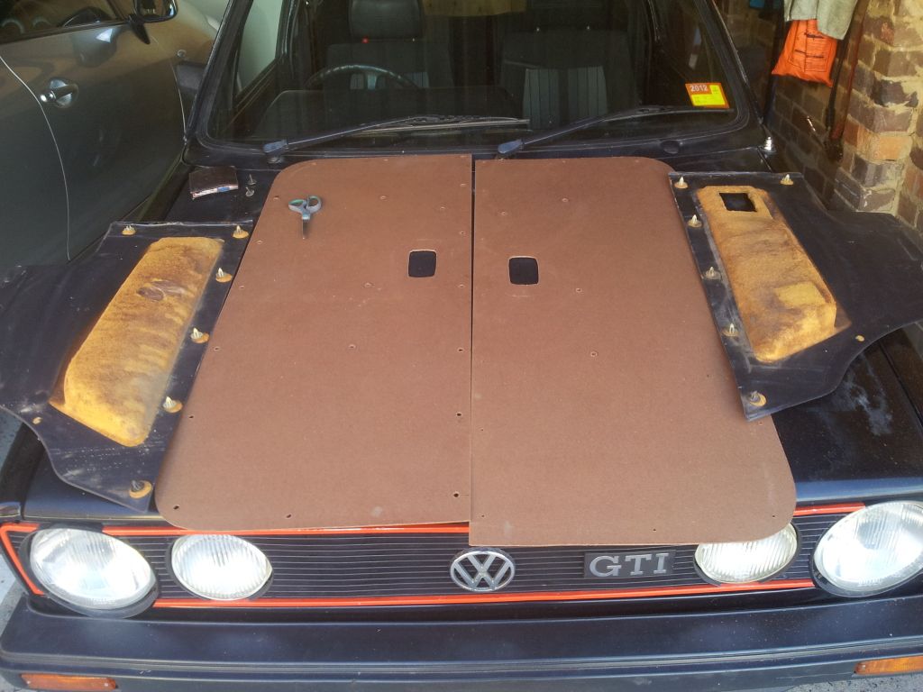

            Door cards are F*#ked so have made some new front ones and the back ones are of. Going to get them wrapped.
            [IMG][/IMG]
            Rear parcel shelf supports need replacing and rear trunk cover to be replaced next weekend. Then the dreaded electrical gremlins.

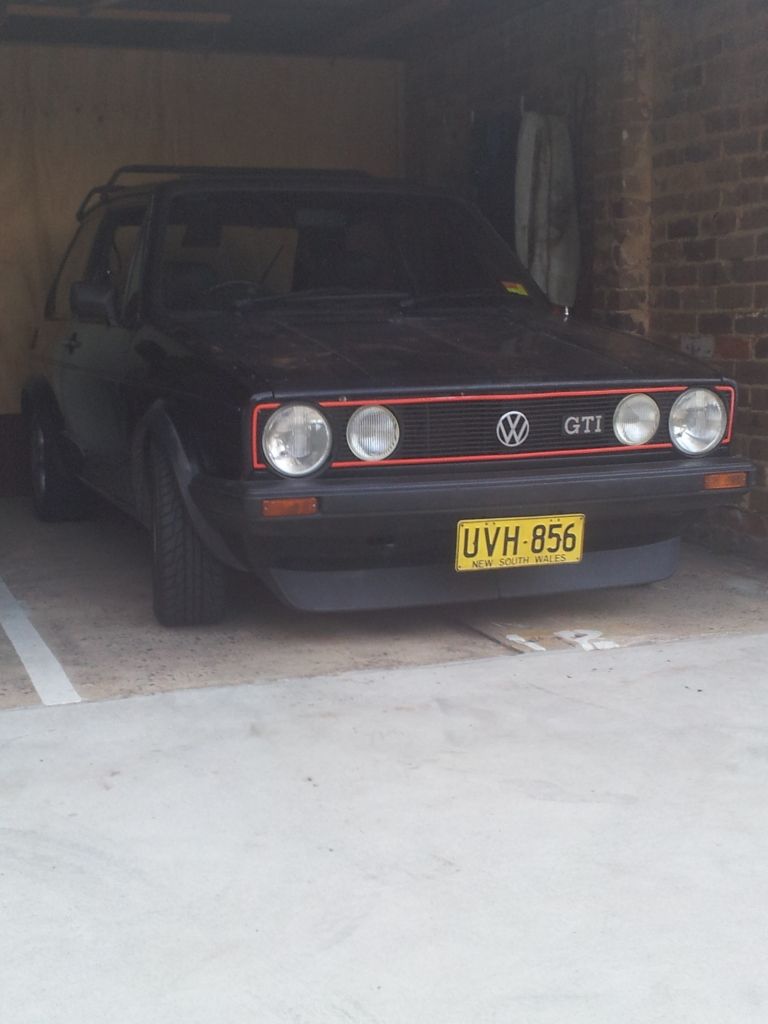

                            New wheels
                            [IMG][/IMG]
                            Thanks Lewis all good
                            76 Mk1 4DR SOLD
                            01 B5.5 Passat Wagon SOLD
                            84 Mk1 GTI
                              Sweet choice of rims
