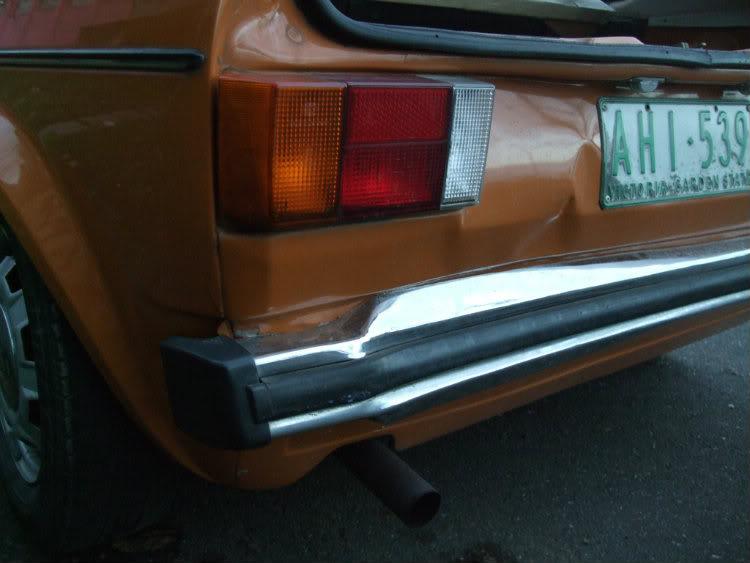

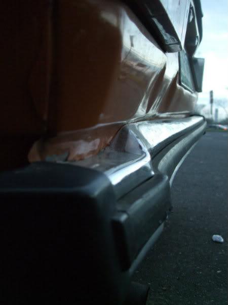

    Unfortunatly I got rear-ended the other day at the lights, and the lady did a runner... Now I’m left with a fair dint in the rear, a flattened bumper, and a smashed windscreen.

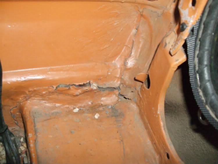

    I’m after opinions as to how bad the panel damage is in the rear, sorry if it’s hard to tell from the photos, let me know if better photos are needed.

      Winscreens new can be had for around $220 at the low end or more than $300 at the high end.
      From the look of the inside shot, its quite repariable. Personally, I'd tackle it myself, but a panel shop would manage it pretty easily I reckon.
      The bumper is probably the most difficult thing to replace.

      Now, I assumed you meant front windscreen... of you mean the hatch glass.... well second hand is probably your best option.

                I have brand new rear bumper bar under my house if you need one.
                  Cheers, I will probably try to get both front and rear bumpers new as the front is also bent a little on both corners.
