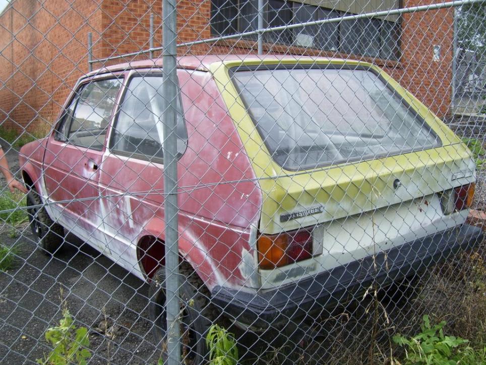

          This is a swallowtail. The panel between the rear lights curves upwards to the edge of the lights and is an early stamping. All cars after mid 76 have a straight panel.
          They are th 1975 build only, early 76 in Australia. Swallowtails are worth good $$s in the UK, but no one in Oz really notices
