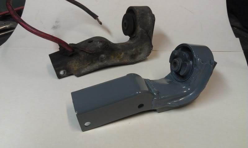

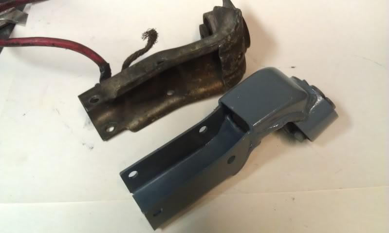

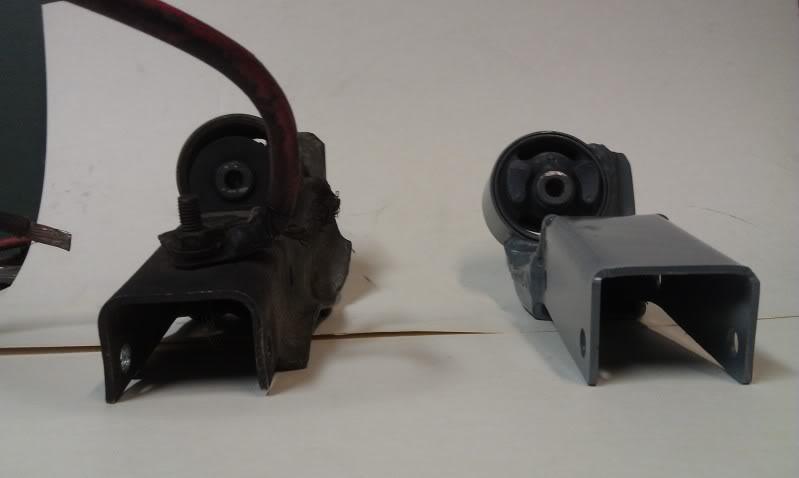

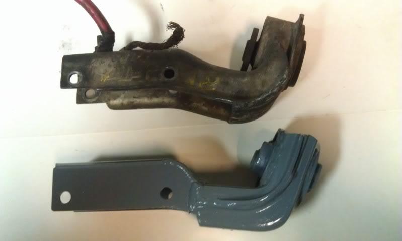

    In the last couple of weeks I've finally got around to a little project that's been in the back of my mind for a while now - an easy 4-speed to 5 speed gearbox mount conversion.
    Since everyone wants a 5 speed, but 4 speed mounts are so plentyful, I figured this might help out some of us.
    Here are some pics of a standard mount and a newly converted 4 speed mount:

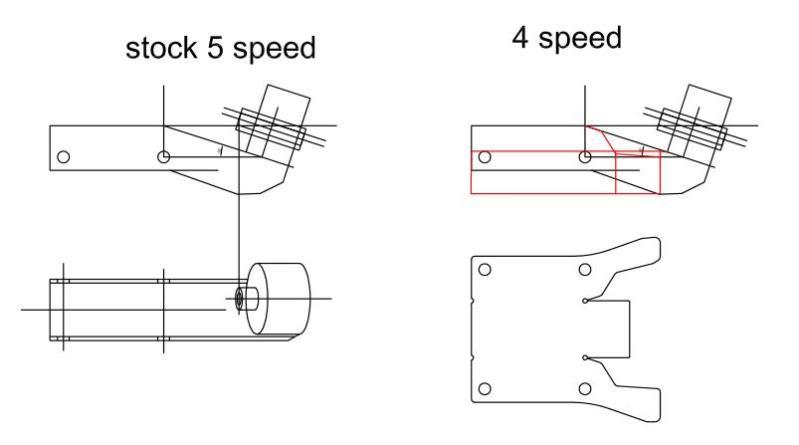

    and here is the R&D
    Basically the mount is converted by cutting the usable chassis mount off just after the bend, and then replacing the offcut with the lasercut 3mm (same as the stock 5-speed mount) steel plate which I designed above. The lasercut net is folded at 90 degrees between the indents, and then inserted into the old 4 speed chassis mount. After this its a simple job to MIG weld it together.
