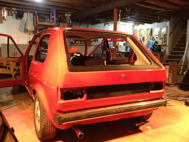

    Yes the window are out, dash is still in that's why I tape the inside up

      That polish goes everywhere judging by the look of my neighbours fence that is ;-P
      good way to get your windows out is, from the inside of the vehicle, start flicking the rubber back with screw drivers over the edge of the metal that it is sealing over.
      Start near one corner and do a decent portion of it until you feel the window will start to pop out the rest of the way without to much effort. Good idea to do at least 40% of the window.
      it takes time but you can get any window out without cracking it.
      otherwise pay a professional to come out and do one for you stay their watch and learn.

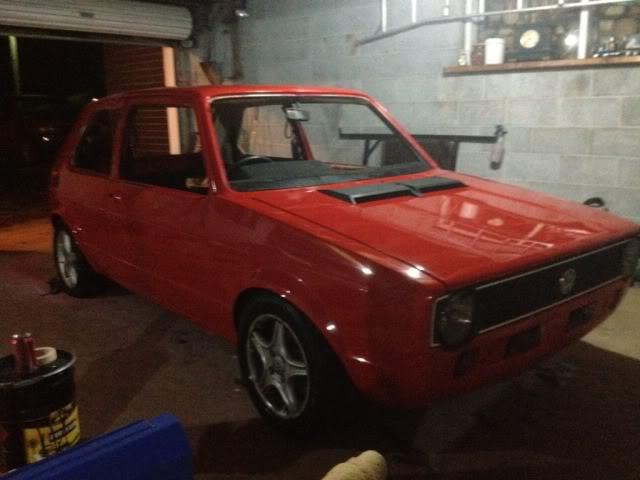

          Really didnt "pay" for the spray job I had another golf and my painter wanted it, so yeah, buffing later this week, so more pics soon

            Colour and wheels look fantastic mate !!

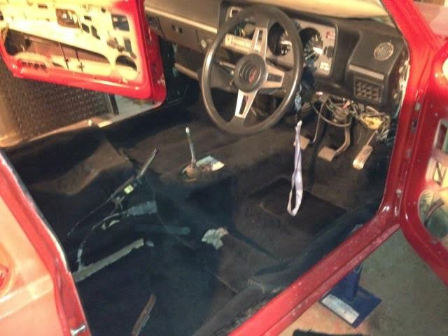

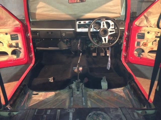

              Hi all work is been slow waiting for things now they here so I have to pull my finger out and get the old girl done, any way last night project was the carpet

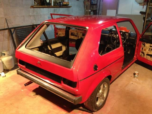

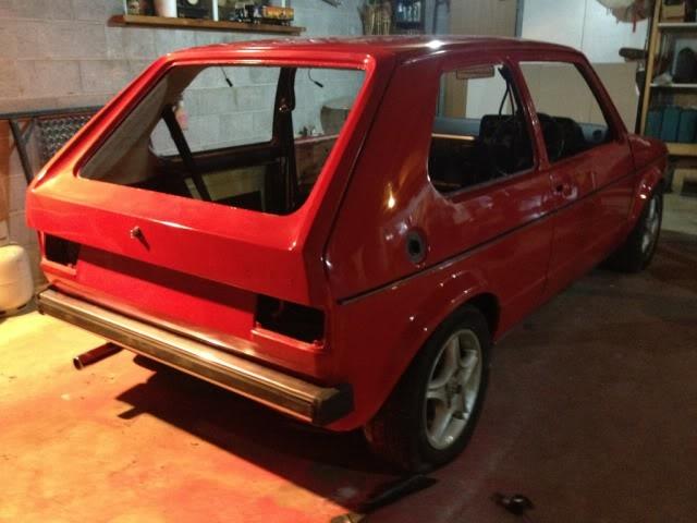

                Busy night gave the old girl a cut only a pollish and a wax to to go, here more pics though

                  Me and a mate set out to put some stickers on 1.5 hrs later one is on

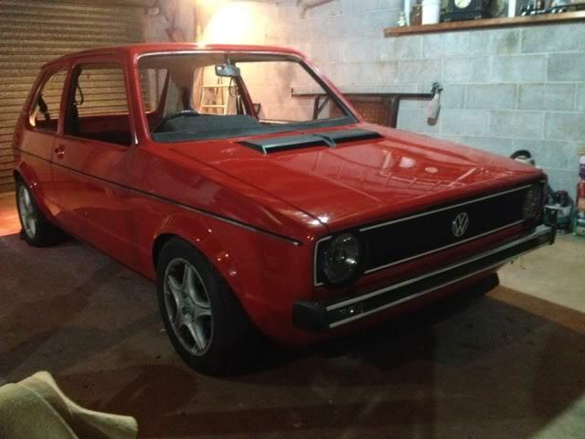

                        What are the bonnet scoops from.....? Never seen that on a mk1 before!
                        • #27
                          Hi all window in tomorrow I hope, the front scoop I ve been told it really rare I saw it on a guys golf he didn't like it and he needed a front console which I had, so I got it.

                              Its called a "kemei scoop"
                              • #30
                                * KAMEI *
                                Mostly good for keeping leaves and water out of the rain tray.
