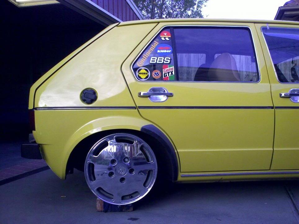

          these were fitted to my car 16x8 with 25mm adapters, they sat flush with the rear guard, unrolled will be rubbing, if i was to do that setup again itll be rolled guards and a 165 tyre
          Dom
            Haha you read my mind. Check that PM I just sent you Dom! Ha! Yeah its those exact wheels and oh my how beautiful they do look on your Mk1.
            Rolled guards, Check.
            Adapters, Check (almost).
            165 tyres... next on the list.
            Anything else you can think of, having been there and done that? Also, you don't happen to have the adapters still do you?
