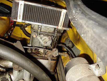

        here is a picture of the weber on my parts car... i am assuming you have a down draft?
