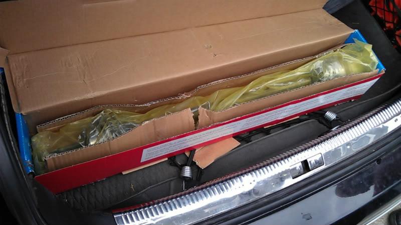

                        Only just got home (It's 10:30 these long days are killing me)

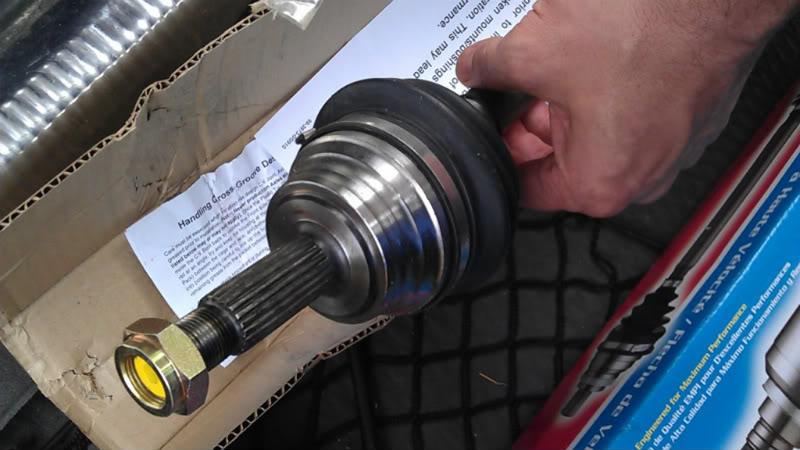

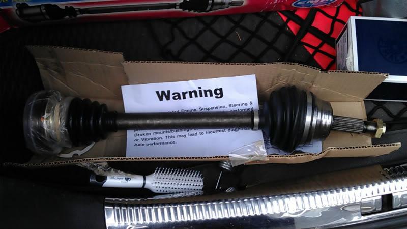

                        I won't get a chance tonight to measure these up but they sure look like MK1 drive shafts to me.
                        EMPI brand from GAP

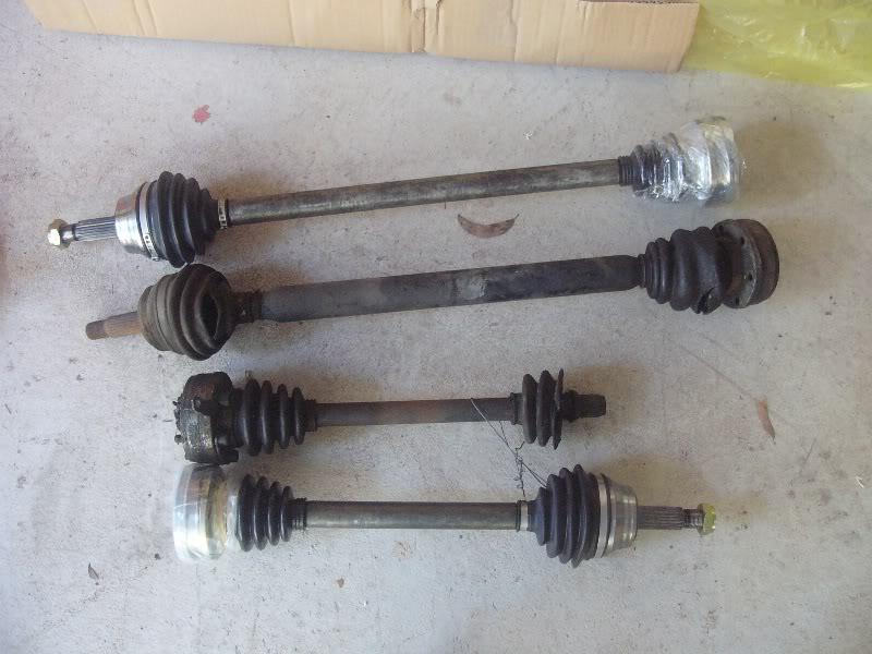

                              Had time to check them out today.
                              Yep, they're MK1 all right.
                              Checked length and fitment into early hubs, All good. 90mm inners, check.
                              Interestingly the new long drive shaft is solid rather than hollow like the original.
                              I weighed them both and the new solid one is about 1kg heavier.
