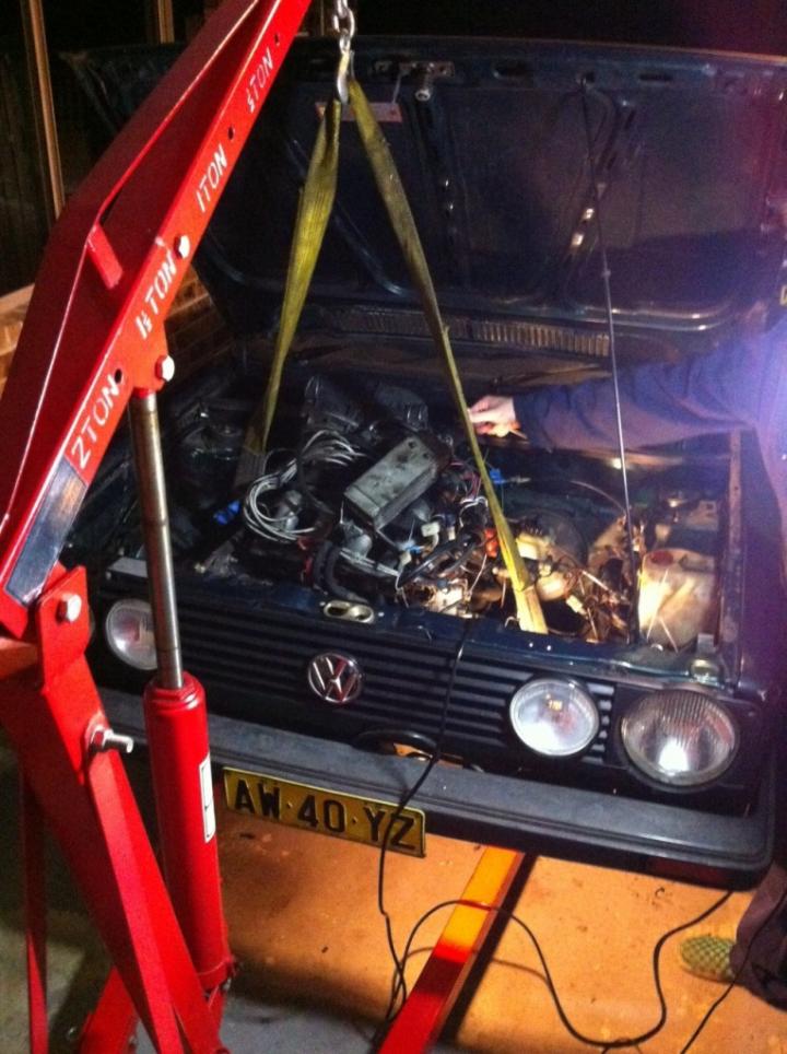

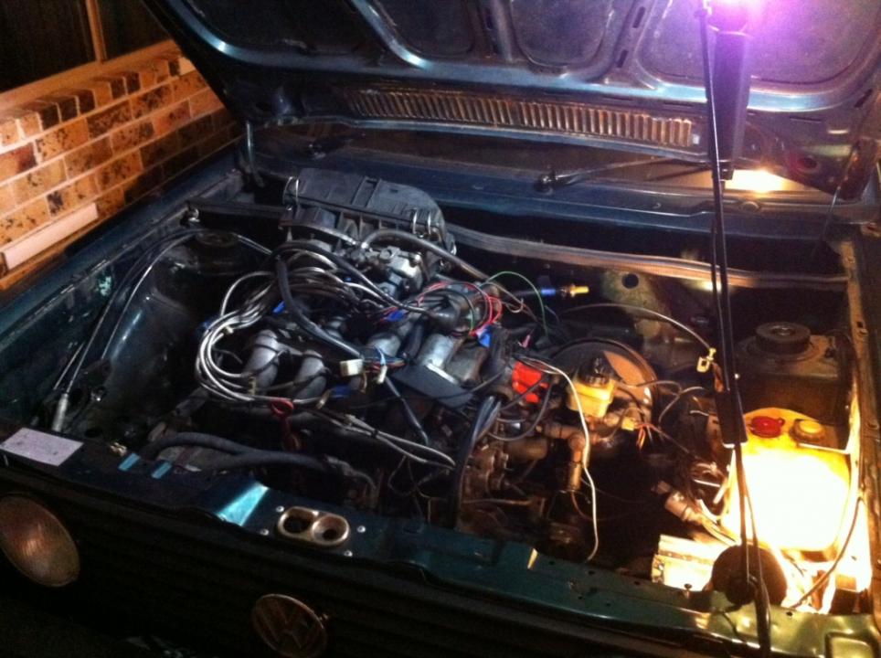

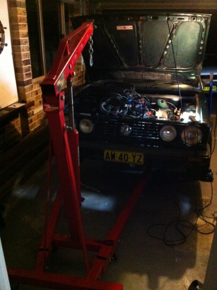

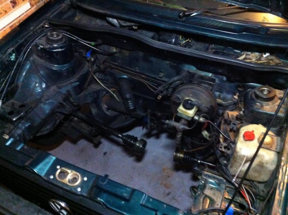

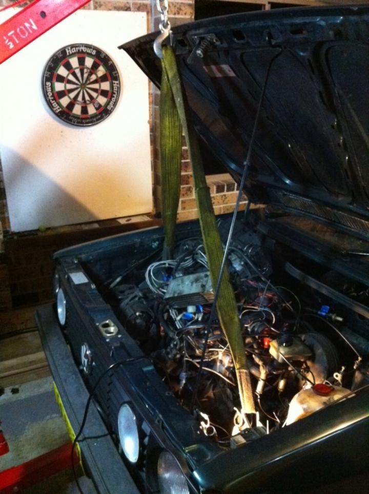

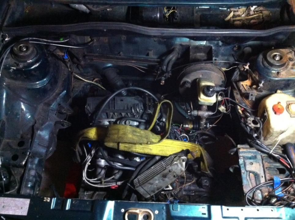

Got the motor out of the green car last night. It was a tough slog. Working after hours is starting to take its toll a bit. My mate Daniel and I have tallied up some seriously late nights so far. We didn't down tools yesterday until 1:30am, mostly because we couldn't call it a night with the motor still dangling in the air. I'm not working this weekend for the first time in almost two years, so I can't wait to get into it with some daylight behind me!
It took a good hour or so to get the motor ready to drop. We had to remove driveshafts, exhaust downpipe, some wiring, engine mounts and other odds and ends.
Got the crane ready to go.
I like using these straps. The length gets the motor on the ground way before the crane arm hits the radiator support. They're also good for maneuvering the motor while it's suspended.
We used the factory lifting point where the alternator bracket mounts, and made another one on the gearbox mount to get the best balance.
After working our way around the drivers side driveshaft and eventually pulling the LCA out to get it out of the way, we had the motor on the ground.

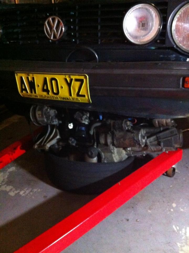

It was way too late at this stage to do anything else, so it's sitting on the garage floor like this. Tonight I'll jack the car up and pull the motor out from under it.
After that I need to take the gearboxes off and do a bunch of other stuff that I've forgotten right now. Need to find a coffee.

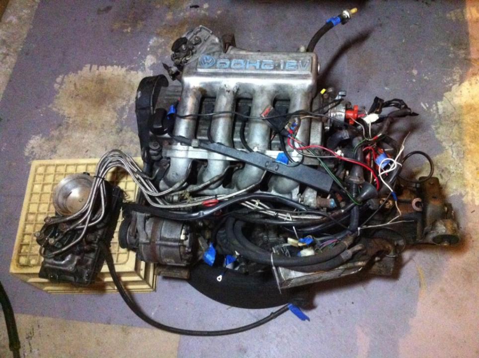

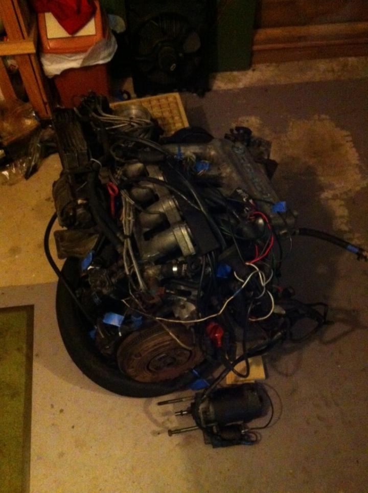

I made a bit more progress last night on Project Ümlaut.

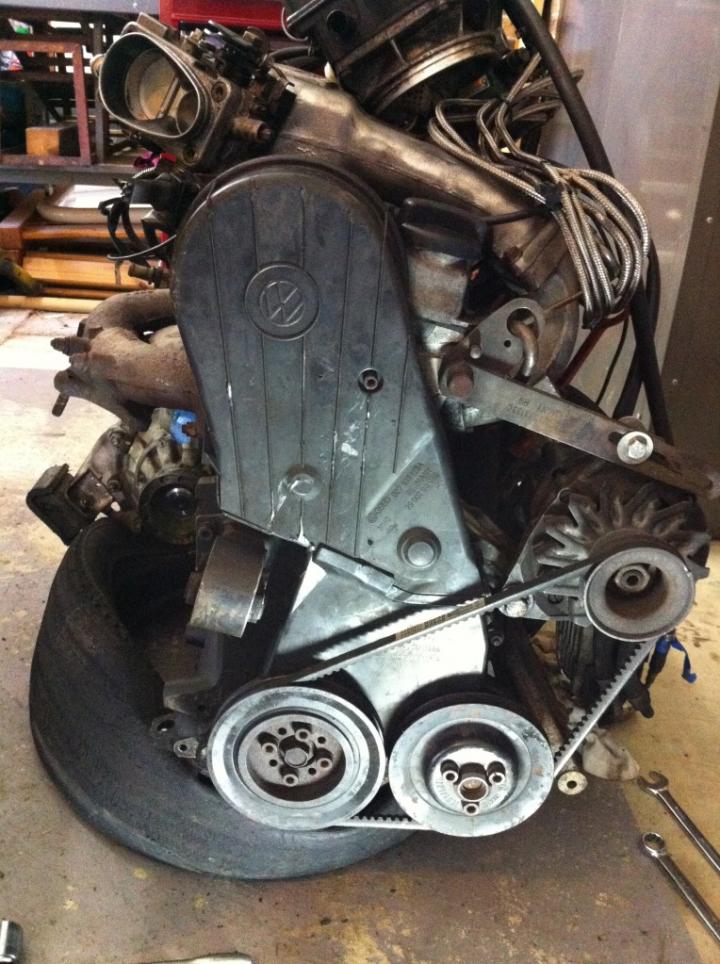

Got the 16V out and about. Resting it an old tyre was actually inconvenient as I had get the crane around it again and lift it up to be able to get the gearbox off.
A welcome sight. We're at a pretty big milestone for the build now with both motors out.

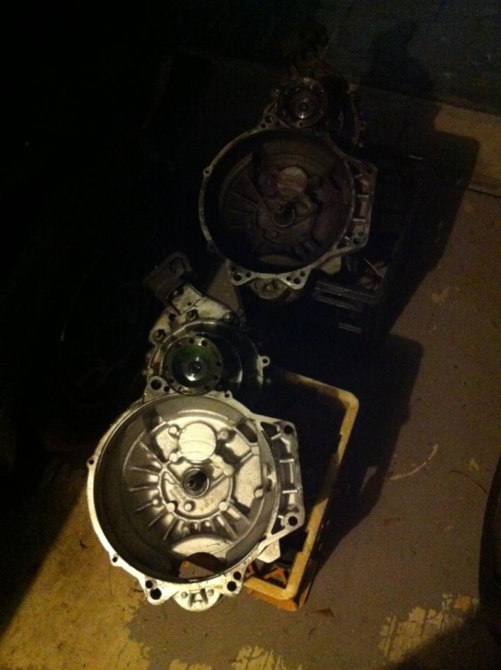

Both 'boxes are off and currently in the back of my car. I'm taking them to Craft Differentials in Granville today to have the LSD in the old box (top) checked out to see if it's worth swapping.
Plenty of work to do on the birds nest of wiring. It has the potential to be so much neater.

The ACD is a close ratio 5 speed from a MK2, it should have a 3.67 diff ratio and 100mm output flanges.
The 6Y might actually be a GY 4 speed I suspect. Show me a pic of the gear box mount on the end of the box and I can tell you if it's a 4 speed.
As to your diffs the 4 speeds have no preload on the diff and the flanges will turn in different directions.
the 5 speeds have preload and will turn in the same direction even though they're an open diff.

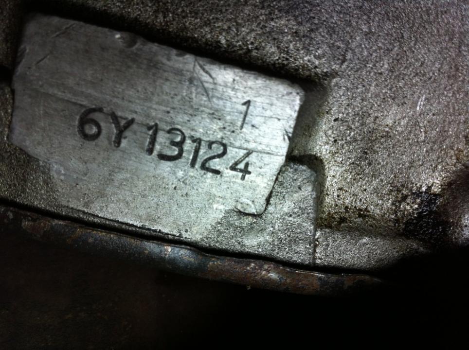

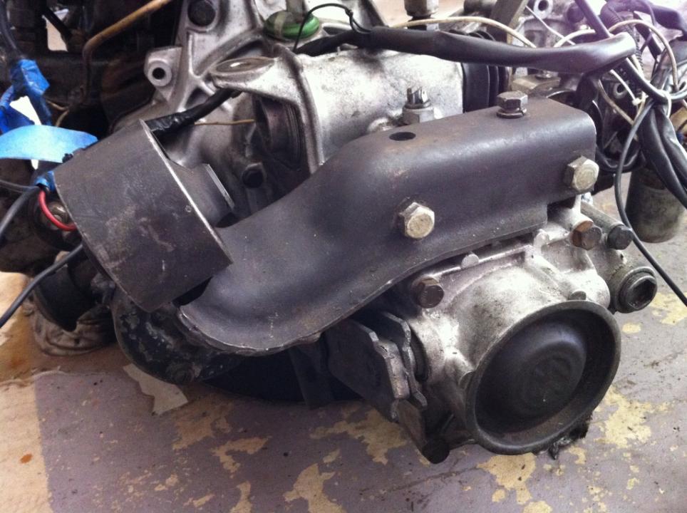

Here are the pictures you wanted of the gearbox mount. Are these helpful at all? I also took a picture of the markings on the bottom, and it looks unmistakably like a '6Y' to me.
I cannot find any mention of a 6Y 020 'box on the internet. Moving the selector into gear by hand seems to give six distinct positions, leading me to believe that it is a five-speed gearbox.
Also you were spot on about the Audi SD block. That means it's from a diesel motor?
That's a five speed alright. The 6Y code is confusing I'll see what I can dig up.

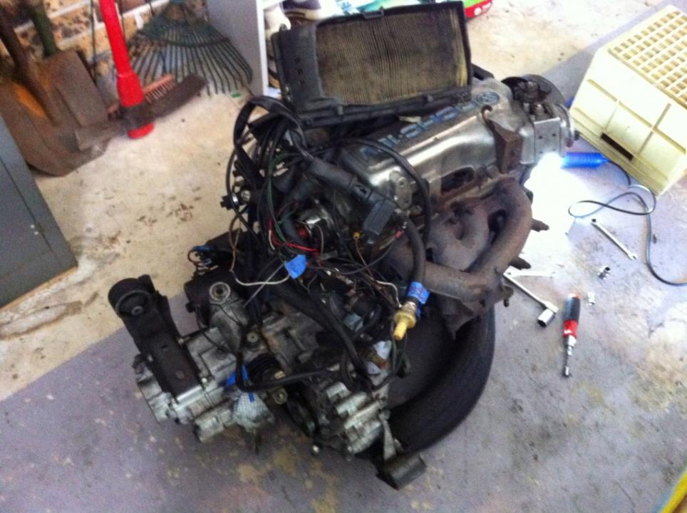

Picked up just the one gearbox from Craft on Friday. They're still putting together the other one which didn't have the LSD in it. It's getting new carrier bearings and a cleanup. Anyway, we put the rebuilt box on the motor to get it ready to go.

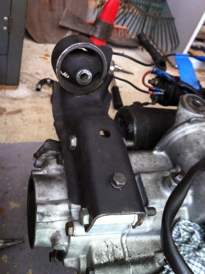

The engine mount you see in the photo above needed to be replaced. I had a new on in the spares I picked up, but the old one had to be pulled out so it could be pressed. Getting to it meant removing everything in this photo.

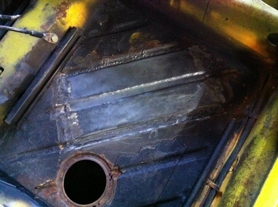

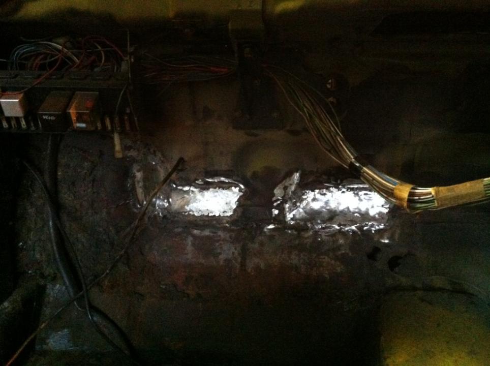

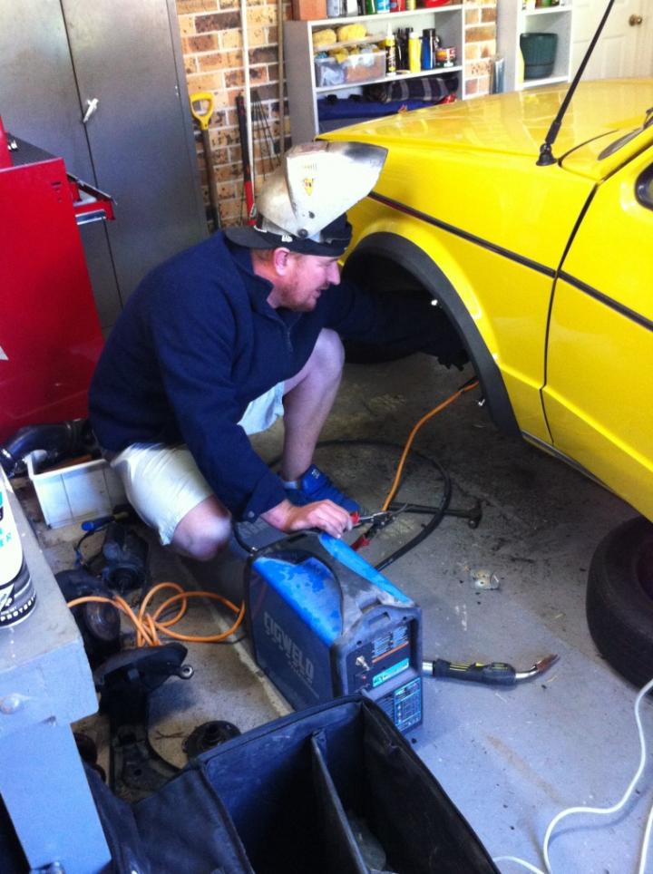

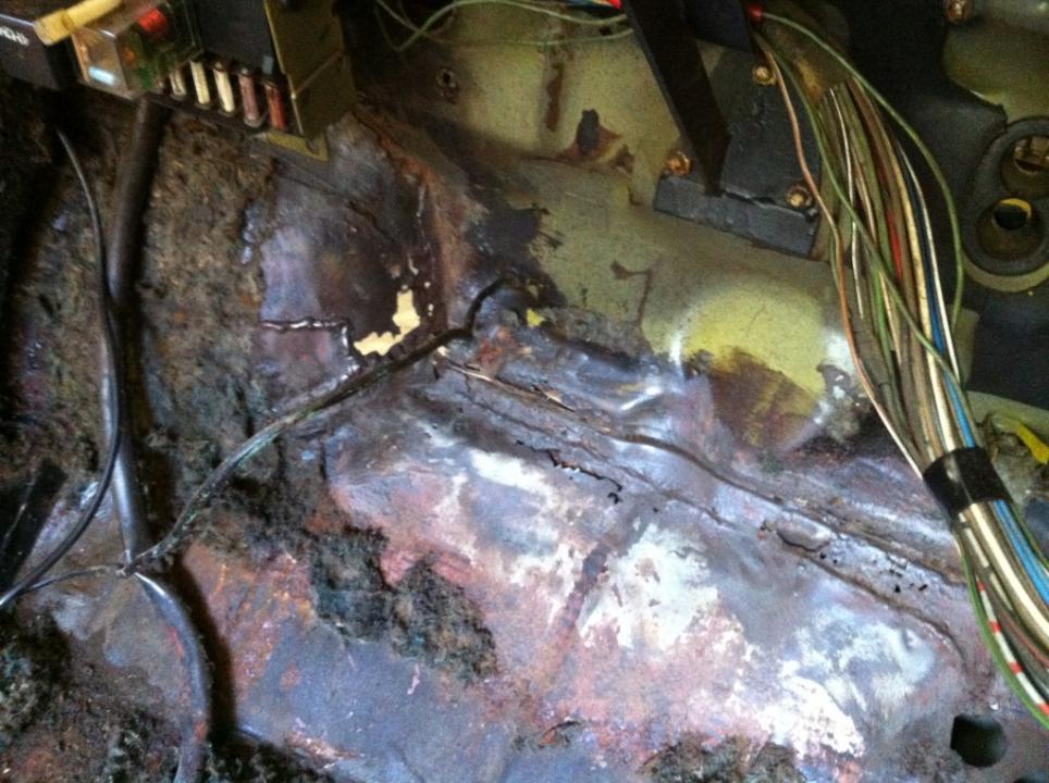

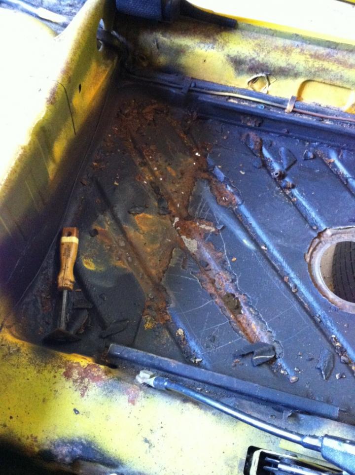

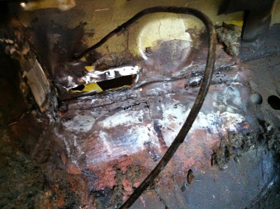

On Saturday a mate came around to tackle the rust. Here's what the floor was looking like after a bit of scraping around.
The firewall sections weren't too bad. Much less than the previous work on the driver's side.

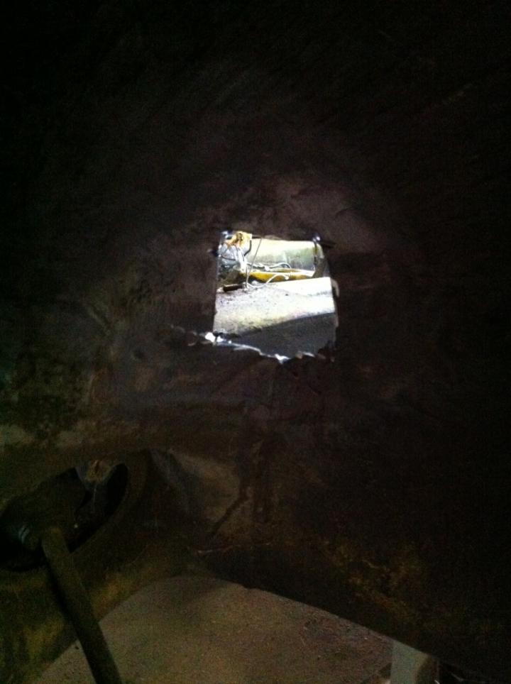

Here's one section cut out looking through from the front passenger wheel arch.

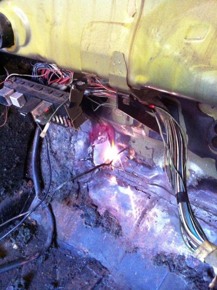

The man at work.
Welding the new steel in place.
The sections for the firewall cut out.

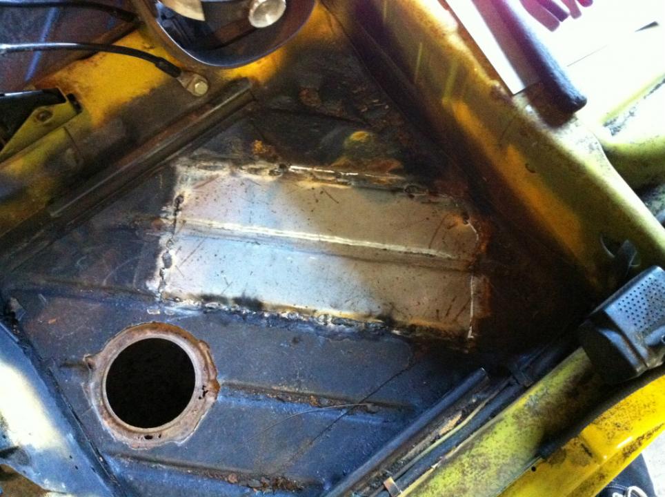

And new steel welded in.
Progress shot of the new floor piece.

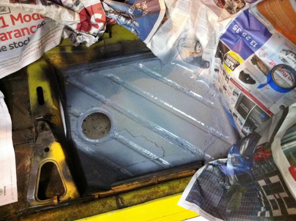

And how it ended up looking

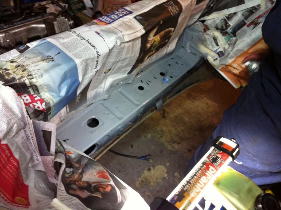

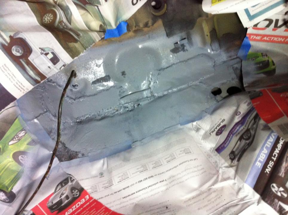

Single coat of etch primer on these spots.
We've left it masked up like this overnight so we can do another coat if necessary and put some black paint over that.
We also masked up and painted the radiator support in the engine bay as it had a bit of surface rust developing.

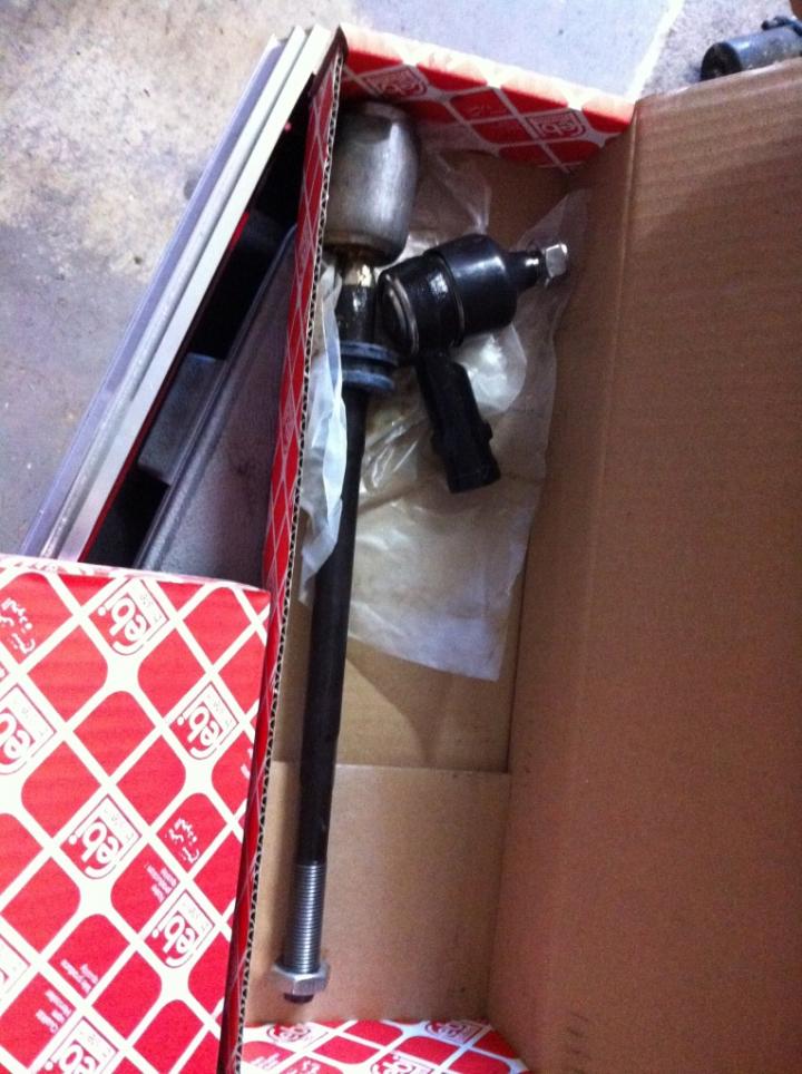

These arrived as well. New tie rods and rack ends. Boots are in the mail.

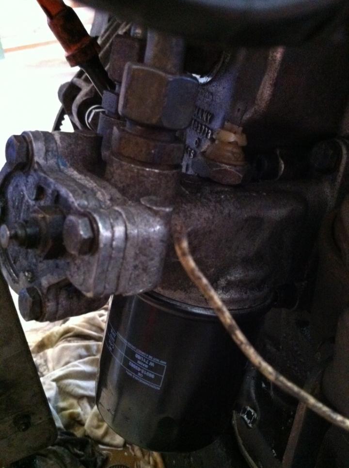

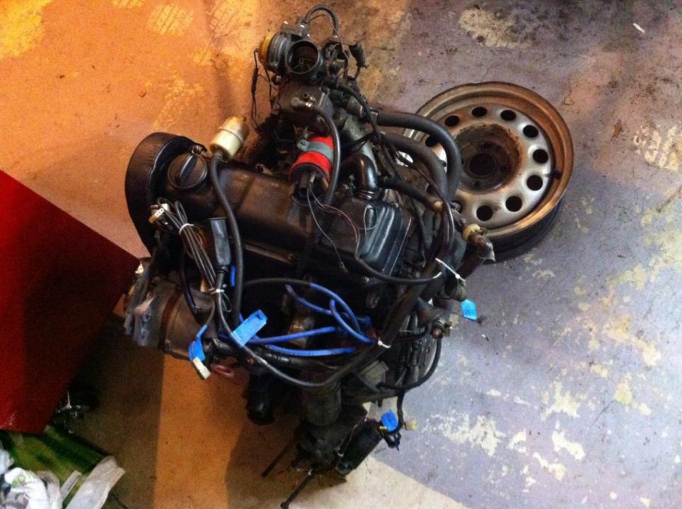

Does anyone know whether the little spade terminal in this shot is for oil pressure or oil temperature?

That's a temp sender, probably suit a VDO gauge.79 MK1 Golf Wreck to Race / 79 MK1 Golf The Red Thread / 76 MK1 Golf Kamei Race Car
