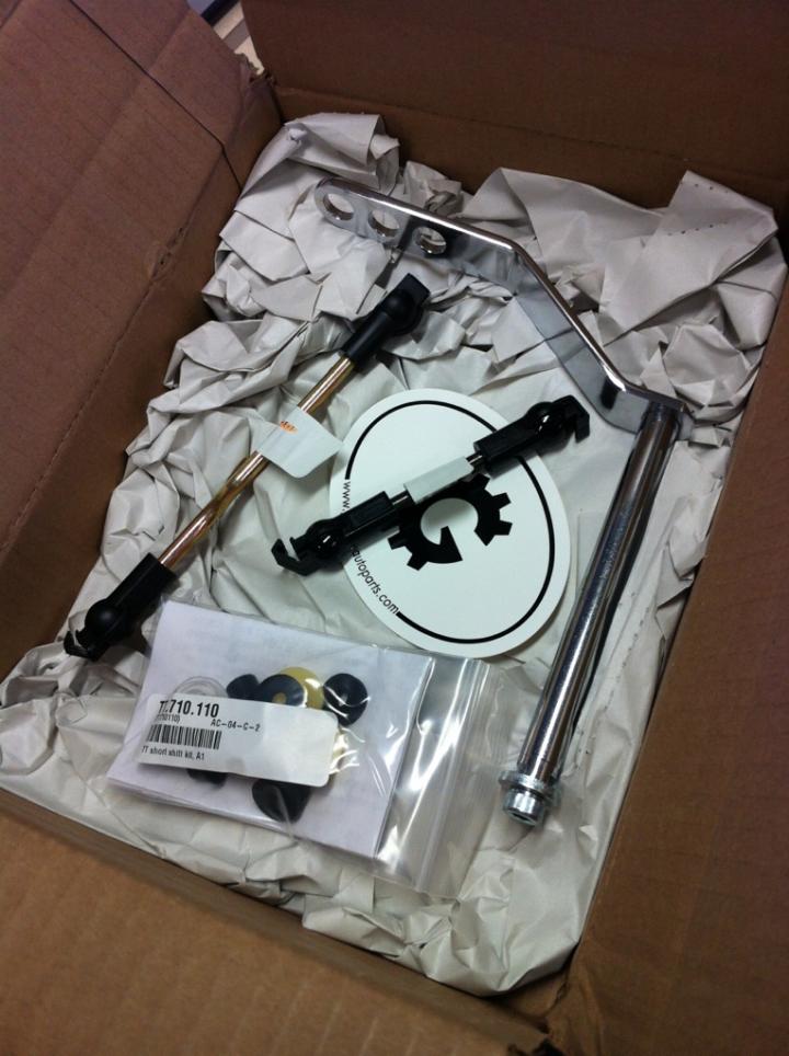

Got bits from America today.
Short shifter and short linkage rods so that I can actually select fifth gear. Keen to fit them up.

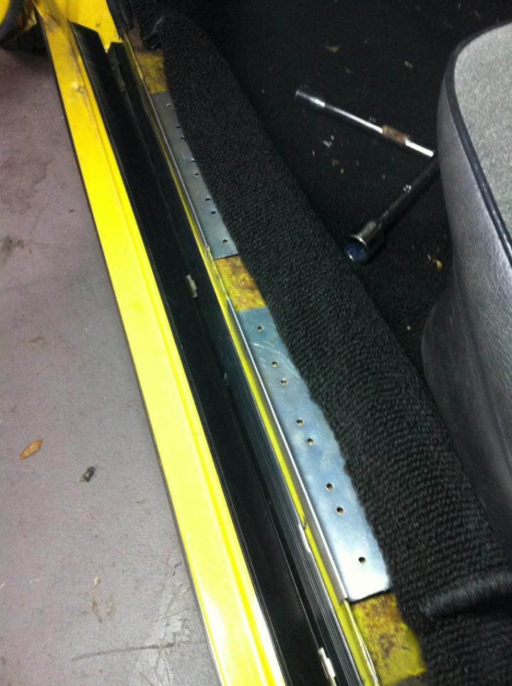

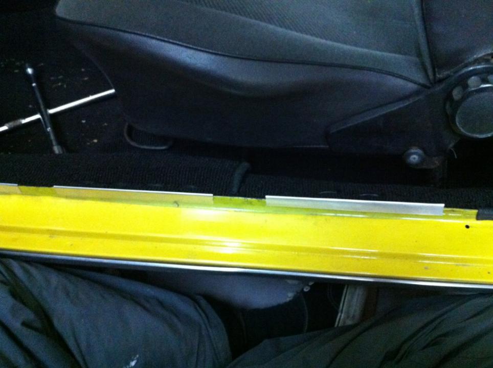

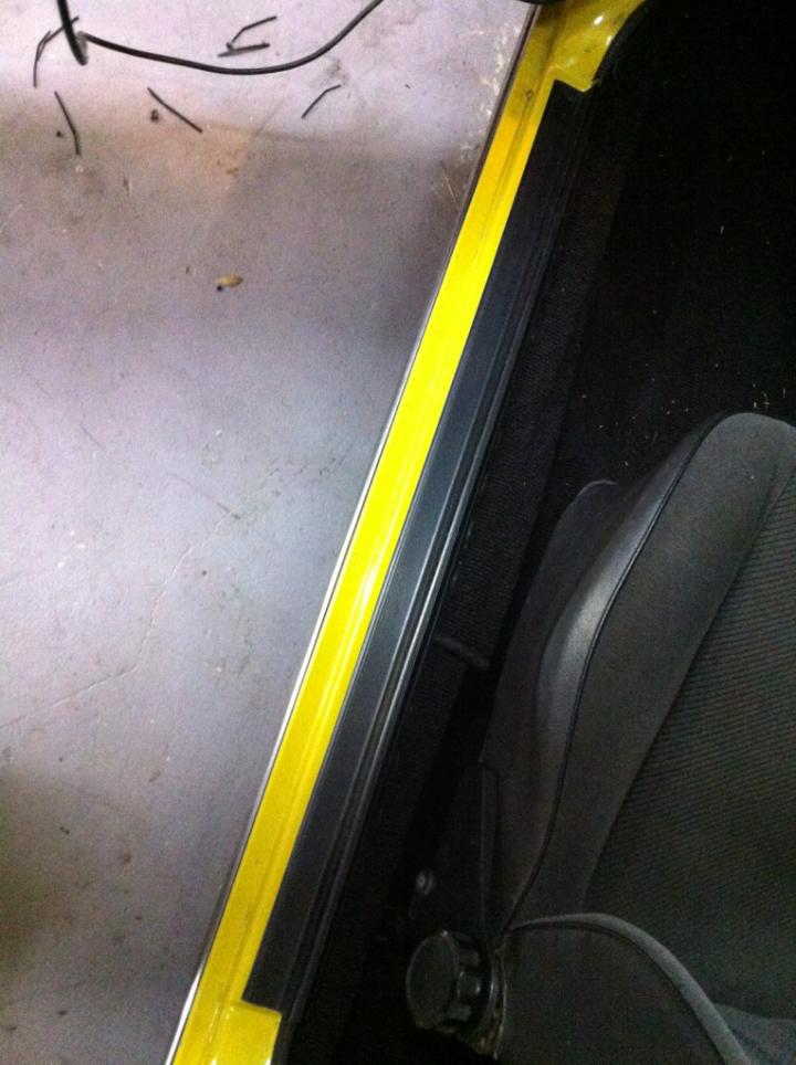

Here's a couple of photos to show what I did with the carpet. It's aftermarket carpet and not a perfect fit. The edges wouldn't stay under the side strips so I had to come up with a way to secure them.
What we did was bend up three of these little alloy pieces per side, and drill holes in them to accept cable ties. I used a leather punch to make small holes in the carpet and threaded the cable ties through both.
That held the carpet up against the edge of the floor, and the gaps between the alloy were big enough to allow the clips for the side strip to fit in between them.
The plastic strip clipped on over the top, and (almost) hid all the ties. I should've drilled the holes slightly closer to the edge, but it's barely noticeable. If I get inspired I'll re-do it one day.
