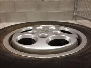

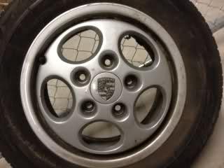

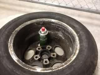

                    Here are some pictures of the wheels. If they are et53 and I add a 20 mm spacer then they will be et33 right? I that how it works? Aren't there positive and negative offsets too? Whats the difference?
                    As you can see the hub mounts are really close to the front of the wheel. This means it is less likely to poke out of the rim and more likely to rub on the coilovers or whatever suspension is in there. Does that sound right? How do I make these effing things fit?

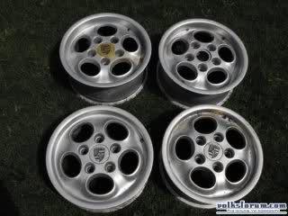

                    Also, what do you guys think of the flat face version of these things? I thought I had the curved ones like the ones below but appaently not, I like these way more than I thought!
