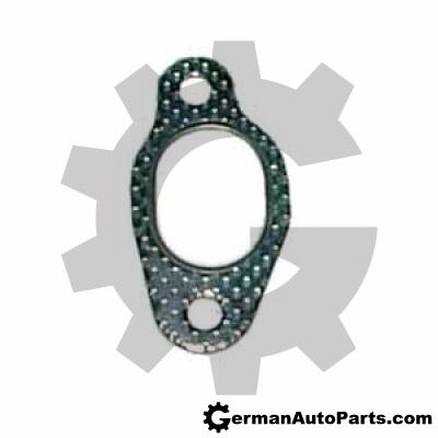

    Does a mk1 need a manifold to exhaust gasket or just bolt straight on??

    should use a generic 3 bolt flange gasket near the steering rack assuming you have the stock exhaust, i find using a sealant like Maniseal works awesome

      ah yes i have that, what about manifold to engine block? thanks

        Needs 4 gaskets. Like this.

                I just used that pic to show what they look like.
