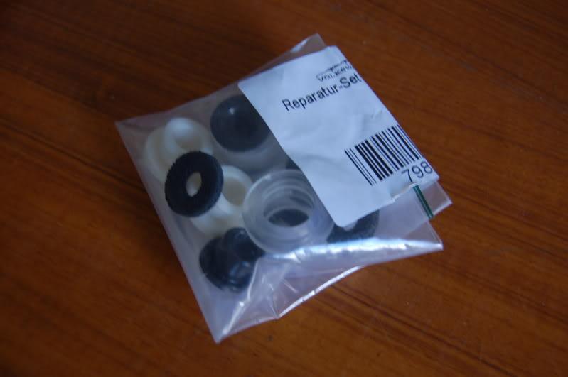

            Is the car OG 4-speed? I have a brand new set of bushes, yours for $20 posted. It's a basic kit but will fix up major slop.

                The bits in the bag are the same for 4 or five speed linkages.
                What's different is the length of the rods with the ball socket ends on them.
