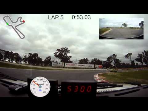

            Here's some sample noises for motivation. MK1, 2.0L, twin 40mm Dellortos
