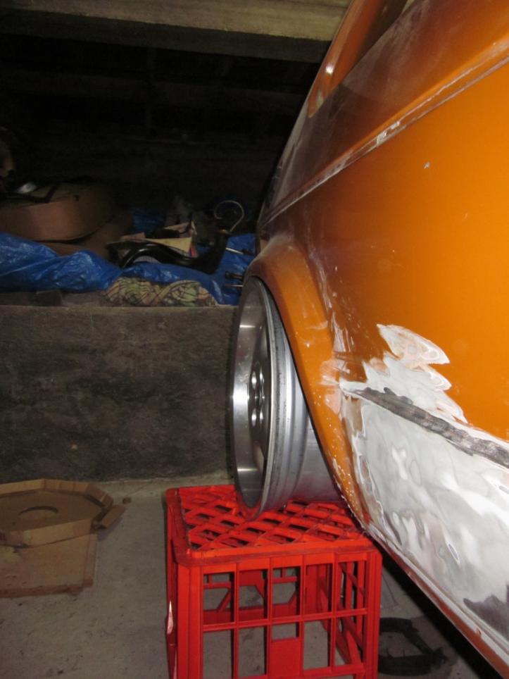

    Ahhh, the sister beast.... Like those wheels you have, Unfortunate the offset is out a little... *sigh*

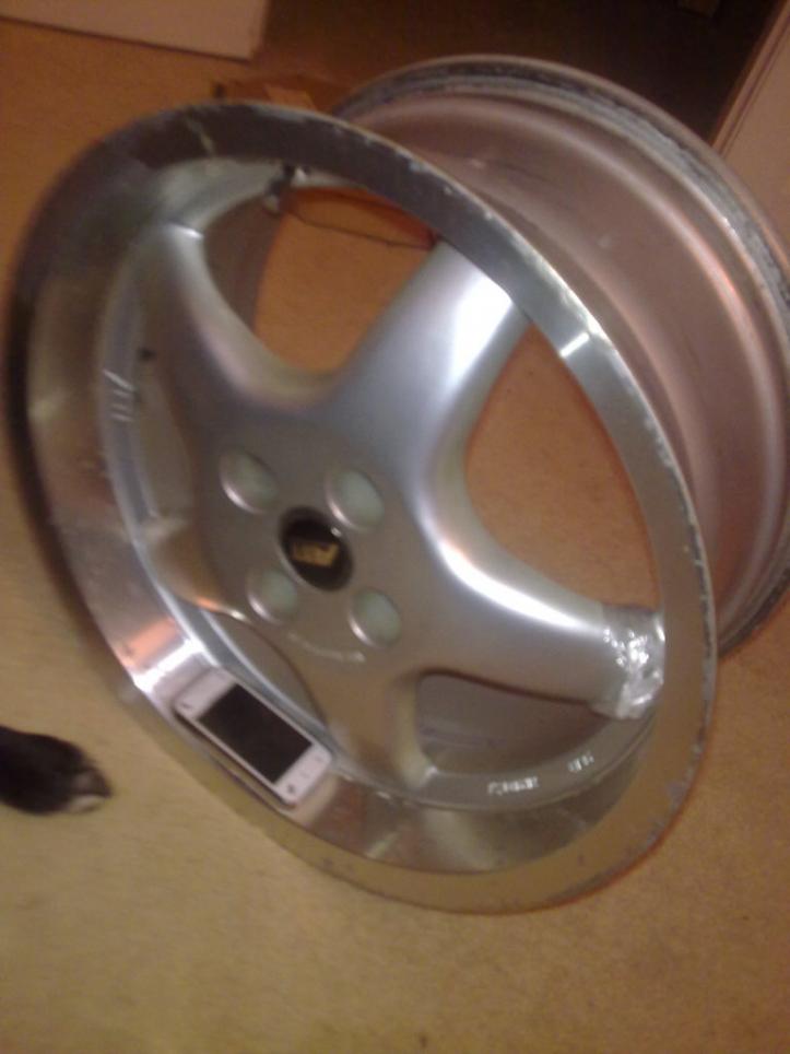

      ahh yes and a beautiful twin she is , yes i like the xxr2s but i wish they made them in et15 they only do 15x8 et0 so those have gone back onto my brothers ricebox sprinter,i have a nice set of polished ats type5's in 15x7.5 et25 that will be making there way from mk2 to mk1 as soon as paint is done , i have planned on redoing this ride years ago when i owned it the first time glad i have it back i tell you lots of love going into her and a promise it'll never leave my possesion again , as for parts i will be very keen for a few bits and peices i'll drop over and have a chat .

        i was playing around with my gf's 16x7.5 et35 abt's god i wish they were smaller 15's or even 14's damn i love poke

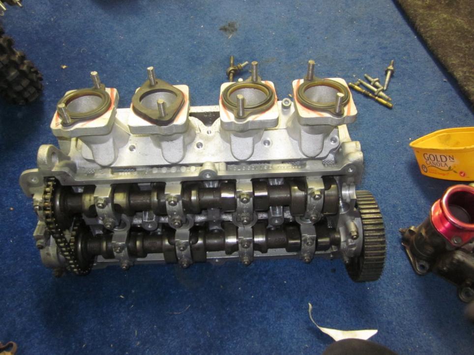

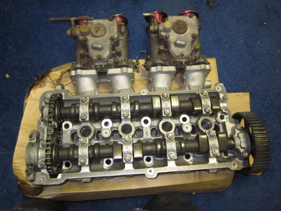

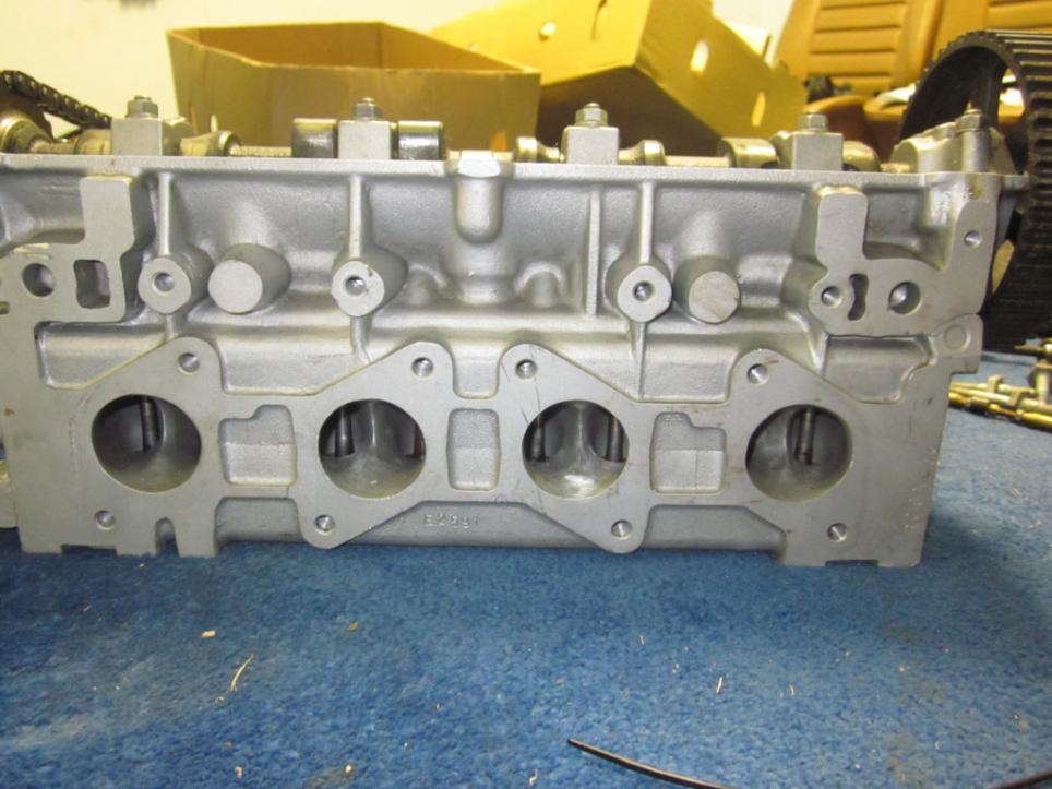

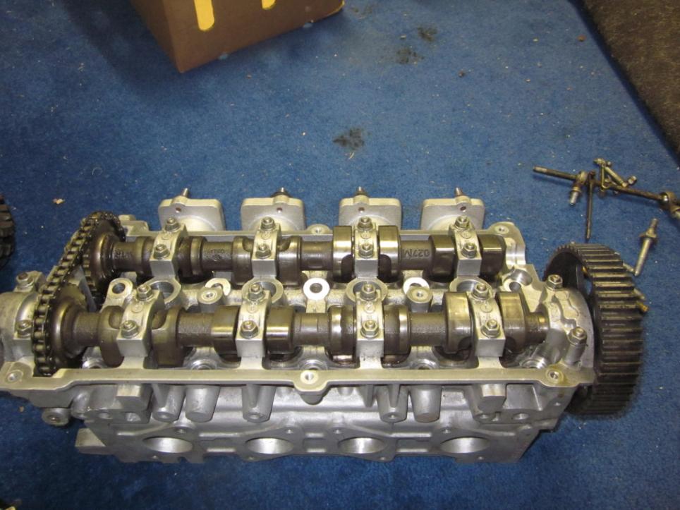

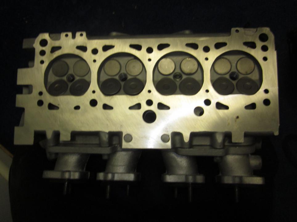

            mk1 engine porn update engine being bored and built budjet blown !
            16v kr race head flowed for well over 2.0ltr
            good for a proven 200hp @ flywheel on 40mm carbs on a mach ported ottinger long manifold and kr efi cams using a 1.8 botttom end i have mine in being bored to 2lt using hi comp piston 11:1 using standard 16v kr crank and rods
            soon to come maybe Quad throttle bodys

              Nice work, There's not enough 16v action around here!

                Wow.. That's beautiful!!
                And it's not even together yet

                  Some nice looking head work, the roar of a 16v on carbs is great!

                    should be together in a few months , just waiting on the botom end machining and the 2ltr pistons to arrive !

                      Motor from Ed C? Very nice bit of kit!
