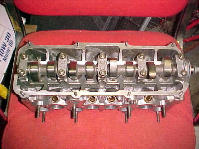

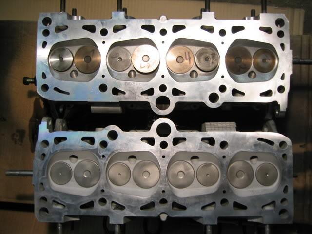

          here is a couple pics
          note the larger valve sizing

            This is the best thread on here, tell us more

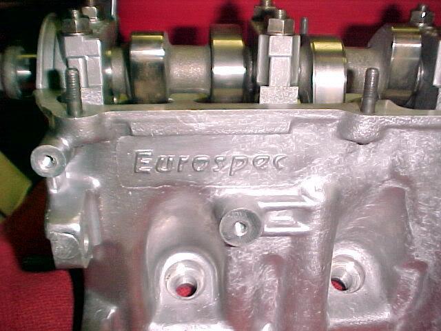

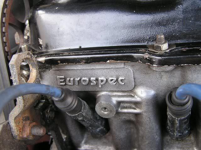

            • #36
              the eurospec 8v head was a custom cast ,The Eurospec heads have extra metal cast in reinforcing the area surrounding the lifter bores. This makes it possible to run larger diameter lifters, and hence much higher lift cams.) The water passages were redesigned so it wouldn't be breached if you went with the largest valves you can find and had wider opening along it's route for higher coolant volume flow.
              The lifter bores were shaved properly so it would hold up from cracks and accommodate the tallest cam configuration.

                  dang there big valves
                  (drooling on my keboard again)
