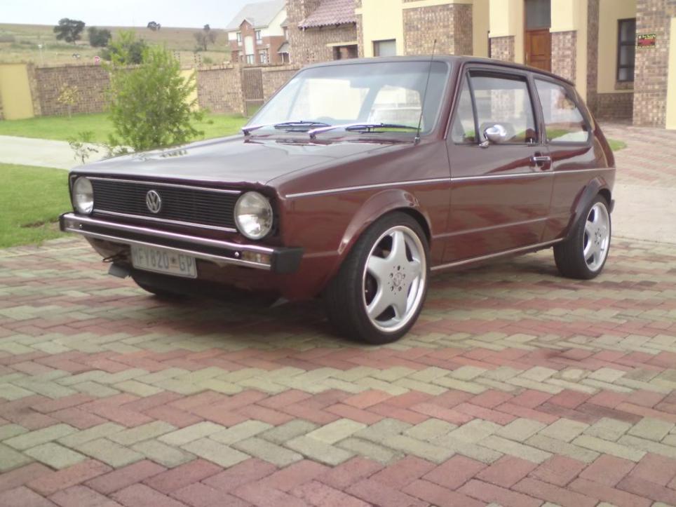

    Hey there gents.

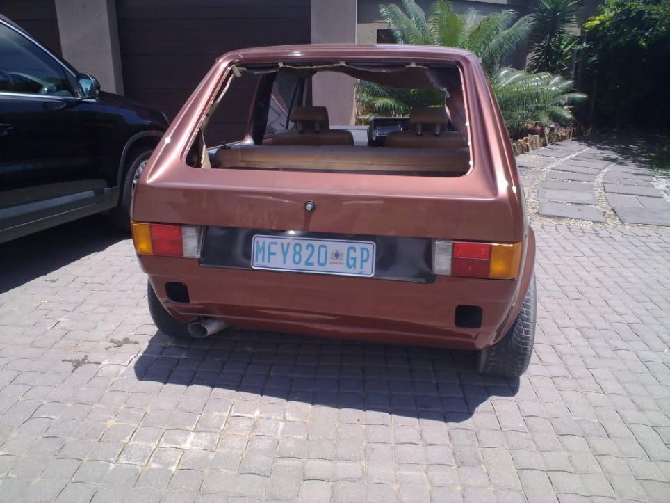

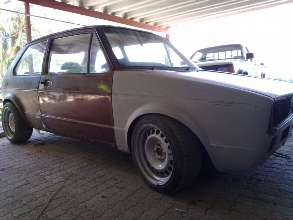

    I bought a mk1 last February 2010, decided to rebuilt her.

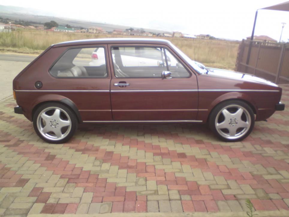

    Here is some pics when I bought her. She had some bumps and bruises but I soon started to add my own touches.

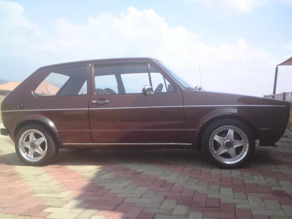

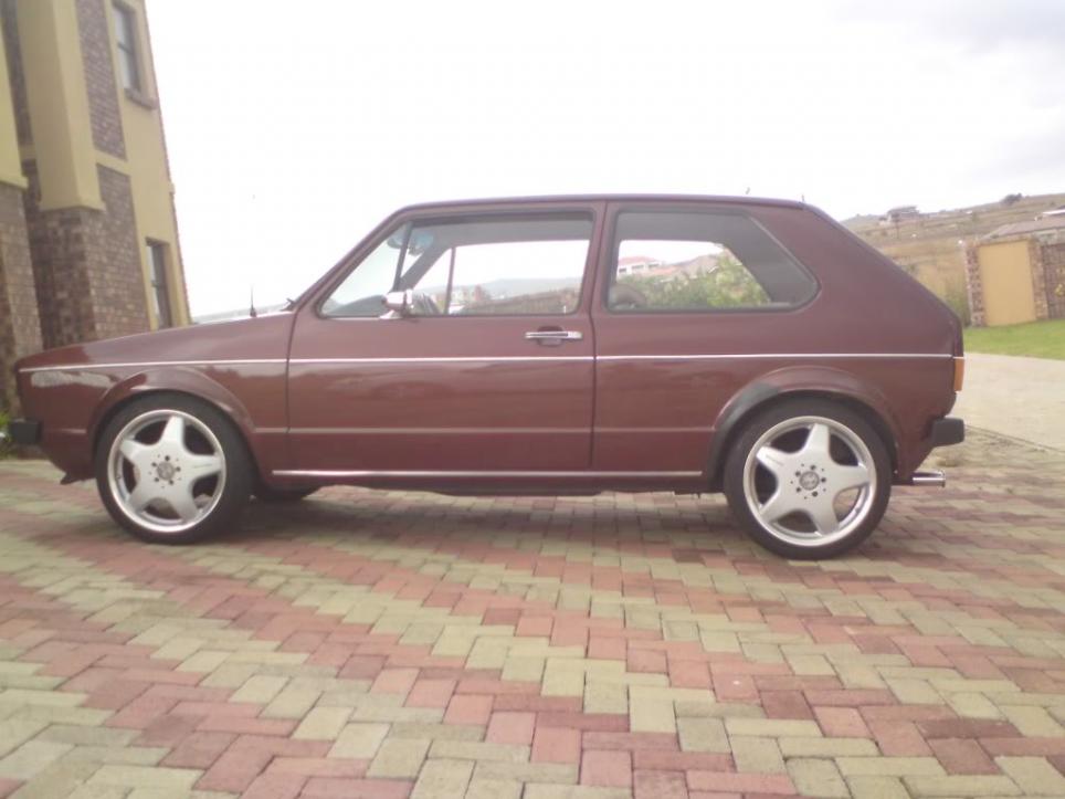

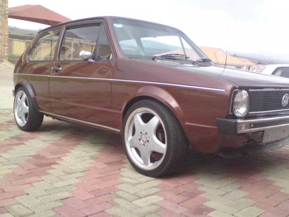

    I then fitted 15" Work splits.
    Here is a pic when she made cover on one of our local vdub magazines.

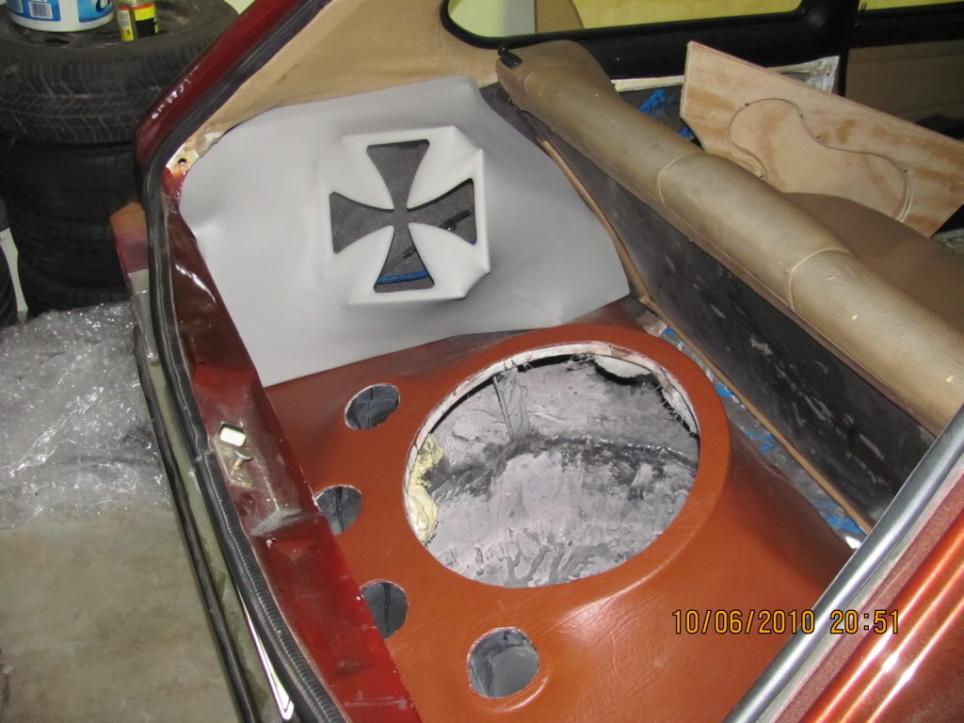

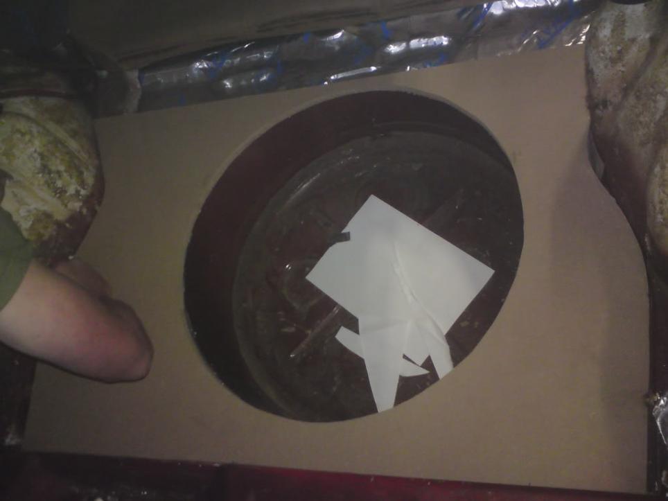

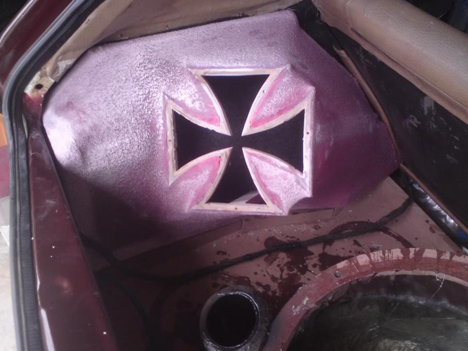

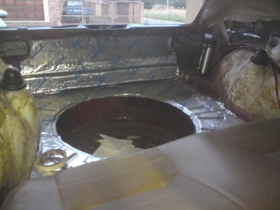

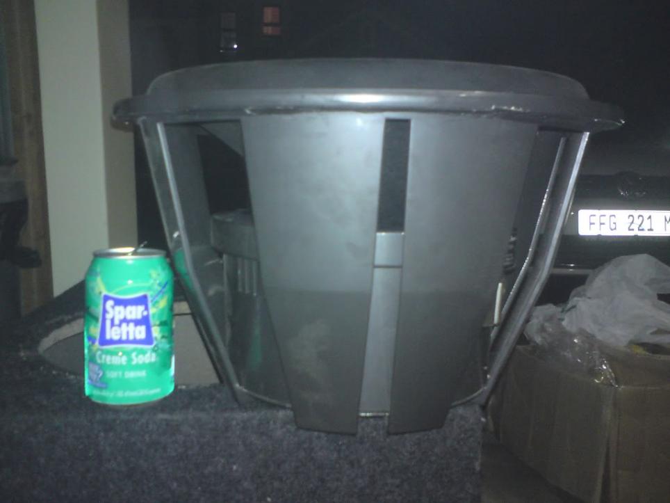

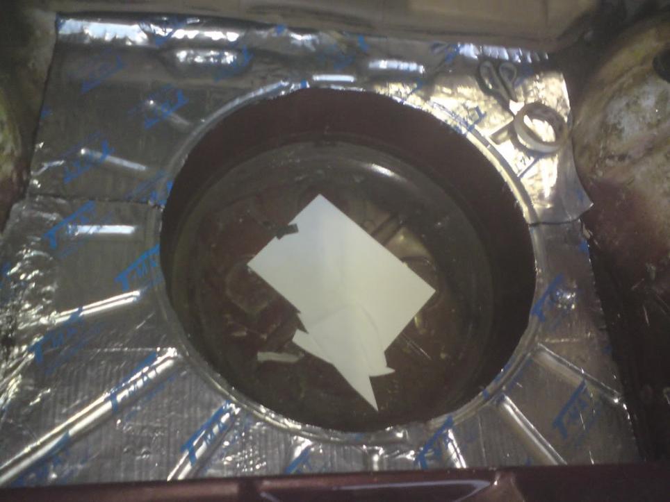

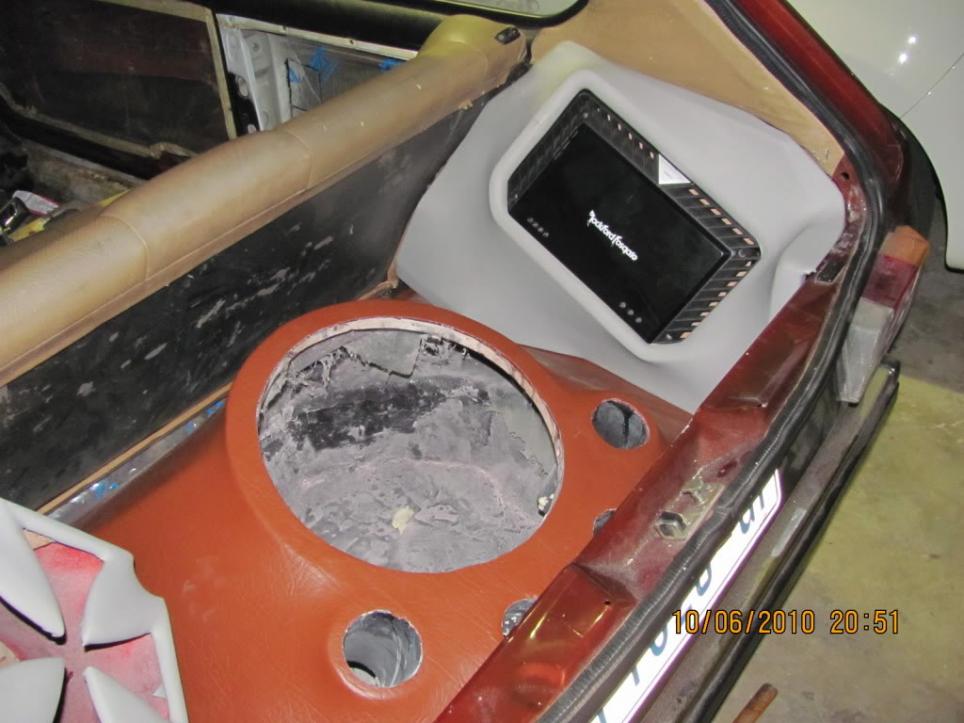

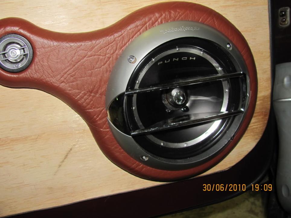

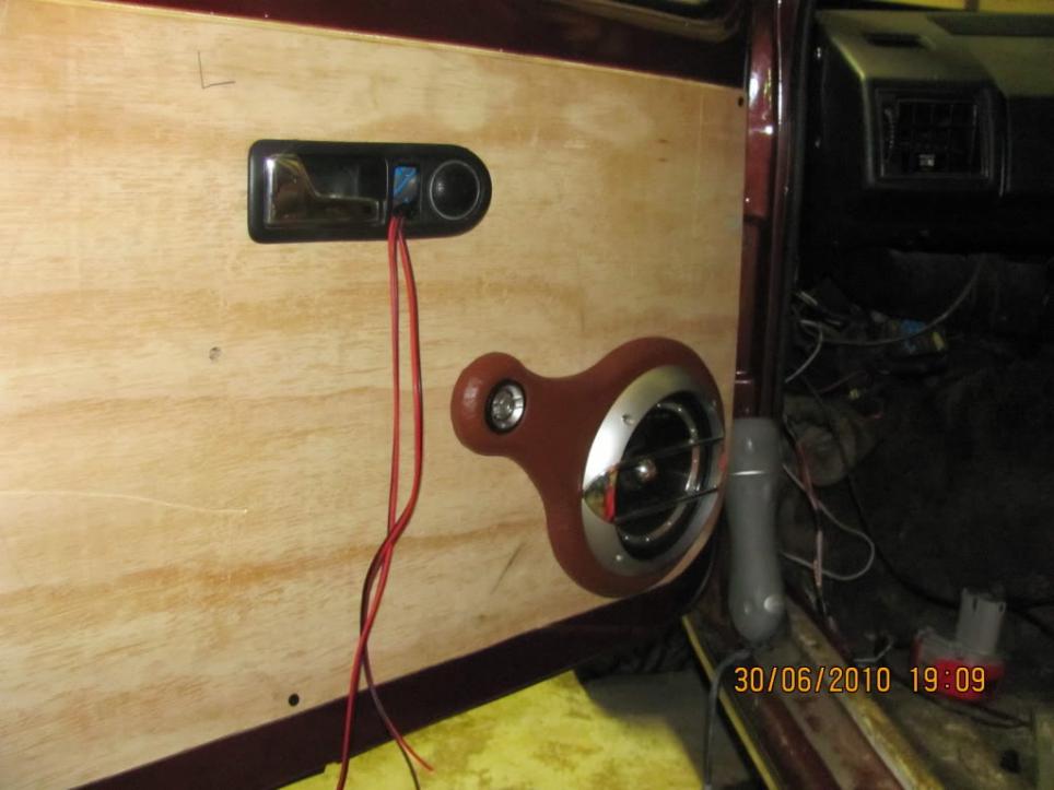

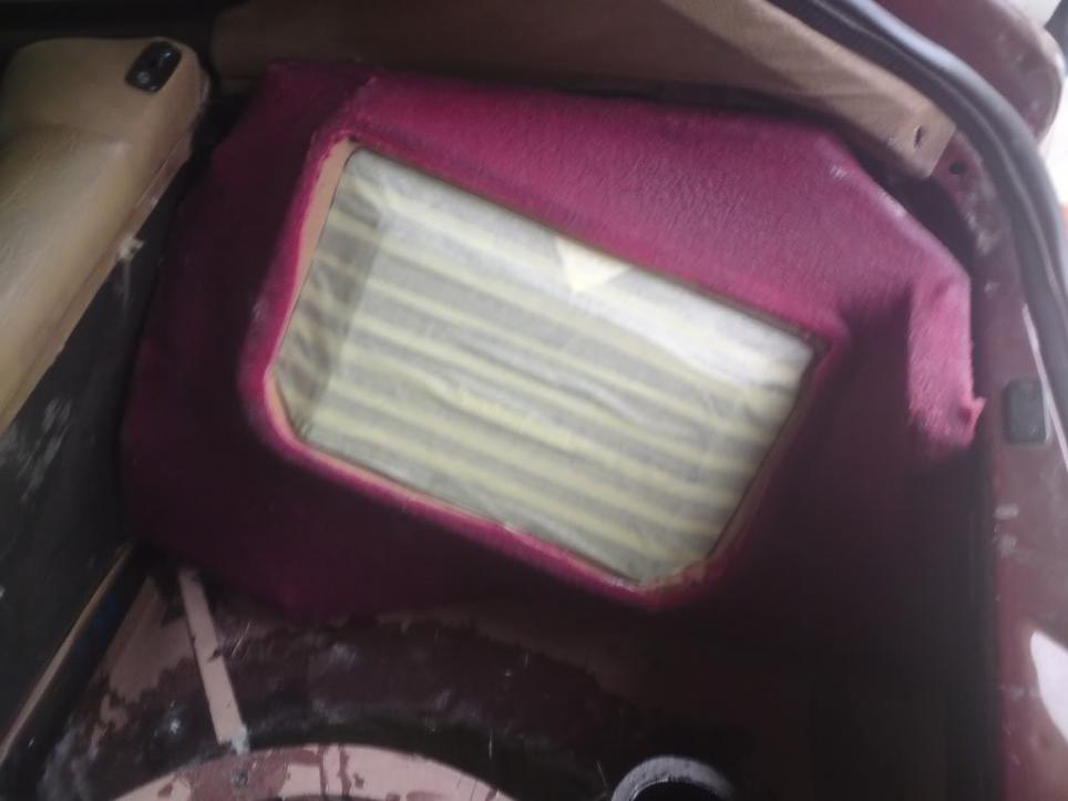

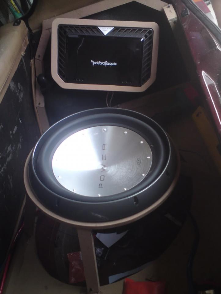

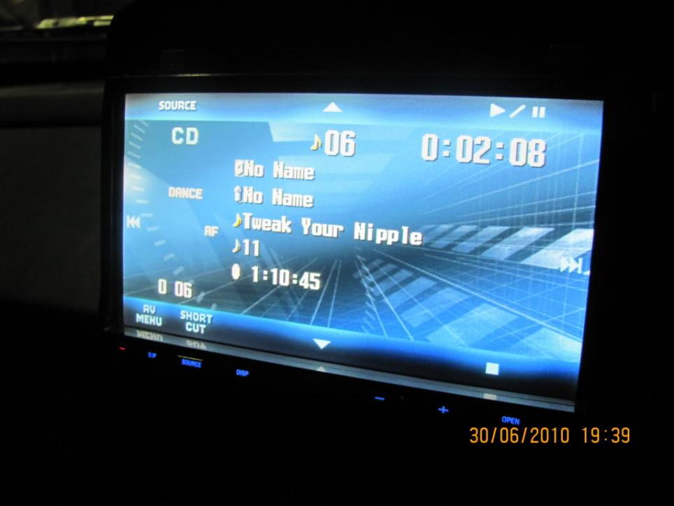

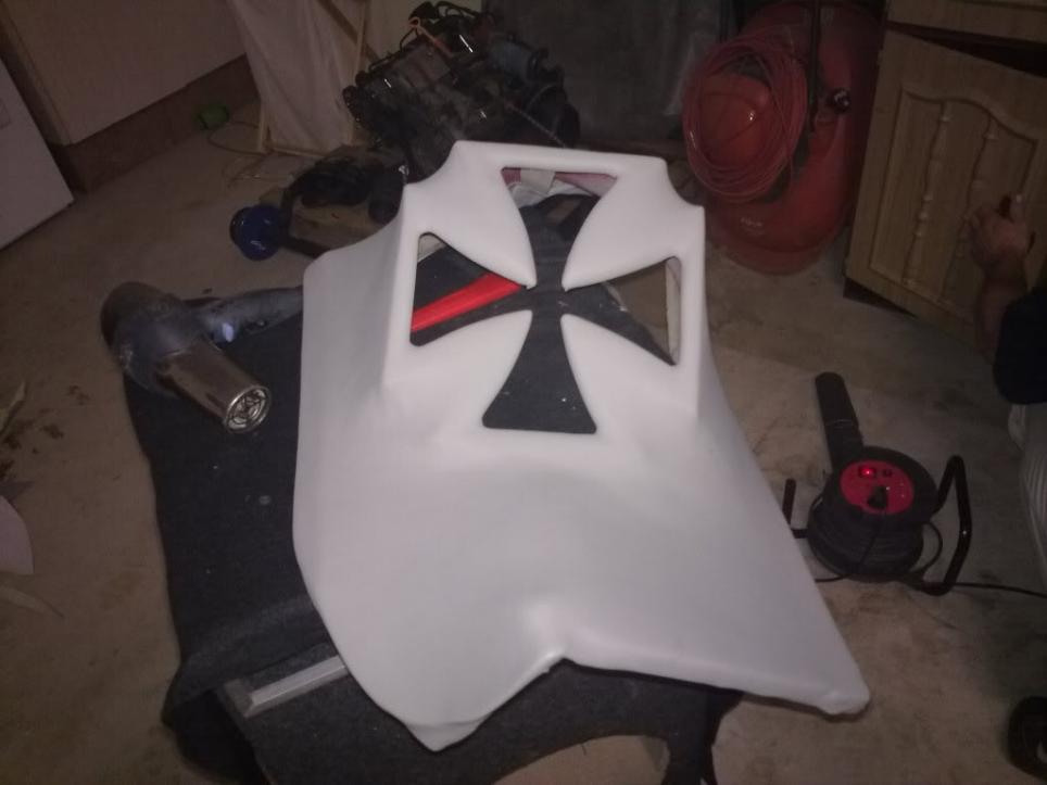

      I then attempted to create a nice looking ICE install.
        Still attempting.

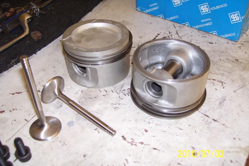

          83.5mm Pistons

          35mm Stainless exhaust valves

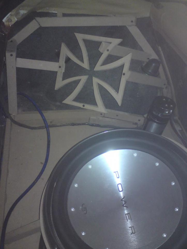

            Here I was nearly done with the ICE before I scrapped the idea of having ICE in the car.

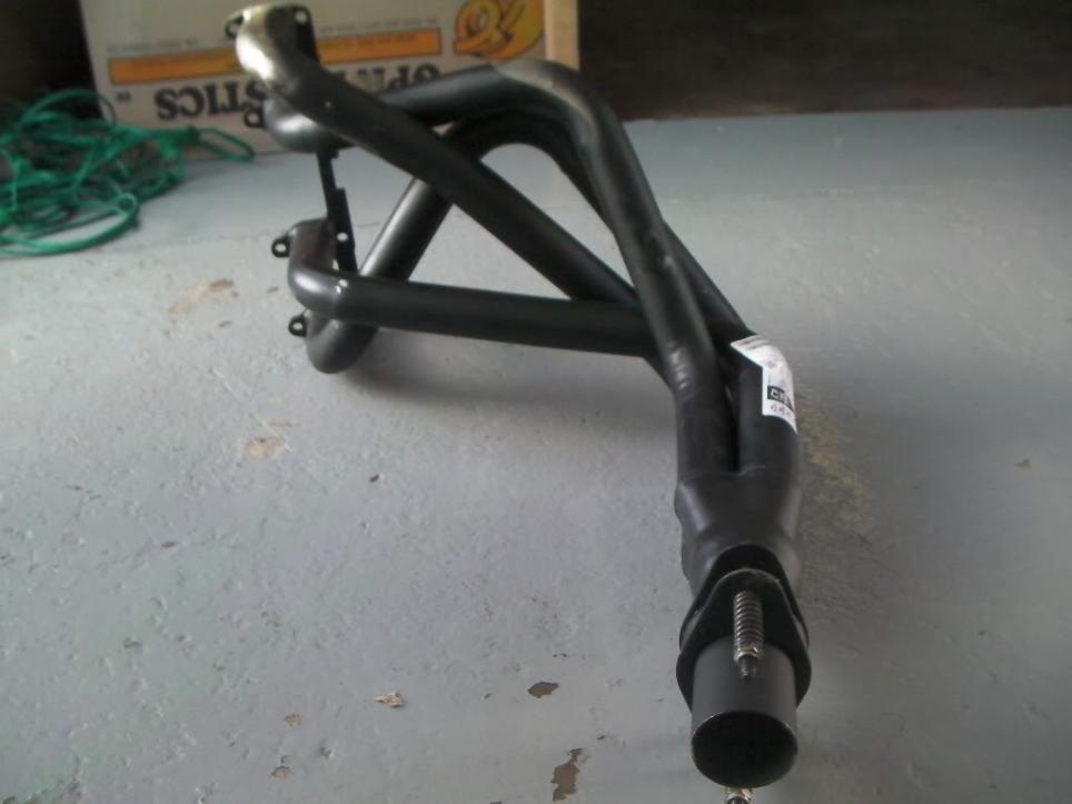

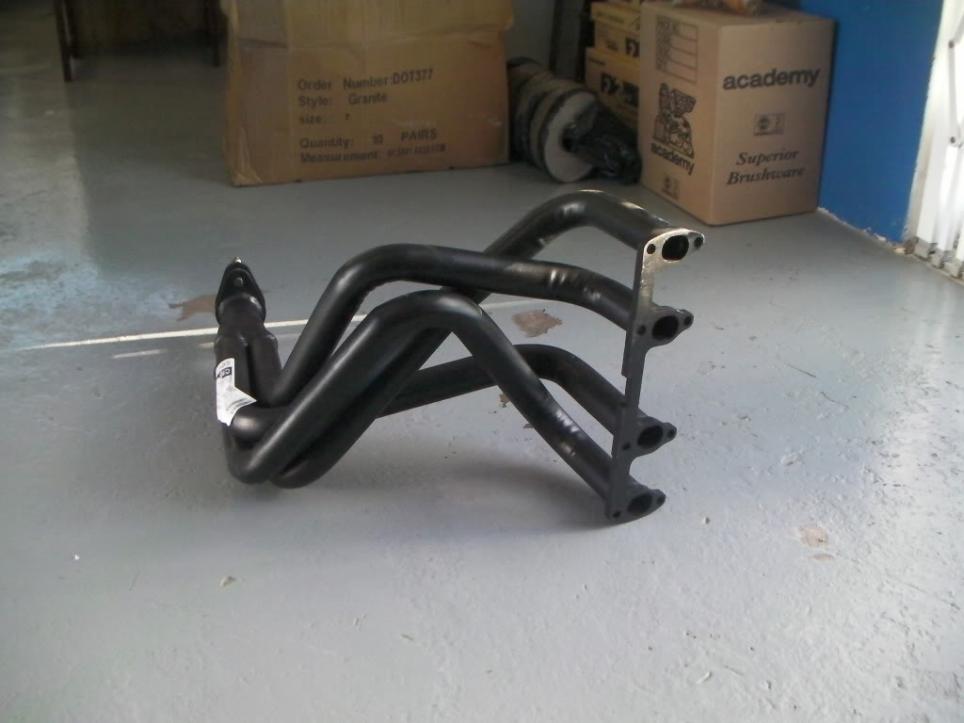

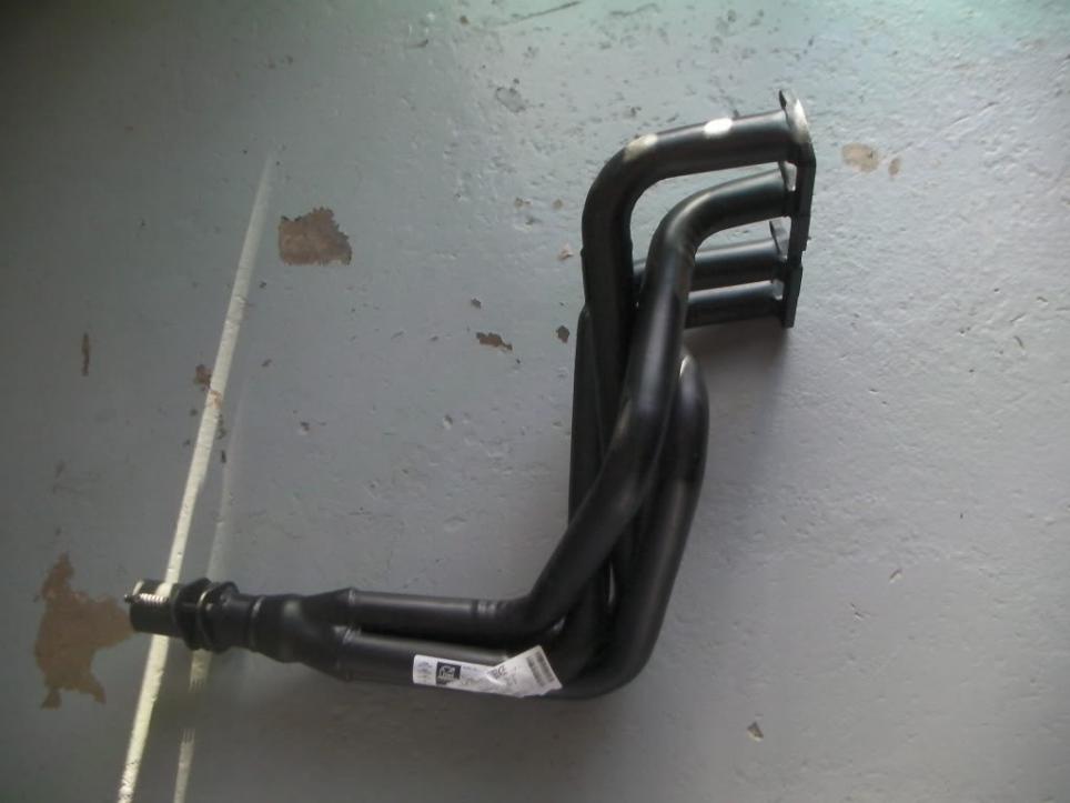

              My exhaust branch for the new motor.
                Pics of the motor rebuild.

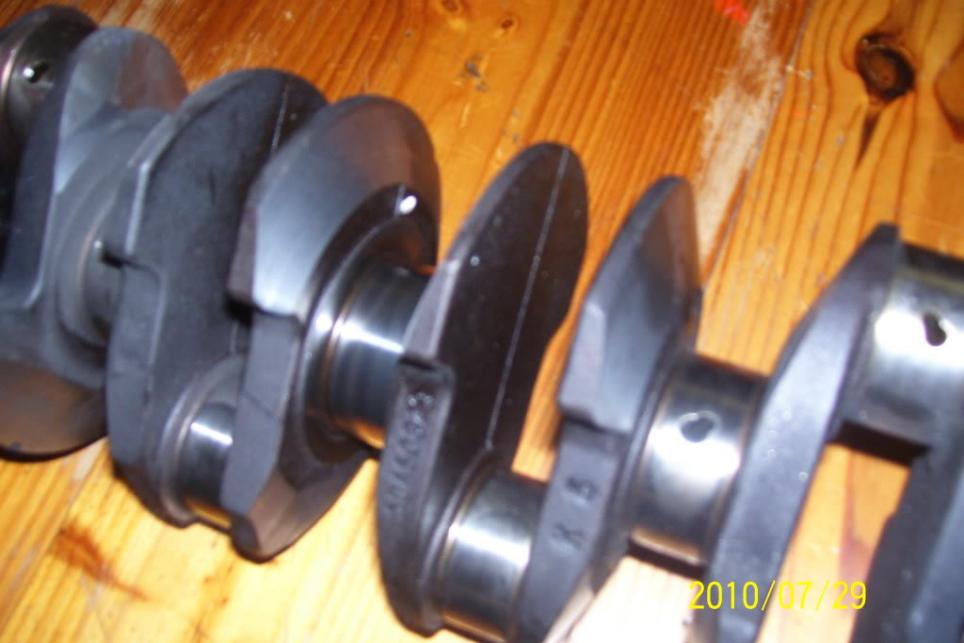

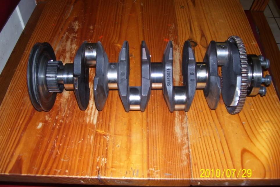

                Crank

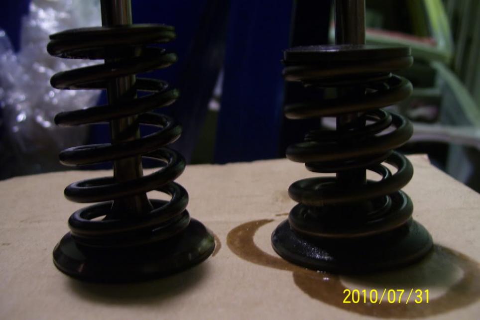

                Double valve springs fitted - left is standard, right is the double.

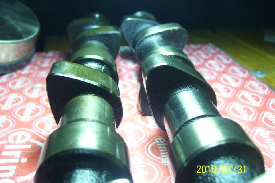

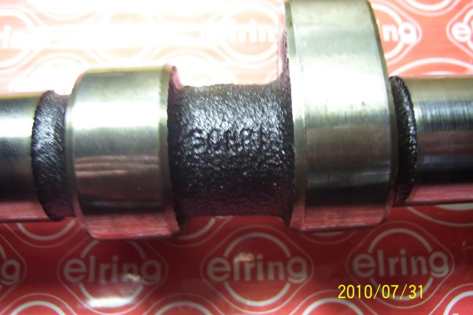

                The Schrick
                Standard cam left. Schrick 288 on the right

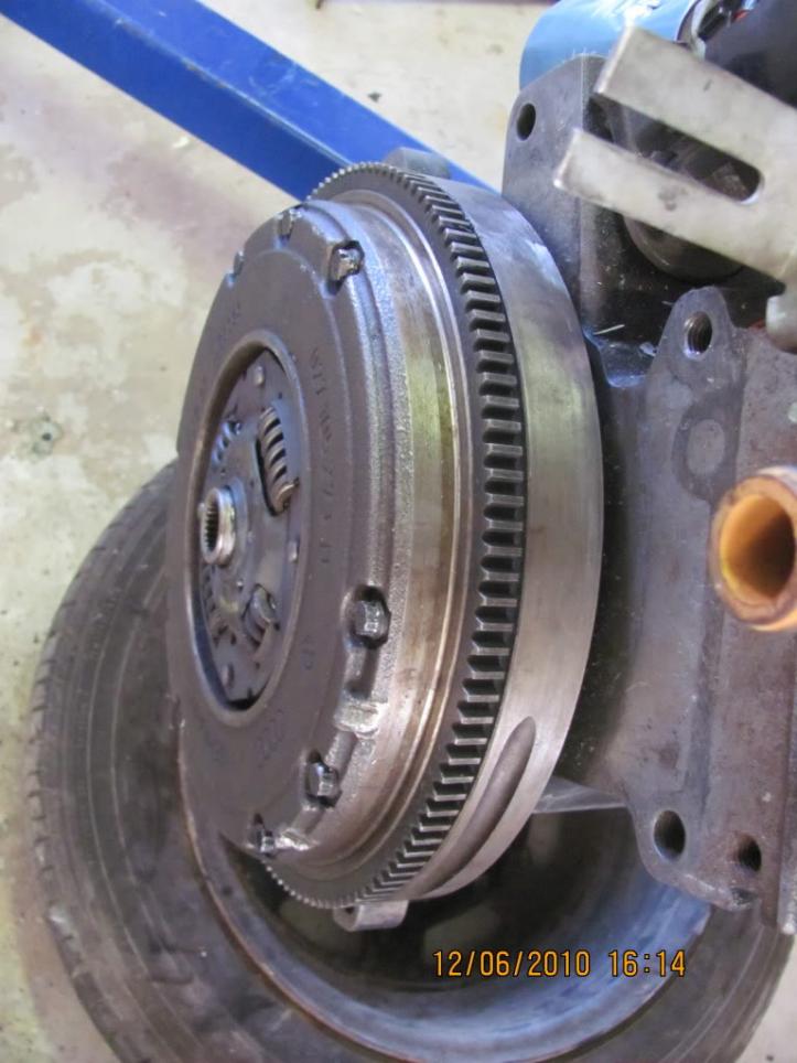

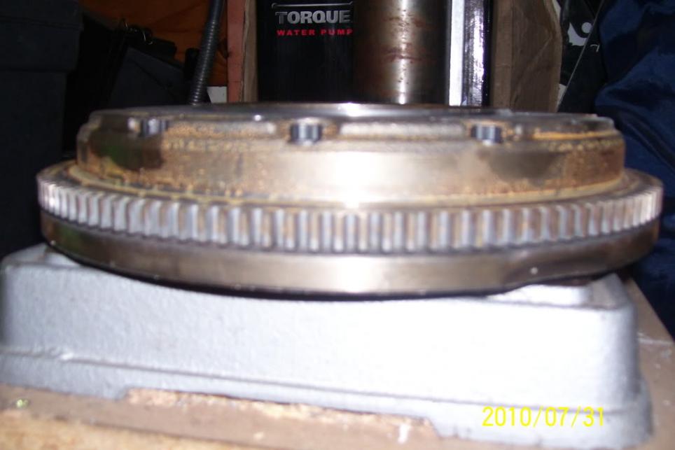

                Flywheel before and after
                KS 83mm pistons, all parts used is KS.

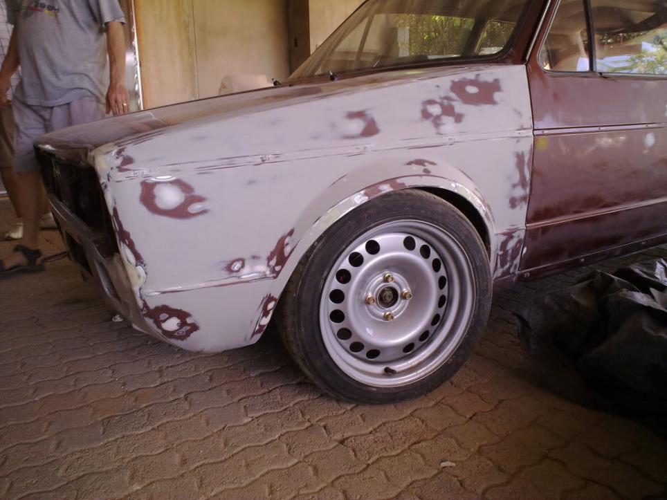

                  I then fitted Koni coilovers and a set of 7.5j front and 8.5j rear steelies.

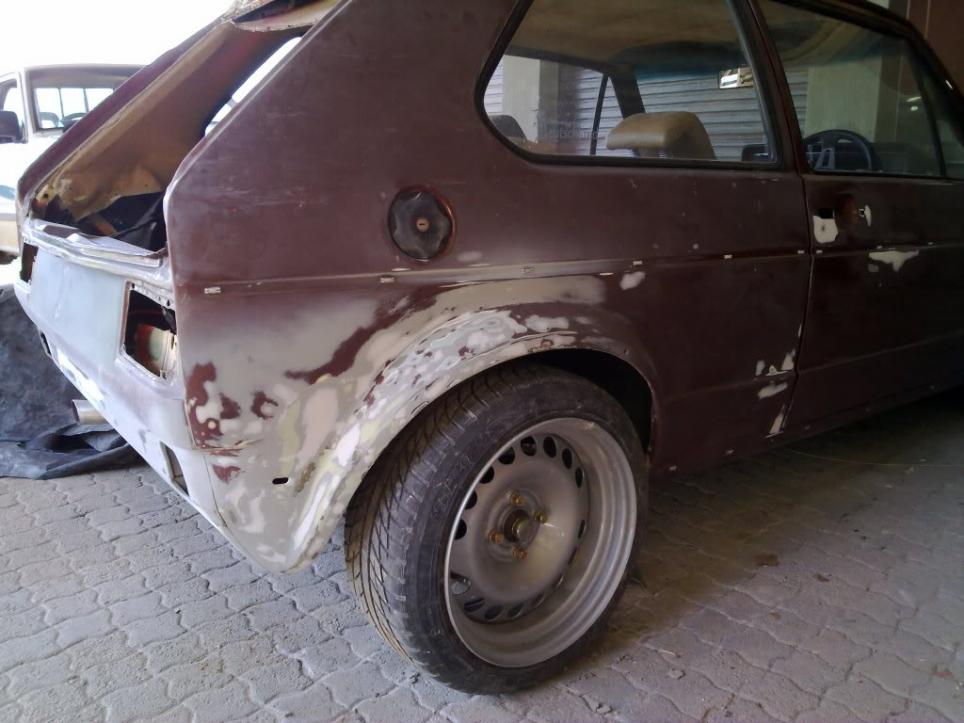

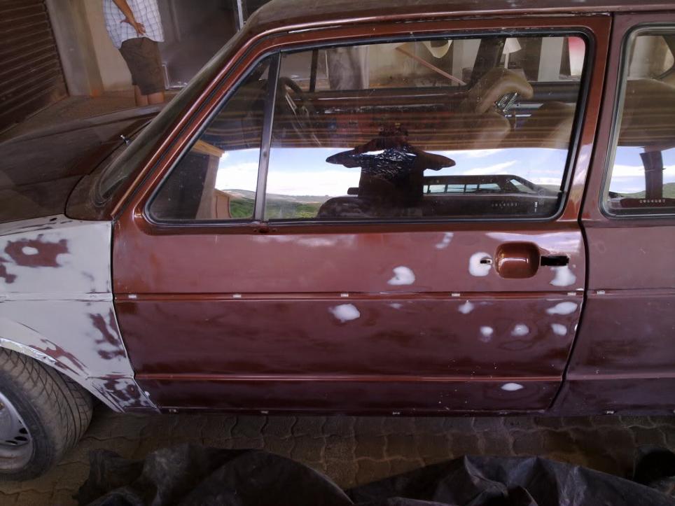

                  Here is before I sent her for a respray.
                  Click on the pic to make it larger.

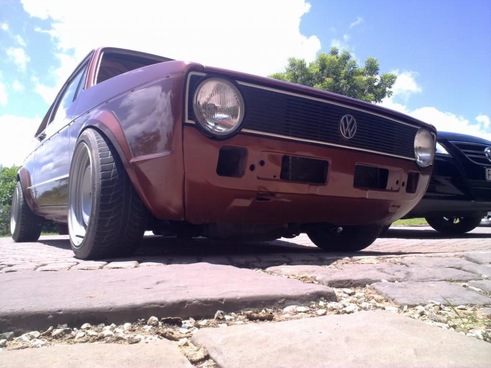

                  Without the front bumper and spoiler.
                  I love the 8.5j rear.
                  Look how low my sump is.
                  The engine, must still tidy everything up.

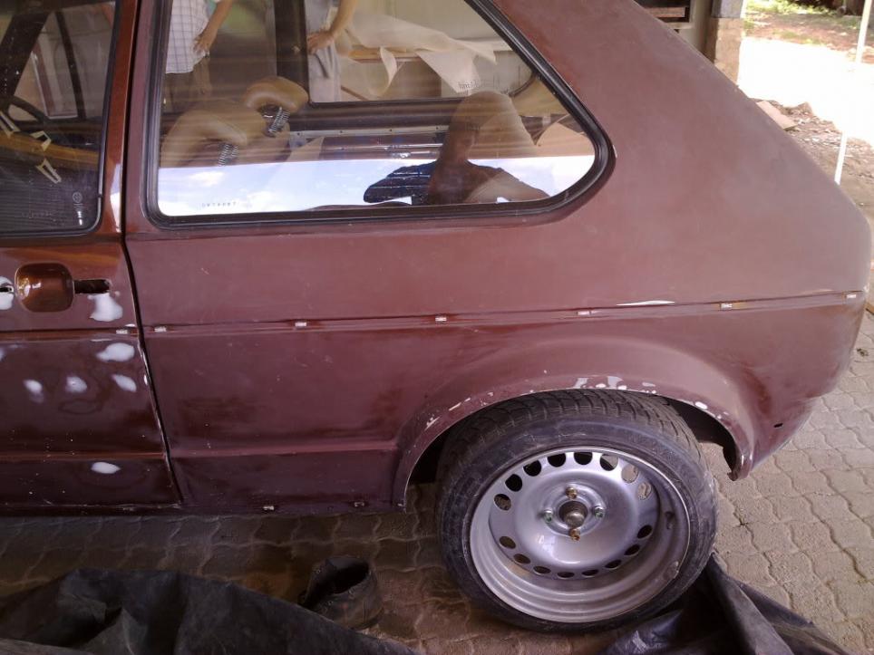

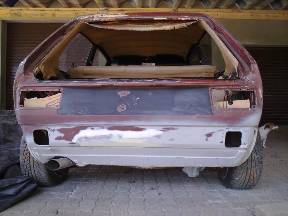

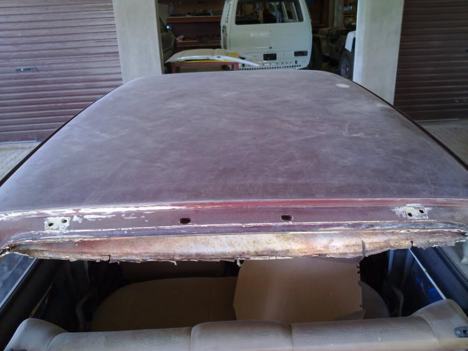

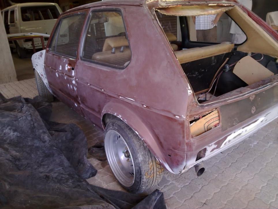

                    Prepping for the respray.

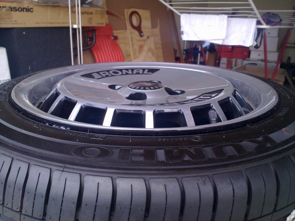

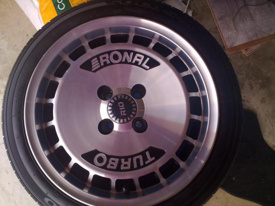

                      I finally got my brand new Ronal Turbos. They are 7j et 28. Fitted with brand new 175/50/15 Kumho
                      tyres.

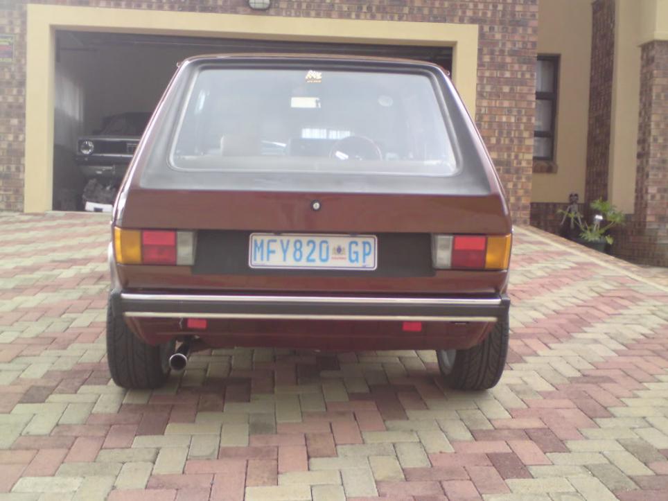

                        Here is pics of the respray before I sent her in to the interior retrimmers.
                        She still needs the polishes, and the black at my rear number plate must get colour coded still,
                        I'm not a fan of the black.

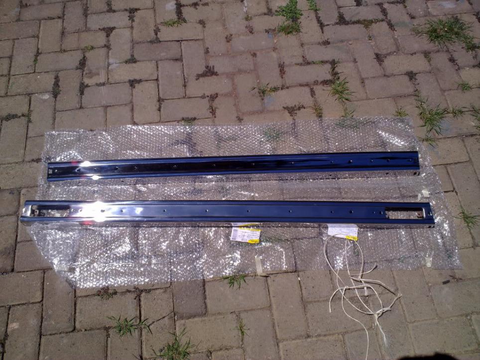

                          Got my bumpers rechromed.

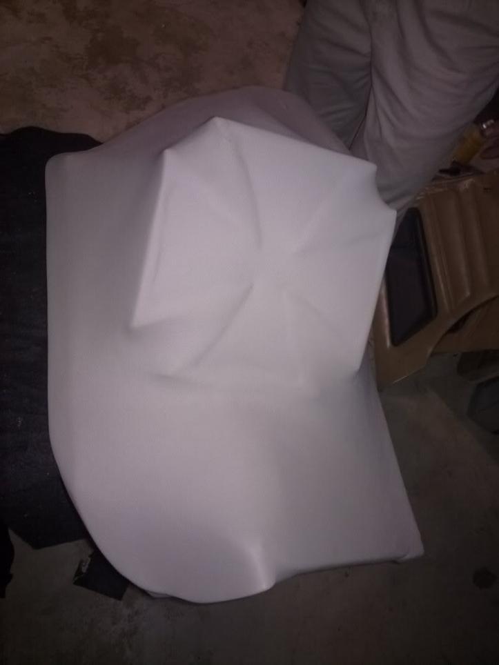

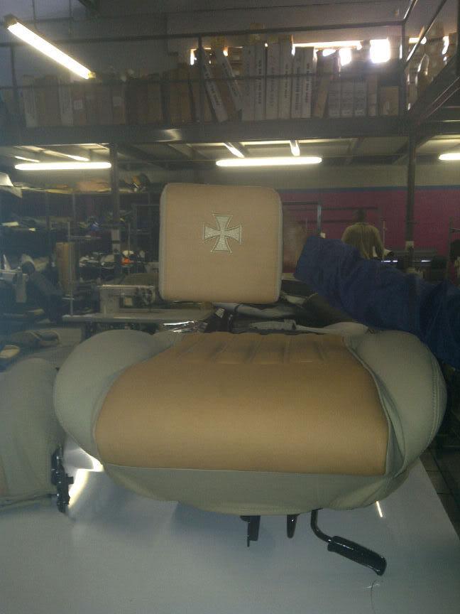

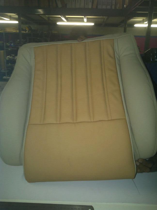

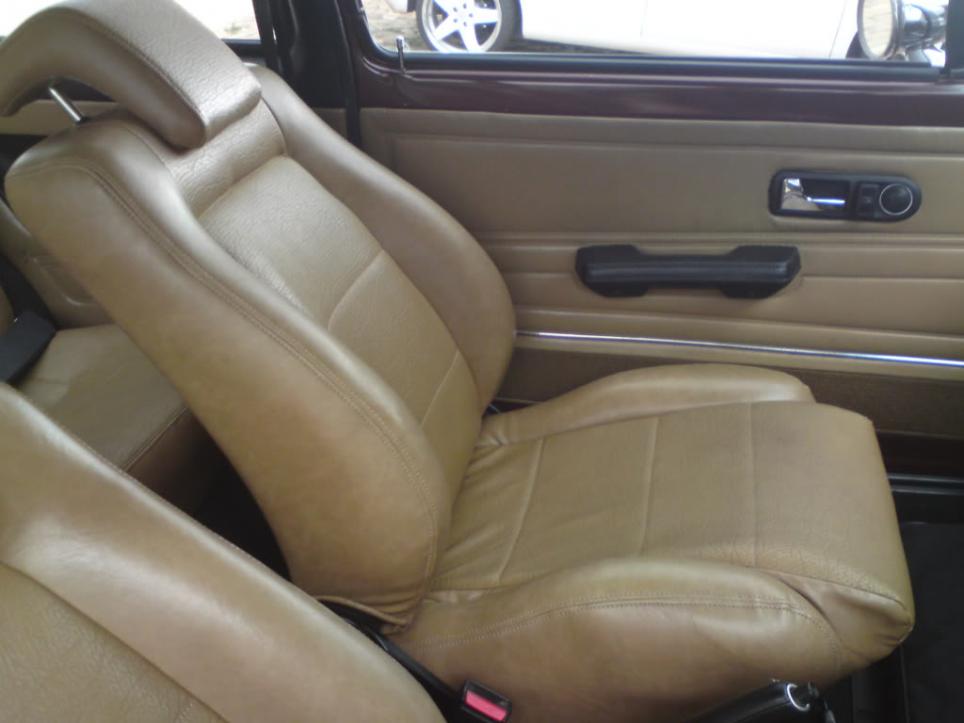

                            The colours that I'm going for inside the mk1.
                              Thats where I am today.
                              Waiting to get her back from the retrimmers and then fit the ronals, give her the final polishes and assemble all the little things.
