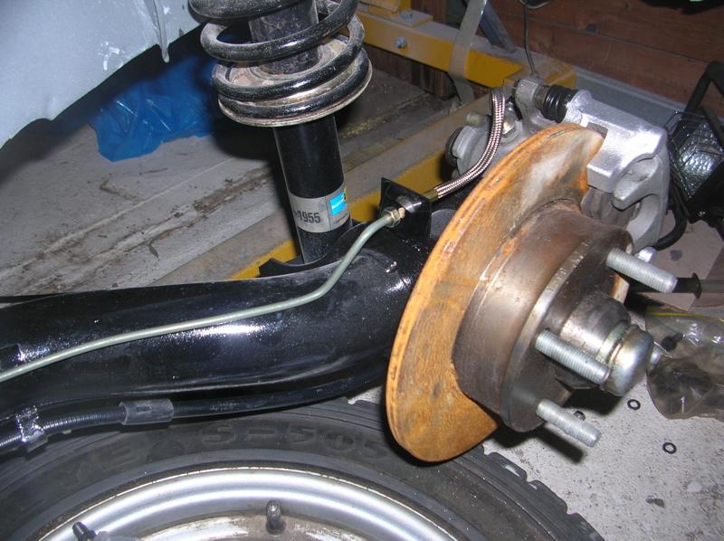

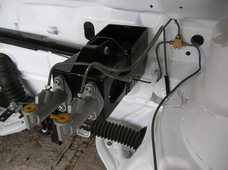

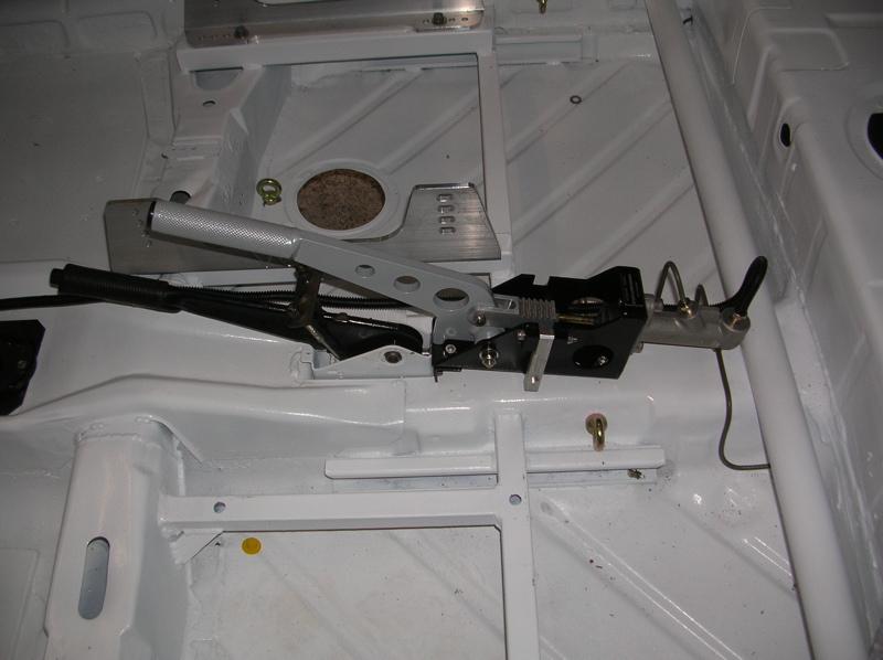

              I failed my first rego is inspection with "non-ADR" lines (from Bildon Motorsport in the states) fitted to the Zebra Rally Golf. My mistake/ignorance, no criticism of the inspectors intended. They gave me the option of replacing with ADR lines or proving that they met the standard. Getting ACT Brakes to make a set that complied was the easiest fix - cost a few $$ but job done. Having the US lines made it easy ("Just make me a set of these please"). I re-did the whole system, Pedal-Box, Hydra-Handbrake etc. in solid "bundy" tube, then used flex lines from chassis to swing-arm (x2), arm to rear calliper (x2) and chassis to front calliper (x2).
              Not having a brake booster takes a bit of getting used to, but once setup it feels really nice with great feedback from the pedal and just the right bias to make "skando" turns a real blast.
