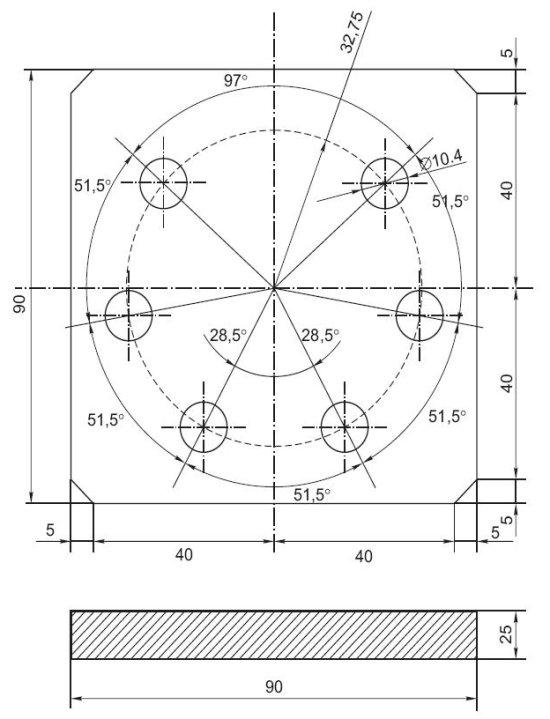

    Anyone know the the dimensions of the bolt pattern on the stub axle?

    i do, want some spacers made???
    Originally posted by Preen59
      There's some good drawings on Vortex.
      VWVortex.com - DIY: Rear axle spacers (not just wheel spacers)
      These are to suit MK3 they'll also suit MK1 there's just 2 of the holes go unused.

        Drop plates? Count me in bro!
          Thanks Peter exactly what I've been trying to find!!
          You got it jace found some nice thick plate laying around at work, pity I'm not there for another 5 days!
