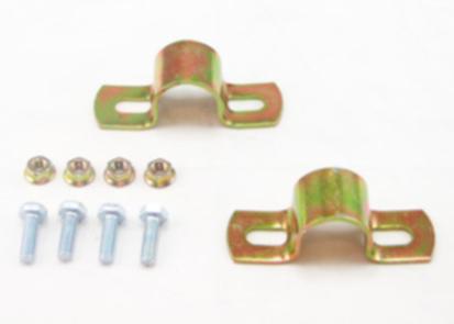

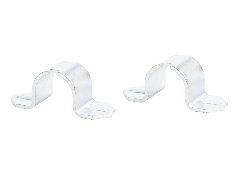

The rear bar brackets
The rusty clamp that snaps and has seized bolts which twist off as they mangle the saddle section to the point of snapping.
They've got all the bushes in urethane too.
No idea on the other bits , although they do seem to be included with their kits.

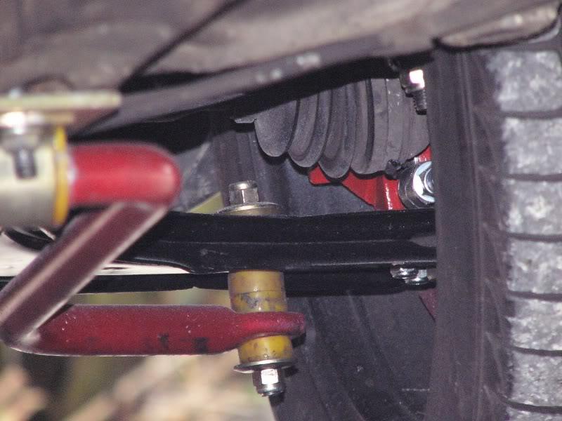

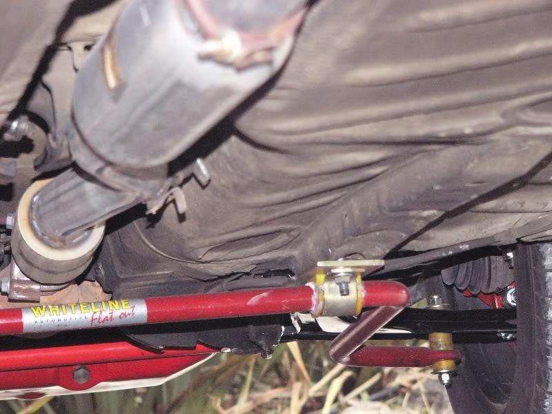

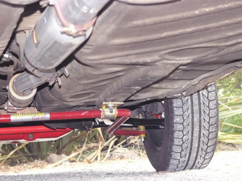

mik don't those whiteline ones require you to drill the floor of the car? Metal stamping will commence this week at the tool makers. I will be making at least 10 sets right now and prices will be cost plus a beer77 Golf tarmac rally

Yep, need to drill up through the channels in the floor and a hole in the front arms too.
I owe you some photos on how it's done Mik.79 MK1 Golf Wreck to Race / 79 MK1 Golf The Red Thread / 76 MK1 Golf Kamei Race Car

You don't owe me anything Pete, but when you get time I'd be appreciative. If it means me only drilling into the car once then I'll be stoked.Originally posted by Peter Jones View PostYep, need to drill up through the channels in the floor and a hole in the front arms too.
Whiteline mounting.
