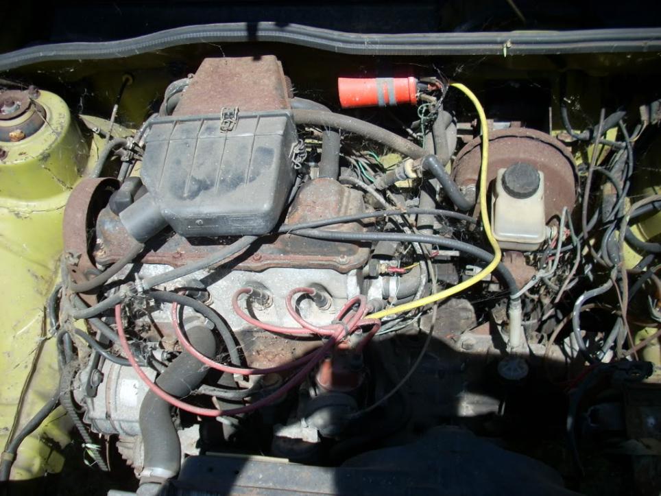

    Hey i finally have my golf in the drive looked under the bonnet she is a 5/76 how can i identify what engine i have as nothing is on the compliance plate is there a chart i can source better still is there a Vizard type book for the Golf?
    Post up a picture. If it's original it's likely to be a 1.6, FN if I'm correct.

        Cheers Guys!!! here are some pics
          It's a 1600 alright.

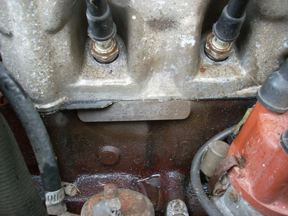

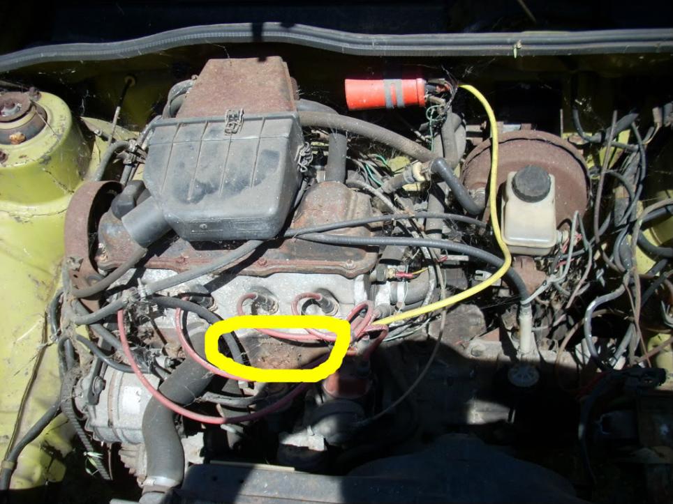

          The engine number can be found in the area I've circled in yellow below. It's on the block itself, just below the head.
          First 2 letters of the engine code will let us tell you more.

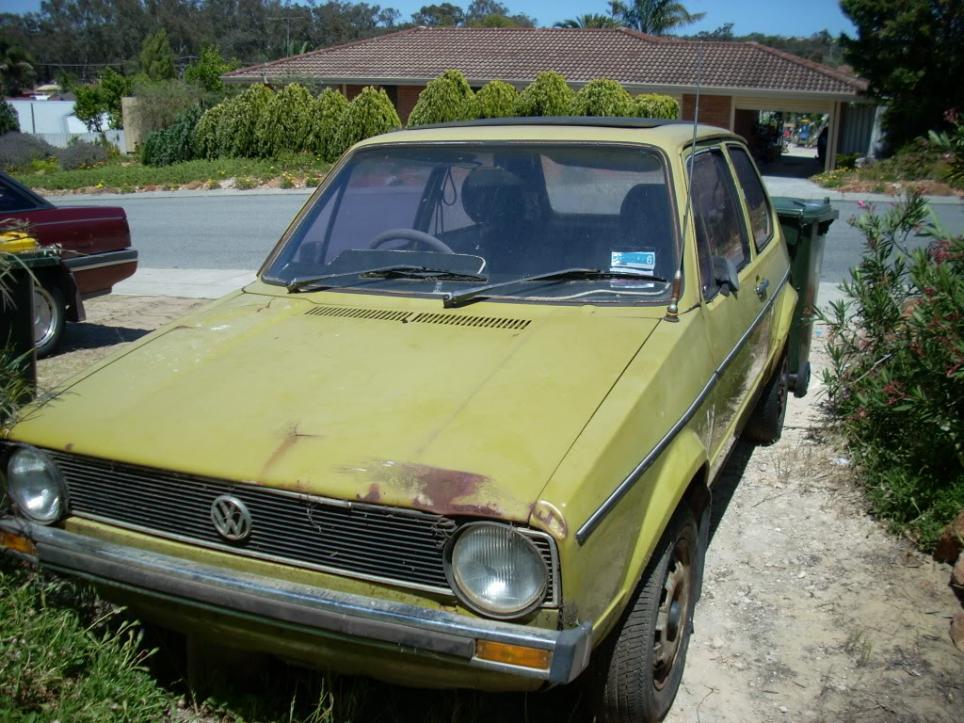

            is that a sunroof or retractable roof?
            And mustard (baby poo) yellow, nice!

              If it's the original engine it will be FP engine code. Looks like the colour is Martini Olive. It may be early enough to have a light in the glove box. My daughters car is 2/76 and it does not have the lining material on the inside of the C pillar and has the coolant overflow tank which was dropped for a while then re introduced later. Australian built swallowtail I believe. The original coil looks to have been replaced as has the oil filler cap. Cheers Geoff Hale
                It is a sunroof, buggered if i can figure out how to work it if anyone has ideas let me in on it lolz more pics tomorrow, wargamming is on the back burner and its a day on the golf

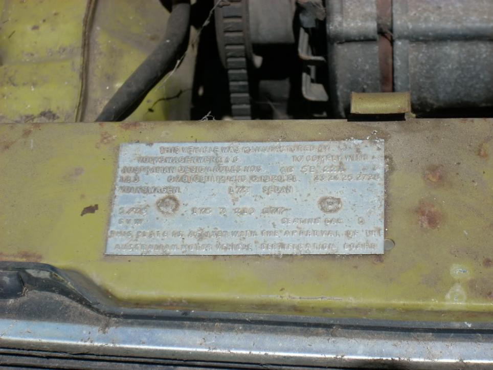

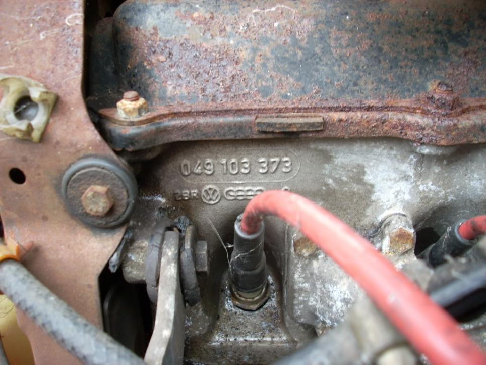

                            Yep that second pic is the engine code. So, FP it is! The top pic of the head is just the actual part number for the cylinder head (9 digits).

                            I was sayin before how this car is actually pretty unique being a swallowtail shell, with the matching early bonnet, a 3-door AND a retractable roof!! If that roof is factory then thats a pretty rare car. Make sure you do all your homework before doing anything, google google google!!!

                              in regards to the sun roof ive had a descent look and as far as i can tell im sure its factory and seems to be integral to the roof and not just "bolted on" will know better once she is stripped
