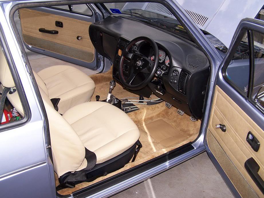

          I put one in my Mk1 - pretty easy and snug fit. Only difficulty is getting the height right

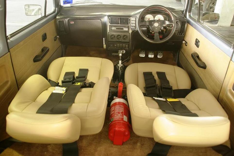

          Other option is to place the Mk1 clocks in a carbon or plastic (or whatever else you want to use) binnacle and set them in the Polo dash. I've just done similar in my brother's project
            Do you have a picture of that Valver?

                That looks like a good fit Valver.
                I have actually chopped up two dashes trying to make em fit Mk1s. The width is right, but getting it to sit low and still have a demister that works is hard.
                Also the gear shifter is very close to the console, particularly in 3rd gear.

                  Sorry Valver I meant a pic of your Brothers setup hahaha, have seen yours many times, looks great. I knida know the answser to this already but how hard was it fitting the Polo indicator stalks to Mk1? Do you have any more pics of dash swap?

                    @valver off topic but what seats are they
