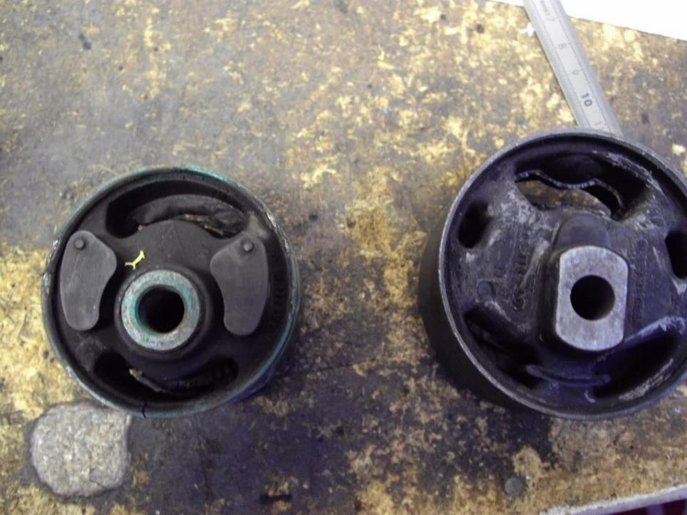

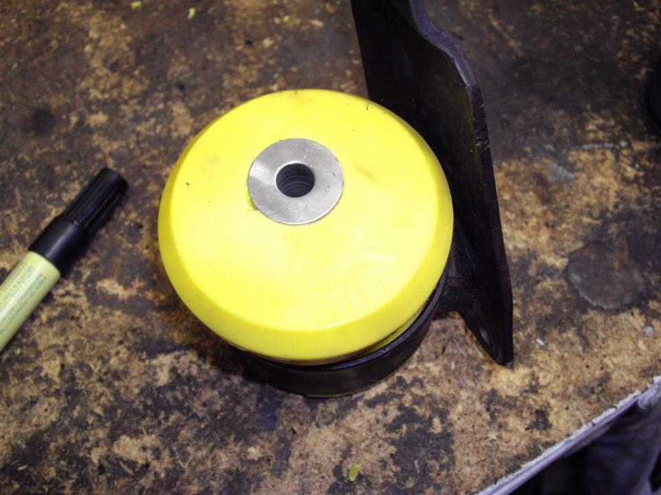

    Hi, bought some poly engine mounts for the golf.
    However, the drivers side engine mount/bush that I bought is larger than the passanger side mount.
    I think in a diesel, the drivers side diesel engine mounting is larger than the passenger side mounting (the actual bracket).
    Could anyone confirm this - whether the drivers side mounting bracket is larger than the passenger side in a diesel MK1 - if this is the case I just need to get a bracket instead of returning the item.
    Hope this makes sense.
    Cheers.
    Certainly is, but a diesel mount isn't the one you want.
    You'll need the big mount bracket (74.6mm) off a late model MK1, like a cabby or campaign model.
    Otherwise just get another passenger side one, it should be the same size (64.4mm)

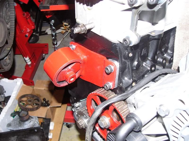

      This is the larger mount but note that it doesn't have mounting points for the alternator.

        ahk, interesting. i will measure up the larger mount tomorrow.
        where did you source the larger bracket from? ... i would prefer to run larger mount and bracket if possible.
          hmm the easiest solution was staring me in the face. i exchanged the larger mount, for another passenger side one. thanks peter lol.

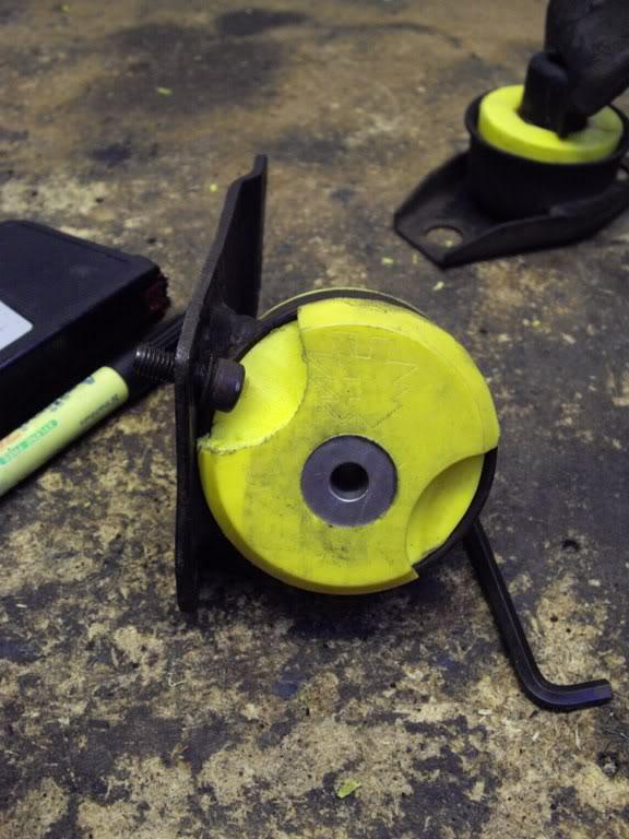

              Here's some info from a good mate of mine..
              Well I got around to fitting up the mounts today.
              Thought it would be fairly straight forward! No such luck!

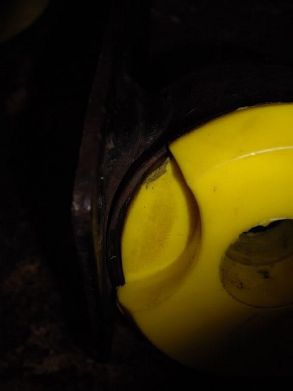

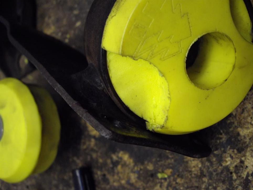

              Noticed that the RH mount is cast upside down!!!! The offset locating hole of suppose to be offset to the bottom.
              But BFI cast it upside down with the offset up the top & with the cut out for the engine mount bolt.
              VW have there offset's located down the bottom. You can see the arrow's which way is up
              BFI cutout
              Engine mount offset is upside down!!!!
              Out with the die grinder & a square headed burr bit.
              The right way around!!

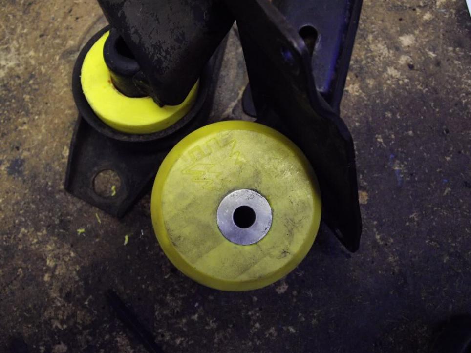

              Anyway, I did get a chance to try them out. Now I'm sure that the mount kit by itself is ok & would make it only slightly more rougher & restricting the engine/gearbox from moving.
              But with the rock hard VW Motorsport mount, its basically like solid mounting the engine/gearbox very rough!!!! The engine/gearbox doesn't move one bit
              Then later...
              Well after a bit over a week of running with the BFI stage 1 engine mounts & doing nearly 600km with them. The car has nearly shaken itself to bits!
              I can safely say they are "definitely not" for the daily driver!
              But will keep them for another project somewhere down the line, cause they improve the gearshift quality heaps & also help put power to the ground.
              Will probably just fit the VW motorsport rear mount whenever I race it.
              Have since fitted a new set of genuine VW diesel mounts & the car is back to being nice, smooth & quiet.
              Now just have to fix all the rattles the other mounts have created!!!!
