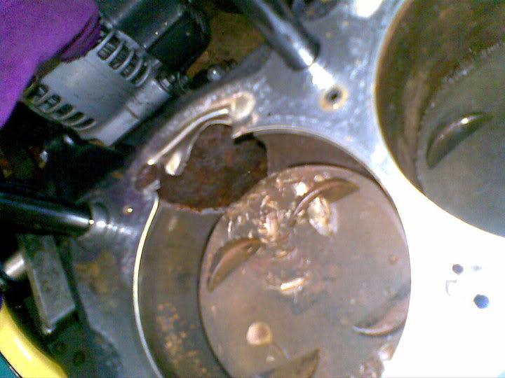

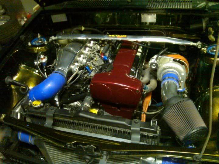

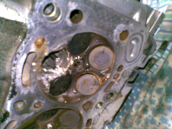

          this is what daims engine was like pre tas drift round 2....
          post...
          piston = BITE crunch crunch... ... entire valve sitting in intake plenum.... :O

            Pretty much what happened to my VR6 haha.
              fark that looks nasty, looks as though in that first post-drift pic some work has been done previously around the damaged area.
