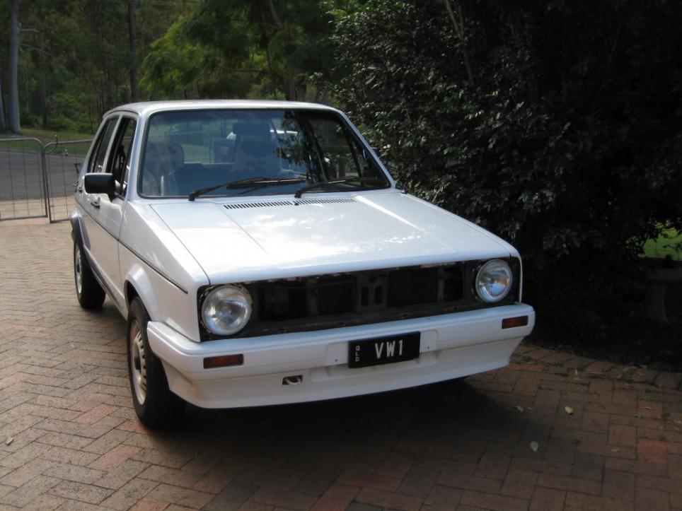

    Hi Guys
    Looking for some ideas for this...want to upgrade brakes, suspension and engine
    Current line of thinking would be brakes and suspension first, followed by a 2.0 8v swap, however should i go for something further either 2.0 16v or ???...dont want to go crazy on the spending but want to be happy with the cars all round ability...
    cheers for your input
    dude, it may be my inexperience... but i have never seen one of these.. ever.. heard but not seen! good work!
    2012 Ford Focus - Panther Black
    Previous - 1977 VW Golf GLS - 2E (beige beast)
    Previous - 1976 VW Golf Ls (flipper blue)
      Citi respect!
      MY10 S3 3dr
        Nice work dude, keep it original as possible they are rare around here
          What year is it?
          Shotgun the airbox when you do an engine swap!
          Looks pretty tidy.

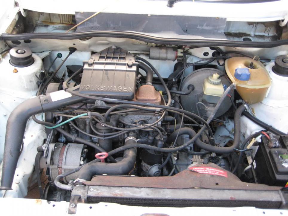

            Mechanicals is where i want to do most of the work, just have to decide about the engine - 2.0L 8valve seems like the easiest option, maybe with a bit of work for some more bhp...surely a bit quicker than the current 1.3L!
              you sure it's a 1,3???
              it doesn't look like a small block, and the water outlet on the head between 3&4 cyl's indicated (to me atleast) that it's a 1.8.
              Air box looks similar to what was on my old import mk 2.
              as for upgrades. I'd put mk 1/2GTI brakes on the front, with a new/bigger MC and booster from a mk 3. These will bring the brakes into the 21st century! Combine that with a nice cup kit, and some nice wheels, i reckon i'ts a go-er.
                I think its a 1.3L or 1.5L, either way it isn't a 1.8L...it goes ok, runs out of puff early than my '76 1.6L
                Thanks for your brake upgrade suggestions...will go that route first, followed by the suspension & rims...

                        Its a 1.6, late model.
                        THe small block, 1L, 1.1,1.3 , 1.4 look different, they are a crossflow engine and sit on different mounts.
                        That is probably a tired 1.6L.
                        For performance on a budget, put a 2L bottom end under that head, with a cam if you like and the carby that you have and hold on.
                        It will up the compression and will go great.
                        The head is hydraulic and has the late style second oil return and so will fit straight onto a 2L bottom end, or 1.8.
                        Thats probably the best motor to drive in a Mk1 and one of the cheapest swops going.
