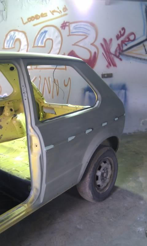

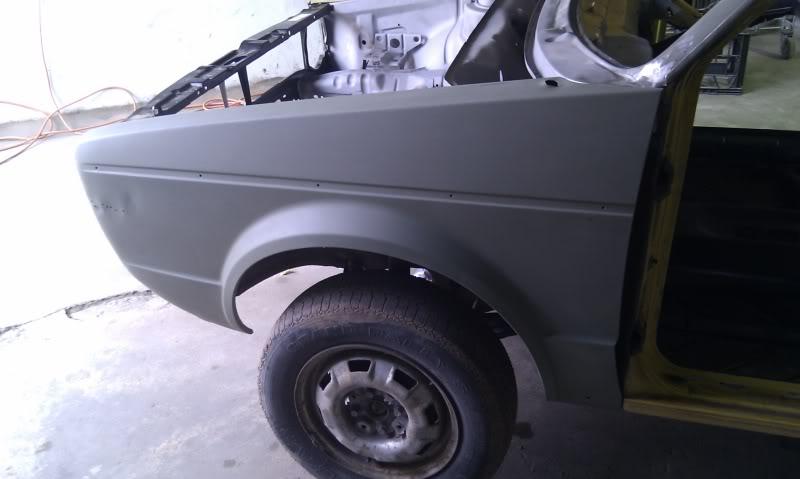

        • Okkkk - i kind of ended up losing track of time yesterday...

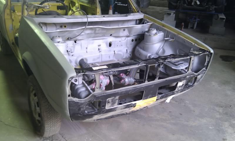

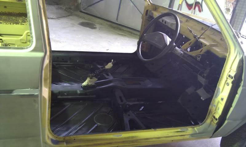

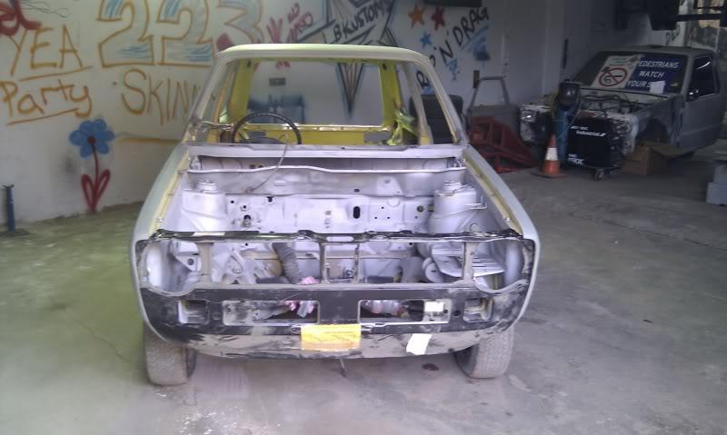

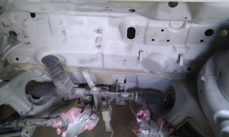

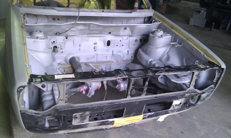

          Here are the pics. Very impressed with the result.
          My Bodyworks had already painted over the floor where the sound deadener was removed but it looked brand new.
          He wasn't 100% sure what they used, but the sand was pink if that helps at all.
          I was very surprised at how gentle it was on the car
          The fenders/front apron aren't properly attached yet, he just sat them there to show me how it was coming along.
