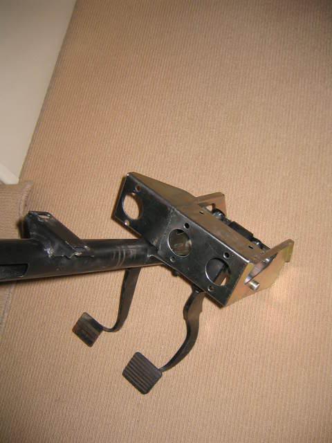

            i sourced a cabin side mounted pedal box from the uk and its a great bit of kit
                Details please?? (for next time)
                Mine cost about 300 quid with dash mounted adjuster and remote reservoirs.

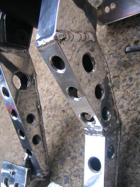

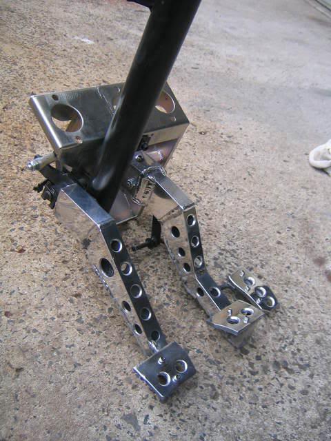

                    from my man mickey marrows on the edition 38 forum its a great fit, i think mine was around that price but without cylinders, it is part of the steering column and mounts directly to the firewall bulkhead. i had to source a blank steering column in the uk to sort out the build
                    without the mods
                    and with my custom pedals
                          without the mods
                          Sorry, I'm a little confused - the peddle box is part of the steering column,
                          but you had to buy the steering column separately?
                          Isn't it possible to start with a standard steering column?
                          (grind off all the bits you don't need)
                          I guess the tricky pedals are something you did? I.e. you don't get those for your 300 (ish) quid...
                            Wow! They look great!!! I guess this also give you a hydro clutch - neat.
