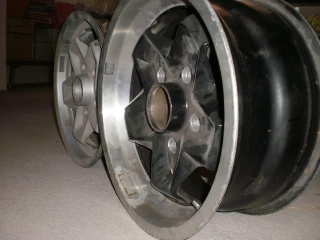

    Backspacing is 120mm ,looks like you can get adapters from 20 to 35mm will this work or should i just forget about it ??????
    These are the rims i have 15x6 and 15x7 cookies
      Dope what's the offset? It should be stamped in there somewhere. I'm not so familiar with backspacing figures!

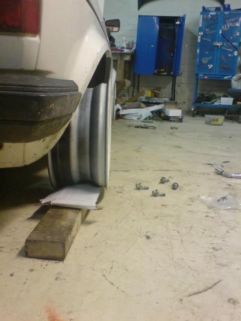

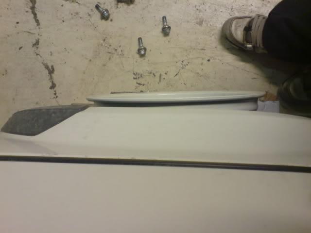

        anyone else have any pics of cookies on mach 1's ?
          sweet looks like they fit anyways ,ive just measured from the inner face where it meets the hub to the inside of the rim there is not ET measurement im not sure how to convert it?
