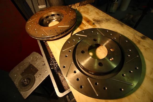

                • put the finishing touches on some zimmermann 280 discs, had the slots cut a while back
                  and have i mentioned i hate body work, but its getting there, have guide coated and flatten half the car and am very happy with the results.

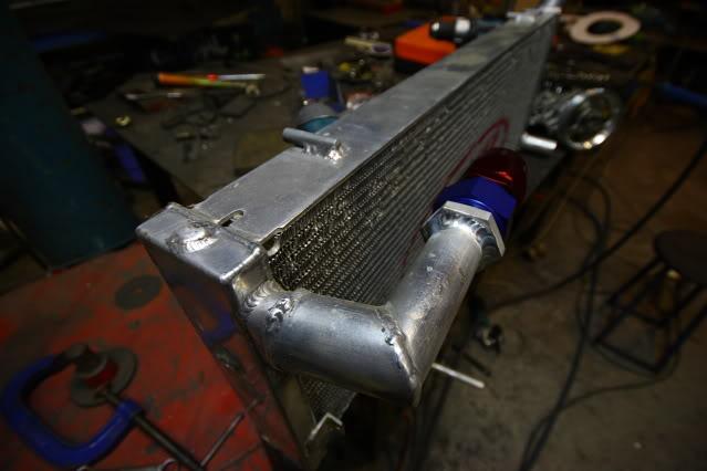

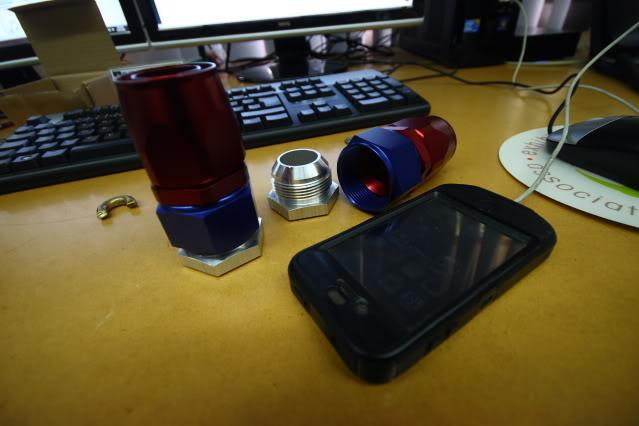

                    • now i have put heaps of alloy fittings into this car but the latest for the cooling system are pure sex, im week at the knees
                      20an goodness
                      and yes thats a real iphone 4

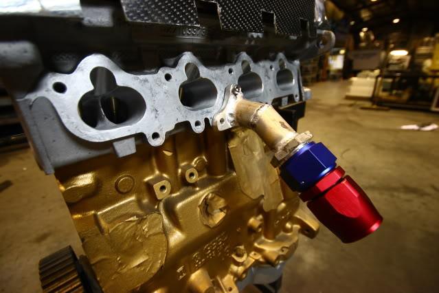

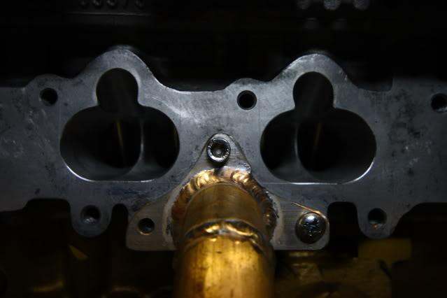

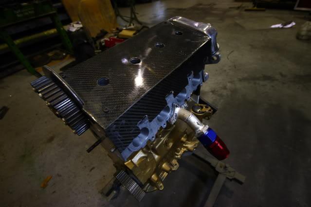

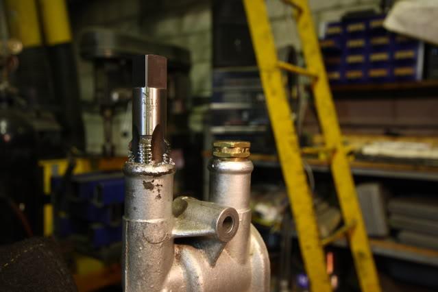

                            • motor side
                              1/2"bsp is the perfect size to tap the water pump for bungs, as ive gone to single outlet of the front of the head and am capping the side hardline

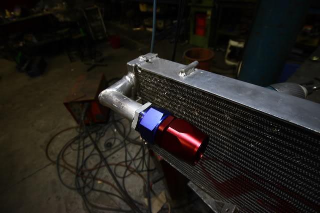

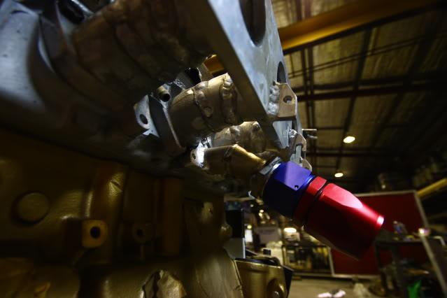

                              radiator side
